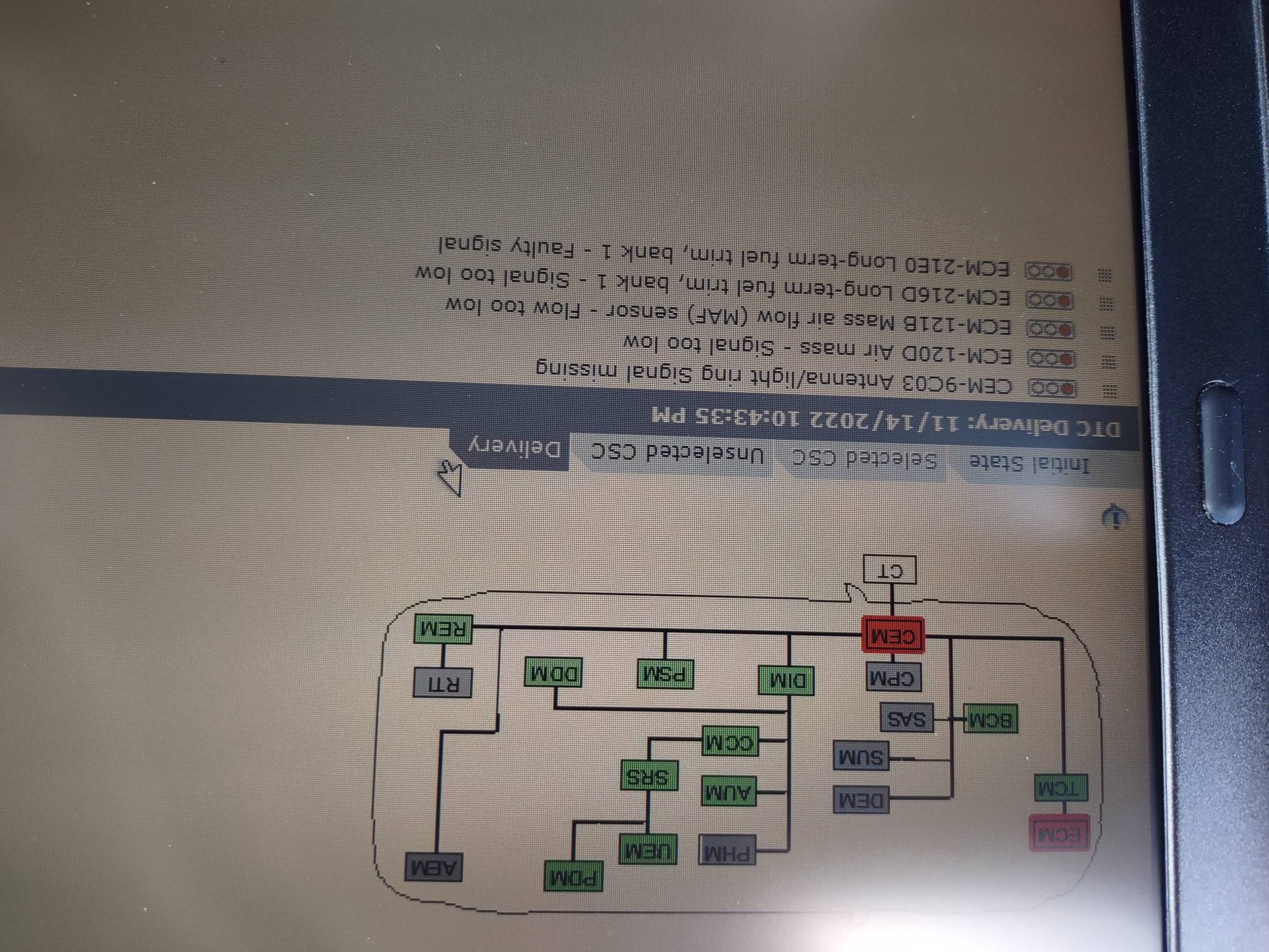

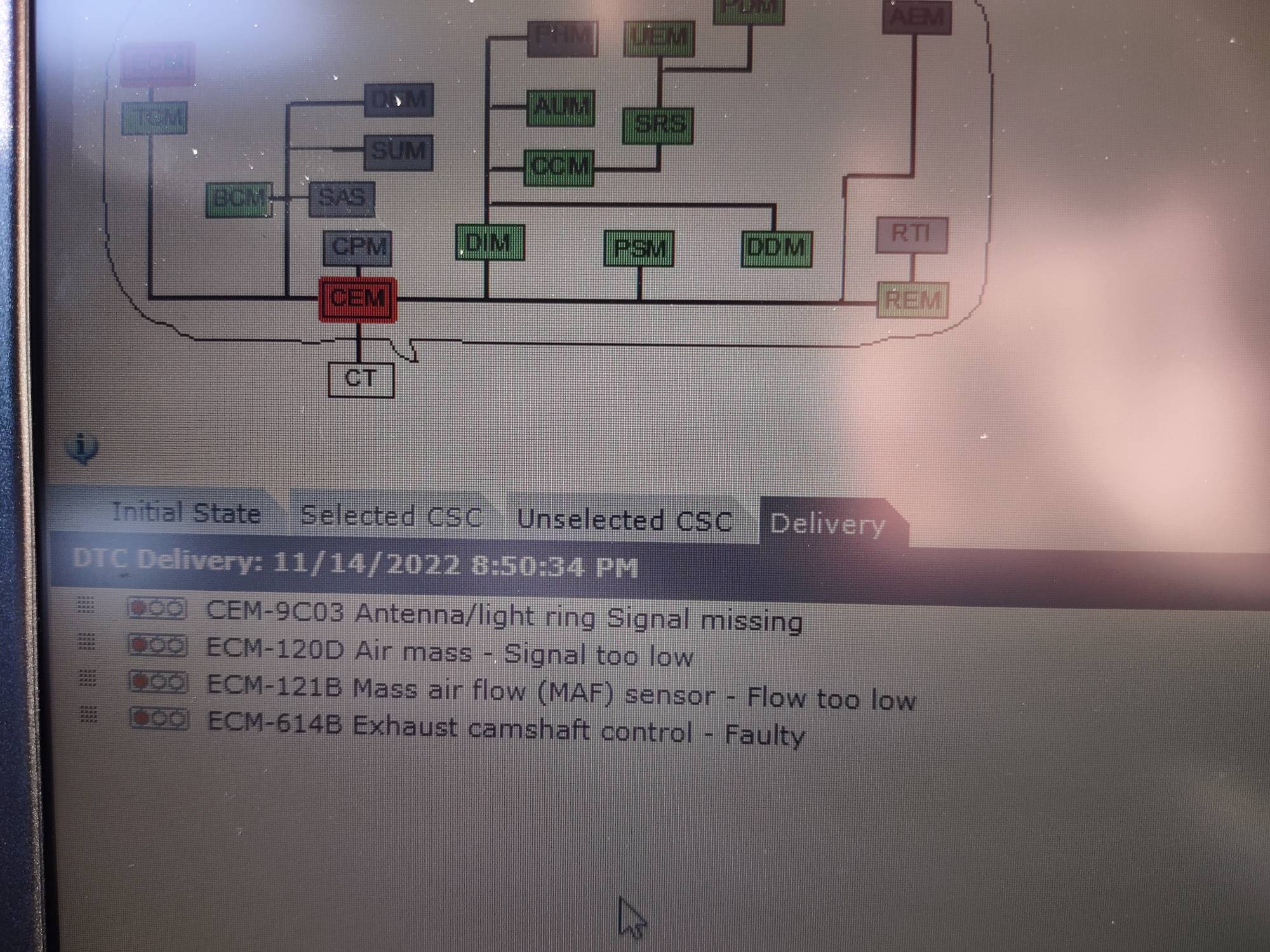

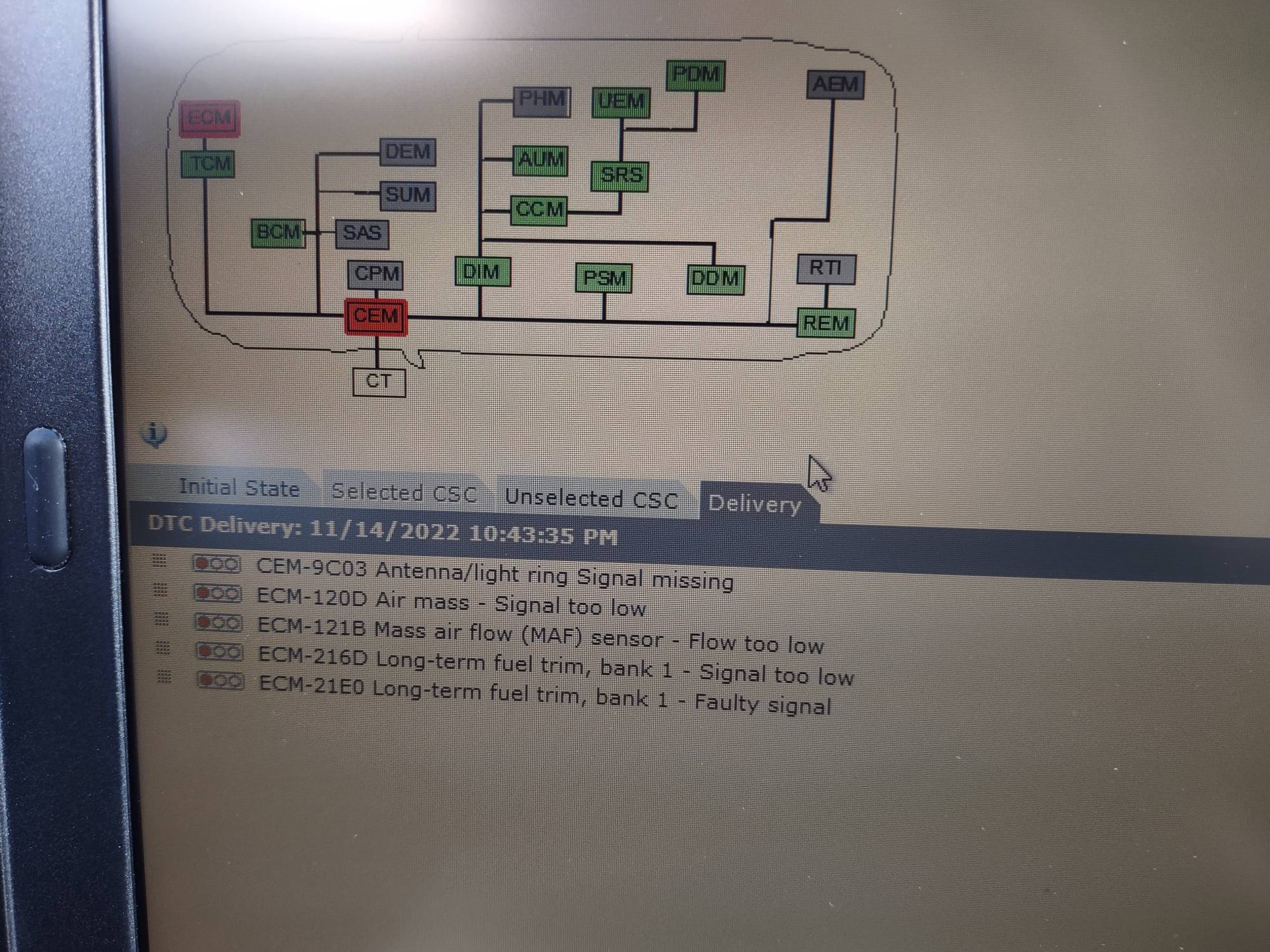

Hey all.. I have a 2006 V70 2.5 turbo. It was running great until the weather turned cold. Now it will barely idle. Has anyone seen these codes and point me in a good direction?.. ps .. I don't know why the pics are upside down.. I tried rotating the pictures on my end.. no go

the word popping up very often in those codes is "air."
Some sort of intake or vac leak.
retrace back over the most recent work done.

Well boys and girls.. turns out it was a a bad evap purge solenoid.. MDK
