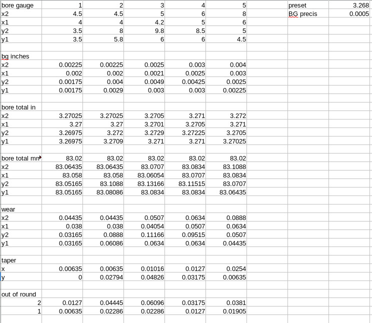

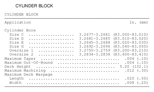

Yeah. This is what Volvo permits:
This is what engine from the donor car w/ 220k miles on the odo had (I was swapping out crashed chassis and took its working engine apart out of interest):
Out of round 2 is near the top of the bore, 1 is around the center.
