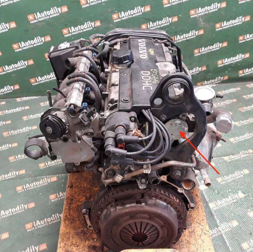

I would also check the camshaft sensor.
Camshaft sensor .jpg (118.9 KiB) Viewed 813 times
