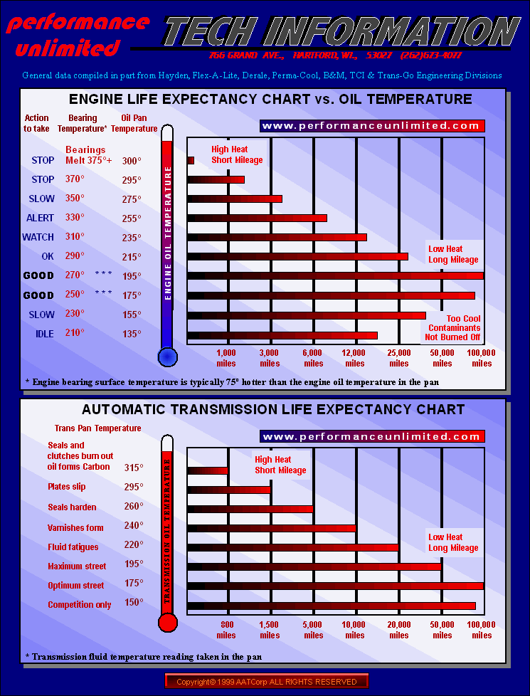

Mileage Expectancy vs Temp.
http://spece30.com/uploads/default/orig ... 43c03e.png
Temp Chart.png (61.4 KiB) Viewed 450 times
