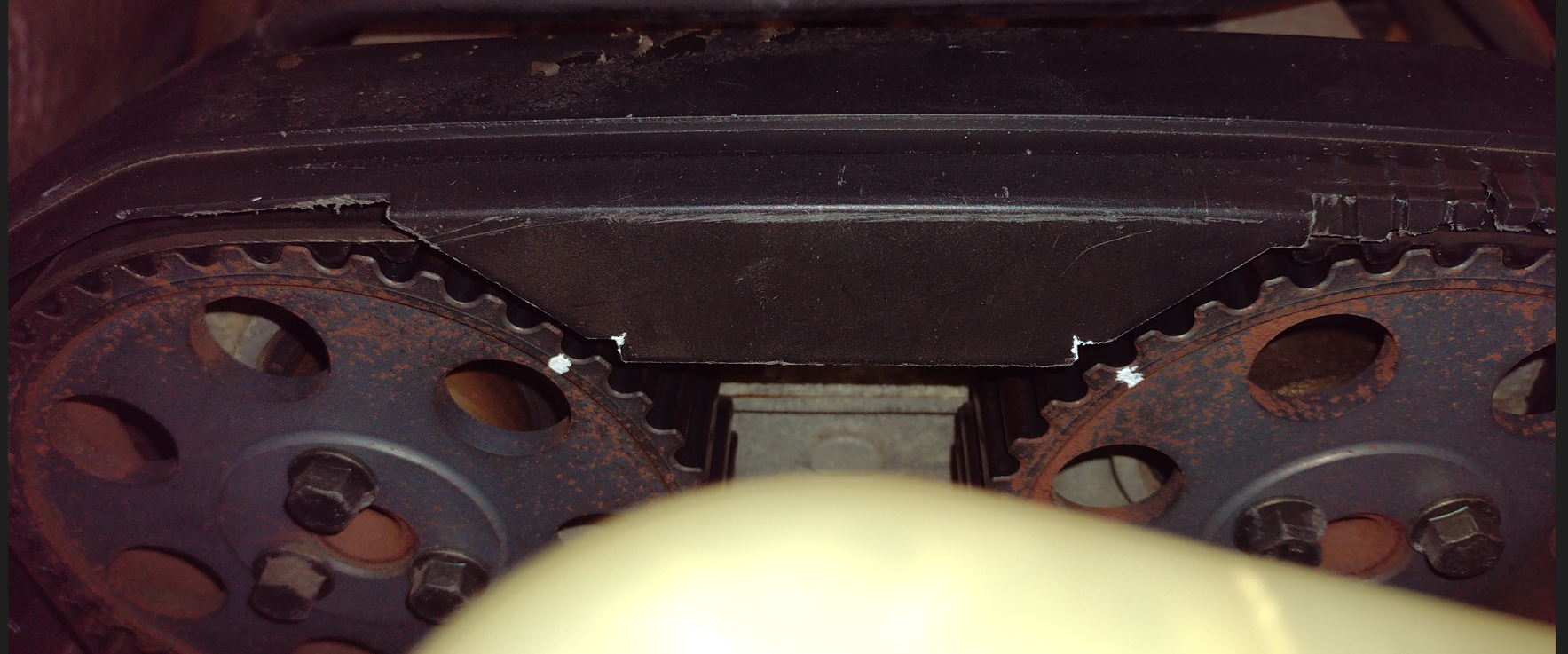

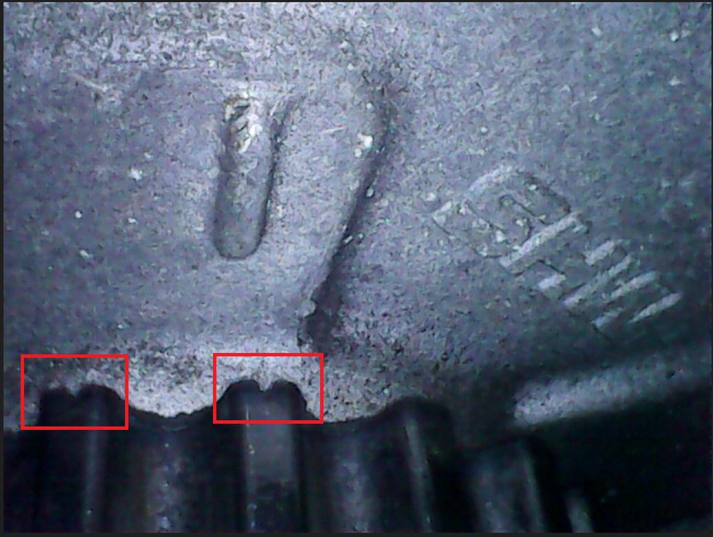

I tried to remove the bottom timing belt bracket - 2x bolts 10mm. Managed to remove only one. It had red thread lock on it. Why would these bolts have a red thread lock? The second bolt would not budge. If anything, blue thread lock should be sufficient on it. Hopefully I won't need to remove this shield in the future... I used my endoscope camera to inspect the space, as far as I can tell, nothing in there. The bracket looks solid. The only thing I did was to spray a bit of WD40 on the bracket to help with bolts. I don't see how that could make a difference... Timing belt is clean, I made some picks of timing belt marks. I guess they look ok.

Not sure if this looks off, or good enough, or maybe I needed to move the crankshaft a bit more?

This is the top line up corresponding with the crankshaft on the other picture.
Is that acceptable?
​​​​​​​Thanks
Posts: 36142
Joined: 17 Feb 2013, 17:54
Has thanked: 1609 times
Been thanked: 4065 times
Especially if you bumped the 1/4 tooth you are off on the crank, you would pick up the 1/2 tooth you are off up top
It’s fine, run it,

yep, these 2 notched teeth on the crankshaft are kind of on the edge. I would say that this marking system could be definitely improved, unless it has some tolerance built in to it... I will take a car for the spin today and will see what happens. If I will end up taking off the TB, I will get rid off current one by Gates. It's acting weird from the beginning. It is hanging on the edge of sprockets and travels sideways slightly. Unfortunately instead of doing TB job myself I outsourced it to the local shop in Atlanta and of course their policy is: You use our parts or else...
