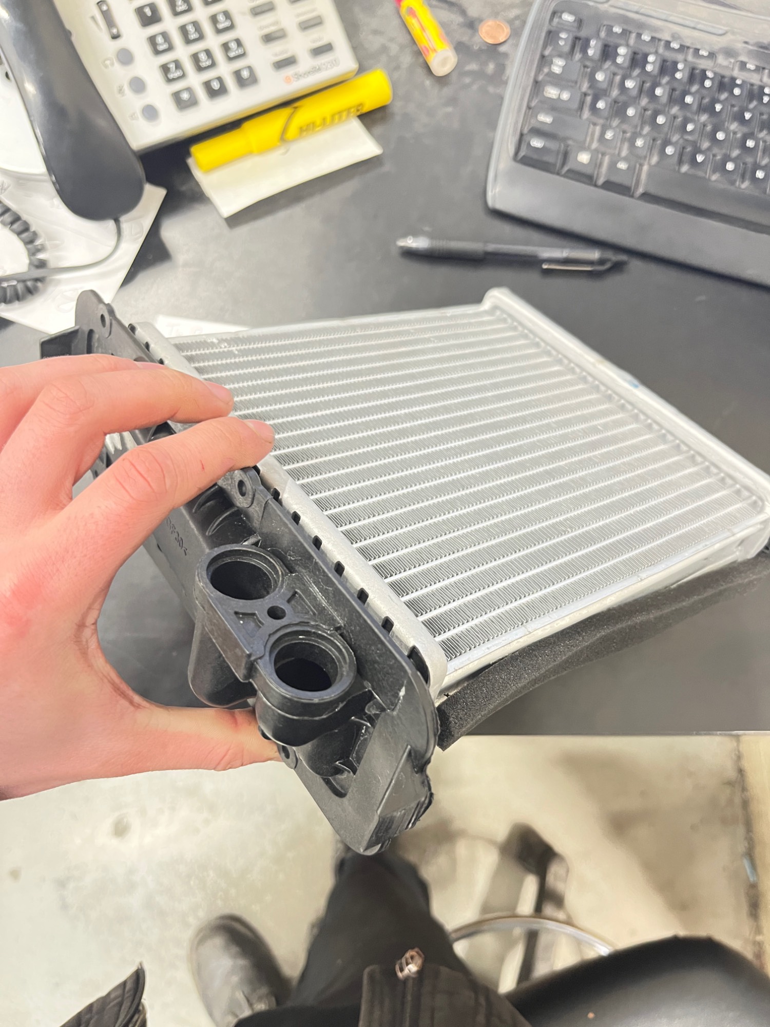

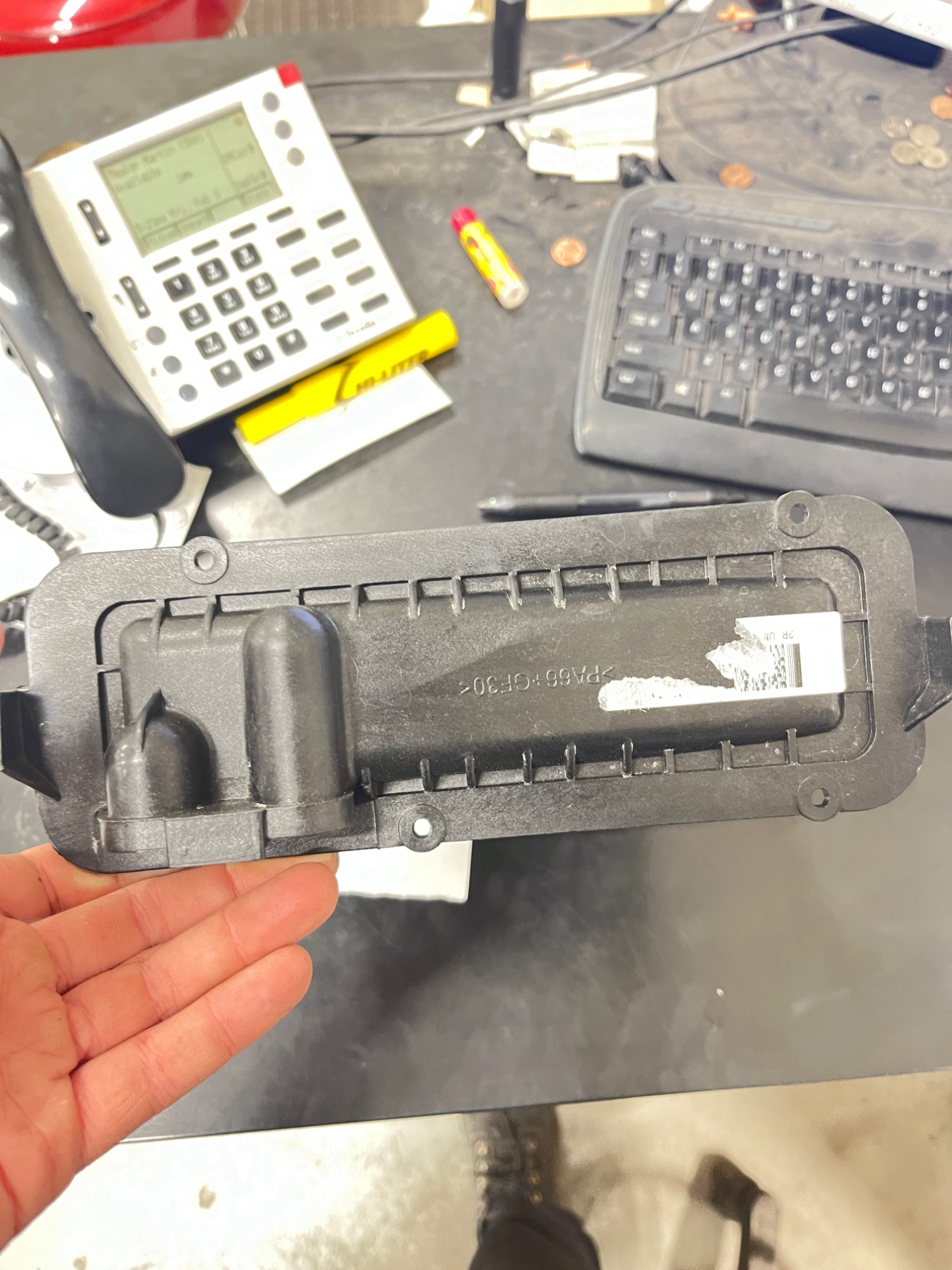

If you want to verify that you have the correct core, post up a pic if you can.
It would suck to get into it and find you have the wrong piece, and then the car all torn apart.

A plethora of photos:

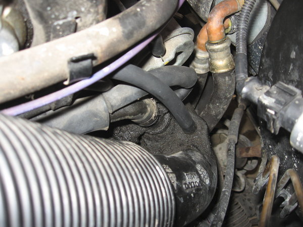

Here is my old Post to changing the heater core. May I suggest just unplugging the 2 hose ends in the engine compartment by a radiator hose loop on both fittings and bypass all together for the trip. I didn't go over the old post but I believe mine was leaking in 2 places.
The photo is from jblackburn. Again, basically a hose loop and clamps to bypass the heater core. As for your last question about drip and odor? Good question but not sure as yours maybe so diluted and going into the carpeting rather than fogging the windshield or like mine leaking at 2 places, with the worst in the engine bay?
