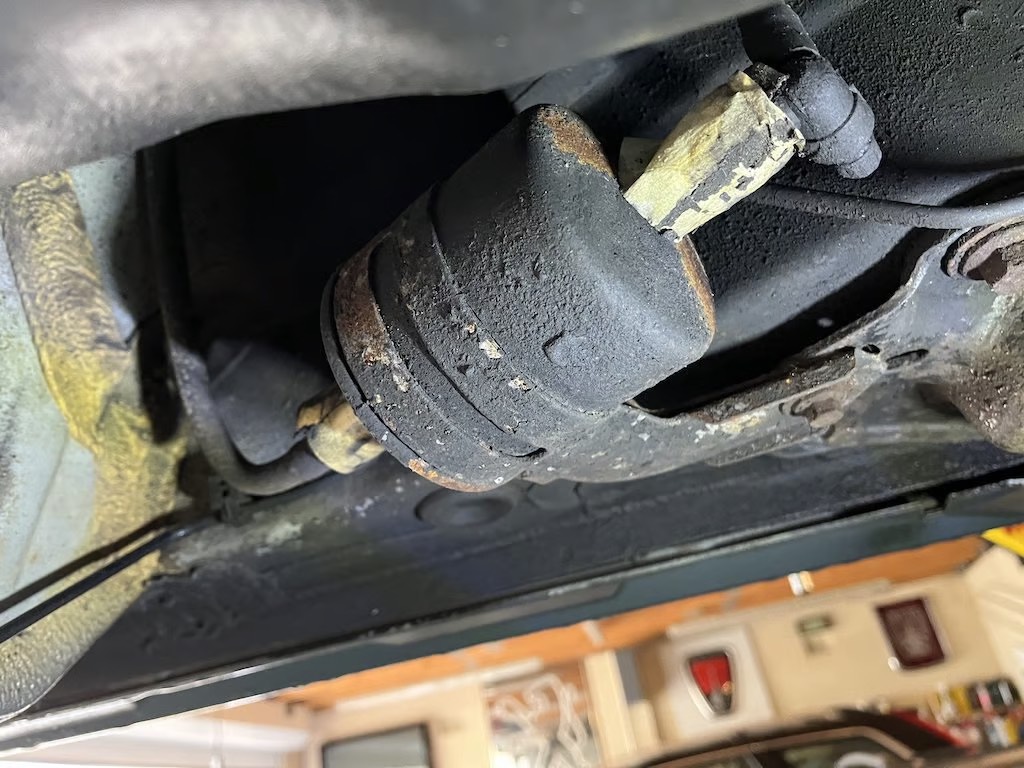

Driver side (UK car) in front of rear wheel
Fuel Filter.jpg (253.14 KiB) Viewed 1421 times
