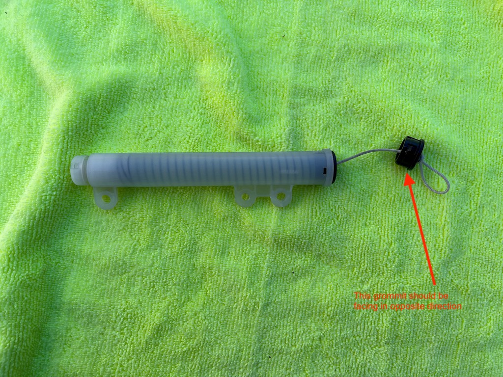

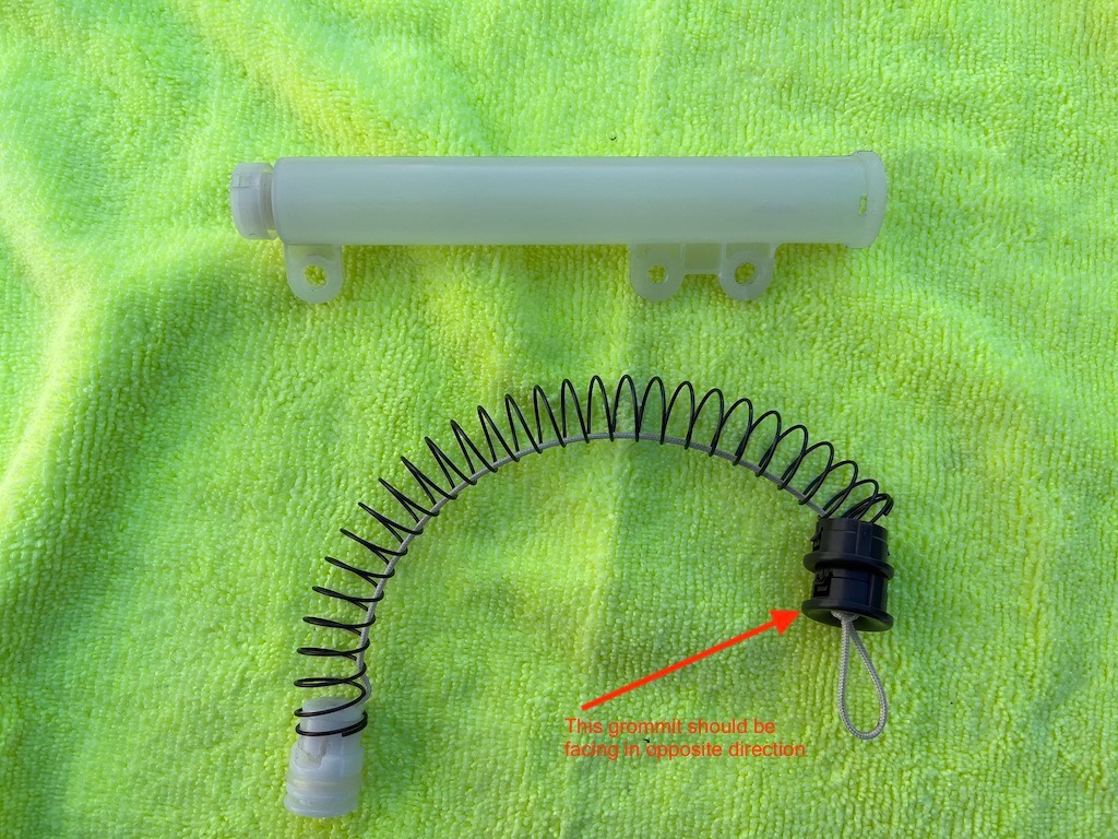

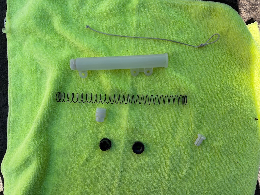

Today when in the glovebox I noticed a broken cord at the rear and after a bit of investigation I discovered it was for the soft open mechanism.
I stripped the glove box out and try as I might there was no way I was going to get a secure fixing for the cord with the brass ferrule so decided to restring the entire mechanism
It's not the easiest of items to dismantle, the bottom part of the plunger is tricky to separate and requires gentle persuasion. It took me several attempts with the length of the cord before I found something close to what it should be. I settled for 195mm between the knot and top of the loop All back together and ready to refit. Note the end grommit should be on in the opposite direction Grommit is inserted from behind Now working as it should

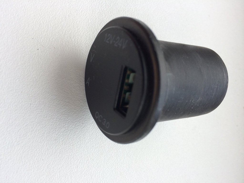

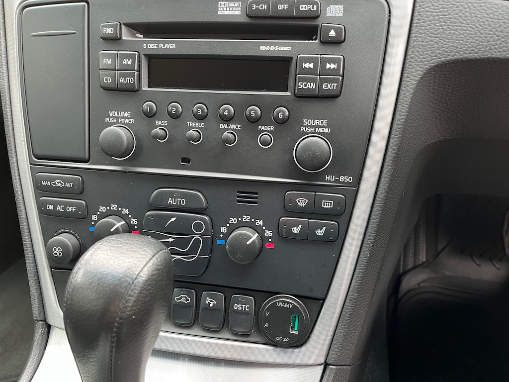

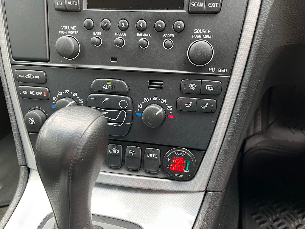

I decided my task today would be to fit my USB socket/voltage gauge into the space for the 12v socket of the CCM. I had previously fitted this to the XC90 and removed it before selling as it’s always handy to know the state of the battery and charging, plus USB is more convenient that a 12v socket.
I bought this from Amazon about 5 years ago and discovered the diameter was too large to fit into the hole when the 12v socket was removed. I put it in my lathe and removed the threads plus a little more until it was a good tight fit. Today was supposed to be an quick easy job that took way longer than it should as I decided whilst the CCM was out I may as well remove the cup holder and de-gunk whatever had been spilled in there causing it not to open.
