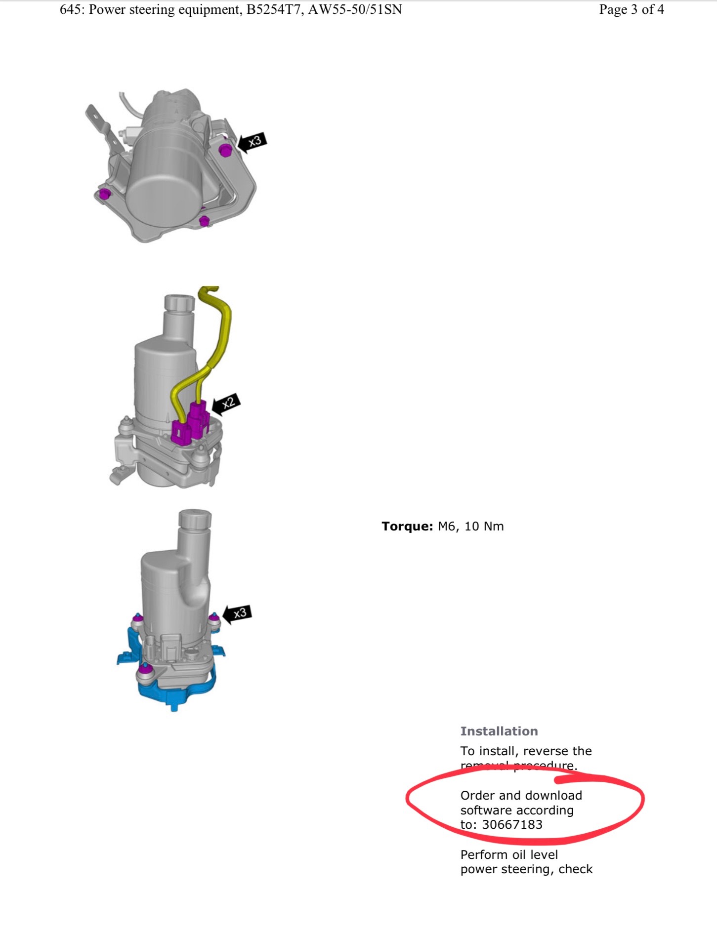

Second question. While researching a replacement pump, I notice Vida says to “Order and download software according to: 30667183”. Is that necessary?

Apparently new software is required, so it may be worth just changing out the bearings, if that’s the issue.
