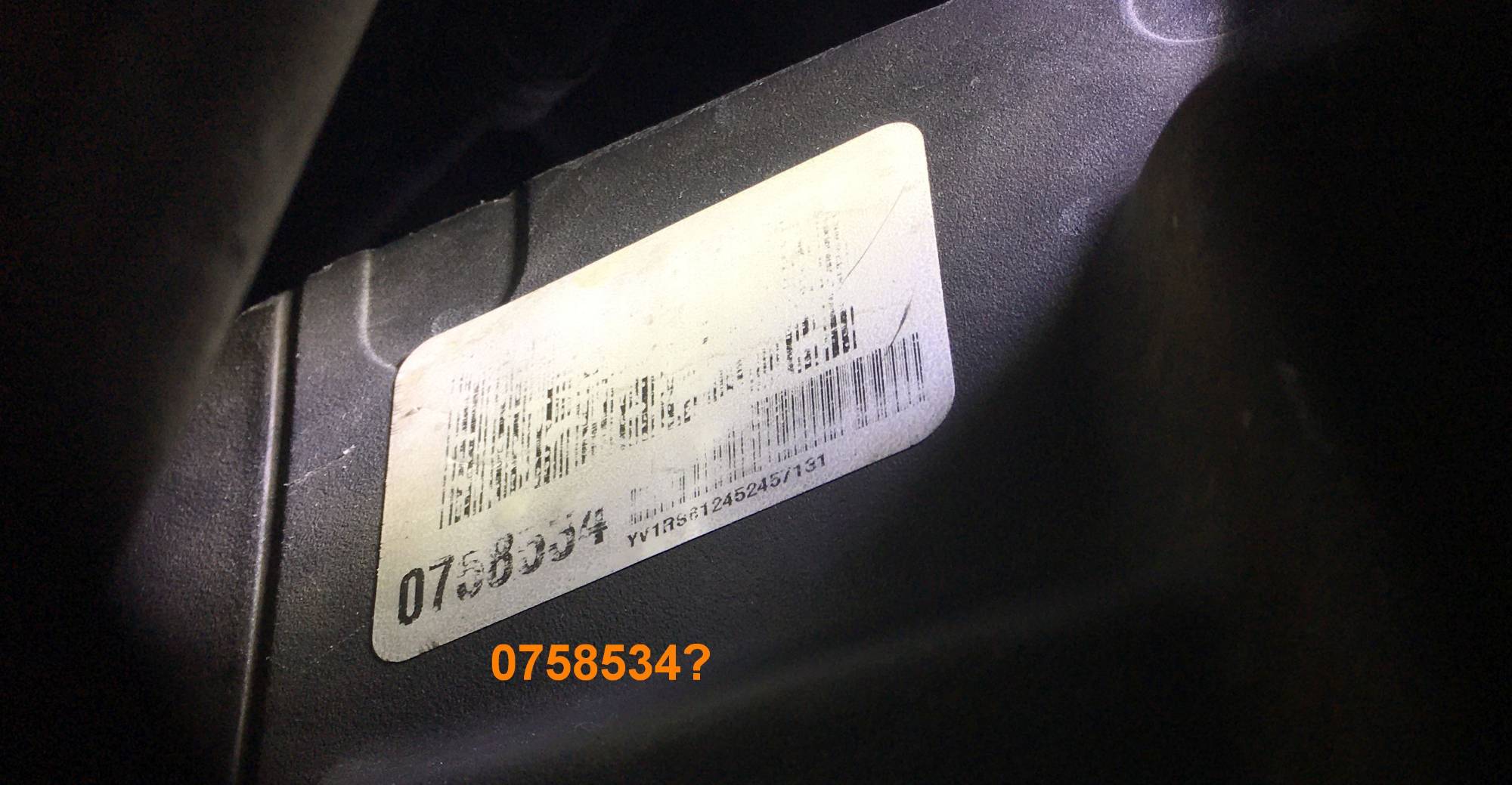

Don't use the VIN number, it's the engine serial number that matters. The engine number is on a sticker on the timing belt cover ......

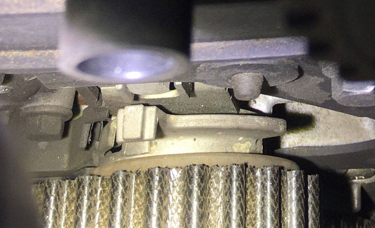

So I got a picture of the faded timing cover sticker and (I think) a view of the "dogleg" later pulley. The engine number best as I read it is 0758534 so would you agree that this is the later tensioner?

From the photo the tensioner looks like the later style one, the sticker number doesn't confirm serial number split to me(below the tensioner version split), can you find the engine serial number stamped on the engine block?

I may take another look tomorrow if I can learn where to look; can't find my inspection mirror. It looks to me like the right-angle legs of the later tensioner are on opposite sides of a bolt head. There is a second large sticker toward the top center of the timing cover but mine's totally white.

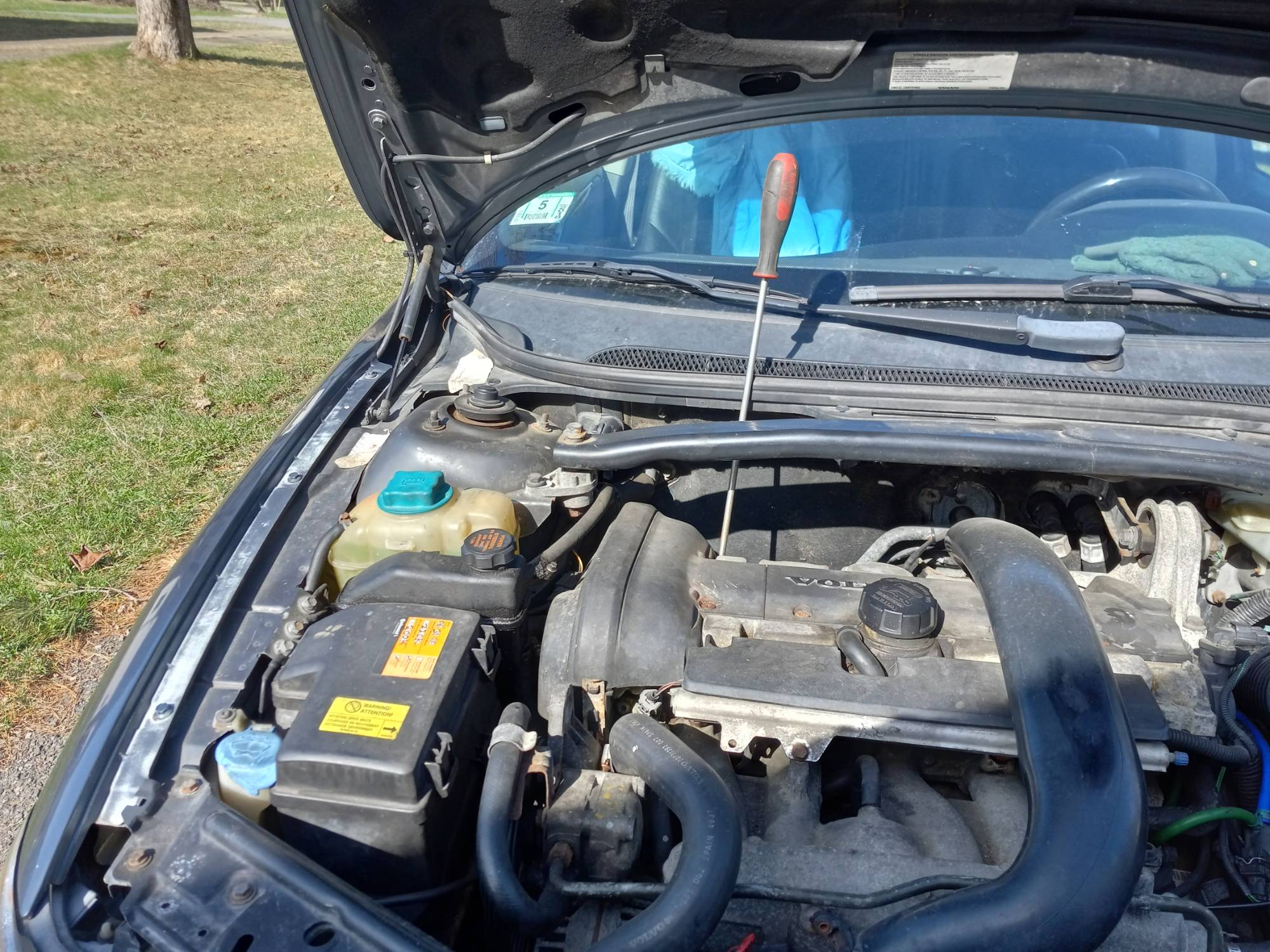

The engine number is stamped on the block on the RIGHT side of the engine, perspective from drivers seat, not standing in front of the car.
went through this 2 years ago, I could only see half the number, stuck my phone in there and took some pics, went back with a toothbrush and brake cleaner to clean it up and got better pics, the stamping is dot matrix style , like a 1980's computer printer.
Follow the long screwdriver for approx location, I couldn't photo it due to sun glare , a garage out of direct sun and a drop light would help.
