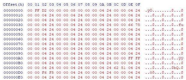

The beginning looks good, but later something goes wrong, maybe power issue?
Copy the bytes into HXD and save as bin to get your file...

T5Luke wrote: 29 Apr 2023, 03:03 The beginning looks good, but later something goes wrong, maybe power issue?
ok thank you have been away now i have returned
i have re soldered power connection currently taking read now appears more complete

how is this? i stil cant make work with cem tool :cry:
vehicle is xc90 maybe parameters are different?

HXD uses left and right window, you need to paste the data into the left window for binary data, you pasted it into the right for ascii data...
From what i see the file looks good

T5Luke wrote: 29 Apr 2023, 14:17 HXD uses left and right window, you need to paste the data into the left window for binary data, you pasted it into the right for ascii data...
🤔 i dont know what why it done that was sure i just pasted it over the the binary window.

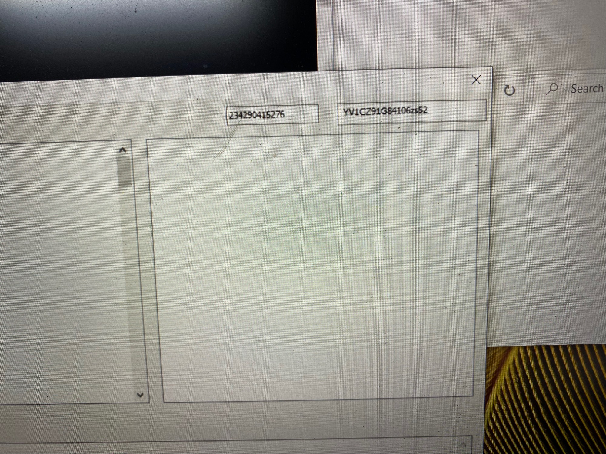

can you see pin in this data ok?

Your code should be: 23 42 90 61 52 76
Not the best read, some errors still but should work for this purpose...
Maybe to long wires or something...
You should just copy paste the binary data like this, you saved the txt file

thanks luke its a thing of beauty
