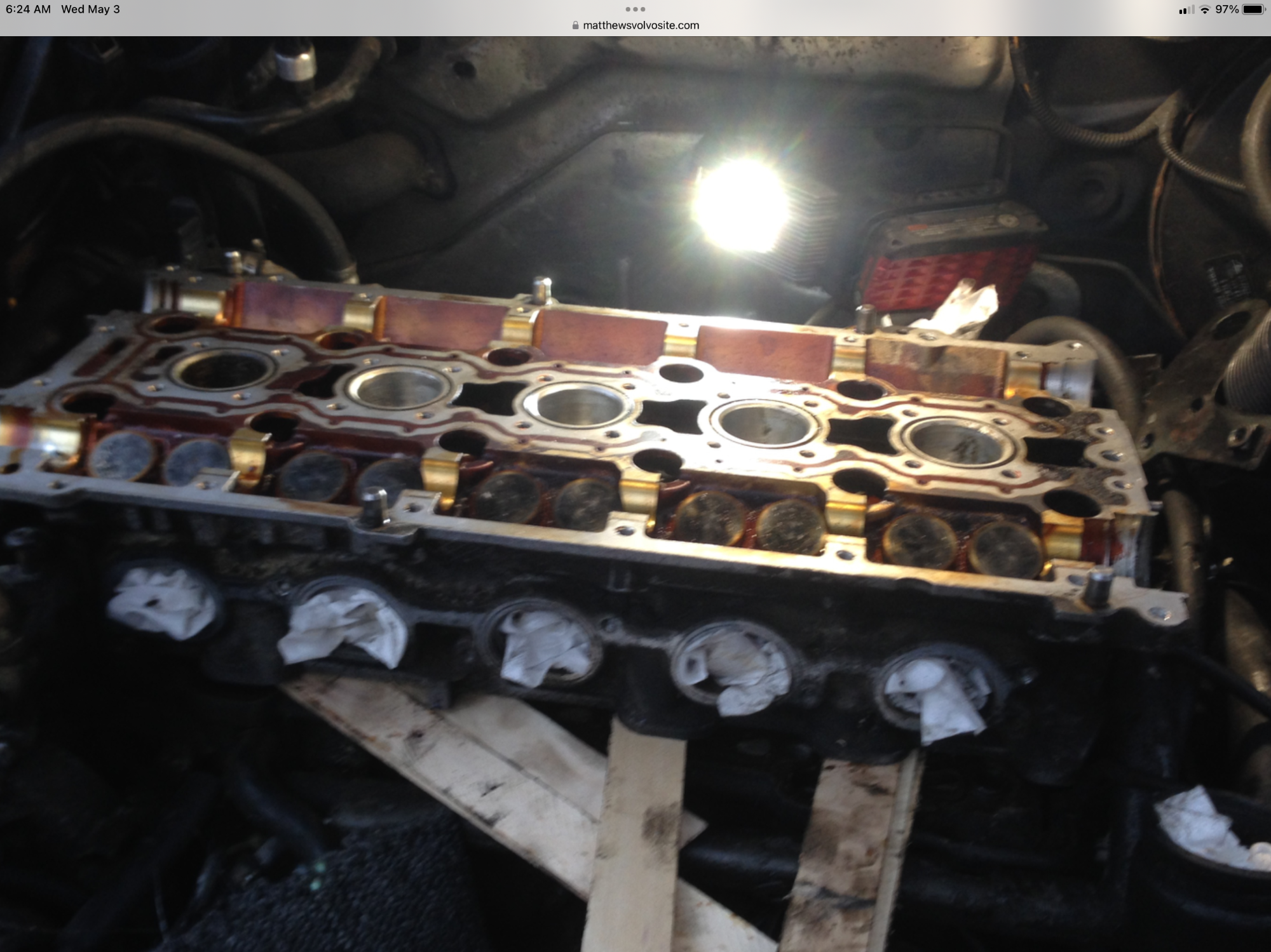

ZionXIX wrote: 01 May 2023, 18:50 9Finally got the head pulled today on the xc90. I have a couple of questions since this is my 1st time pulling a head. Is it normal for each cam cover bay to be darker and more "cooked" looking from cylinder 1 to cylinder 5? When I pulled the head there were 2 sleeves sticking out of the cylinder block but there appear to be spaces for 4. Am I missing 2 sleeves? There are none in the cylinder head. It looks like 3 valves struck pistons for sure. It was pretty small though.
That #5 is badly coked up, I’m guessing from stem seals. Did it puff smoke on hard acceleration after a hill drop?
I’m not sure what sleeves you are referring to, hopefully not the cylinder sleeves

ZionXIX wrote: 01 May 2023, 18:50 Is it normal for each cam cover bay to be darker and more "cooked" looking from cylinder 1 to cylinder 5?
I had a bit of this, not as dark, on my P2. It appears related to the distance from the oil pressure source at the end of the engine.

abscate wrote: 02 May 2023, 02:42
I guess the more accurate term is a dowel? It aligns the head and block together, sticks out a few millimeters. I only saw 2 dowels but it look like there is room for 4. I wasn't sure if this was evidence that the head has been removed before.
Posts: 35293
Has thanked: 1503 times
Been thanked: 3817 times
Ah, yes. They only come with two, I’m 99% sure. I’ll try link to pictures of my most recent valve job
On edit, on my T5 turbo motor there are 4 head cover locating pins. Let me know if you need some. I have an engine apart I can pull them, I think.

abscate wrote: 03 May 2023, 04:18 Ah, yes. They only come with two, I’m 99% sure. I’ll try link to pictures of my most recent valve job
That head looks so much better than mine. Every cylinder looks twice as dark as the one before. I assume this is due to extended oil changes by the previous owner or lots of idling and so forth.
