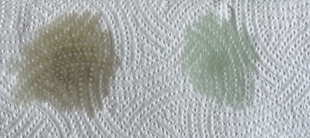

Did a power steering fluid flush today. Wheels in the air, engine off and turn the steering wheel from lock to lock. 2 litres later and it's all clean again
ps fluid.jpg (161.25 KiB) Viewed 389 times

P80GLT wrote: 15 May 2023, 12:43 Did a power steering fluid flush today. Wheels in the air, engine off and turn the steering wheel from lock to lock. 2 liters later ..
Where /what did you disconnect to drain?

BlackBart wrote: 16 May 2023, 21:49Where /what did you disconnect to drain?
Raise both front wheels off the ground, I vacuum extracted the old oil from the reservoir (it is possible to pour out into a container), removed the small return pipe at the bottom (see image) and plug the return outlet port, connect extension tube to return pipe and place in a container. Fill reservoir with clean fluid and turn steering wheel from lock to lock. Check reservoir level and don't allow to run empty. Once clean fluid is coming through put return pipe back onto reservoir and tighten clamps check level, start engine and do lock to lock a few times to get any air out the system. Wheels on the ground and check the reservoir level and that's it finished.
This was the method I used...
