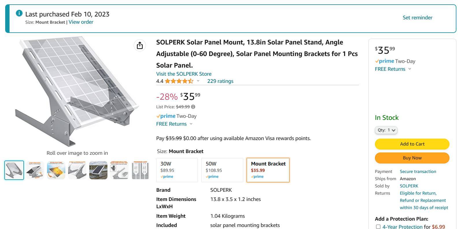

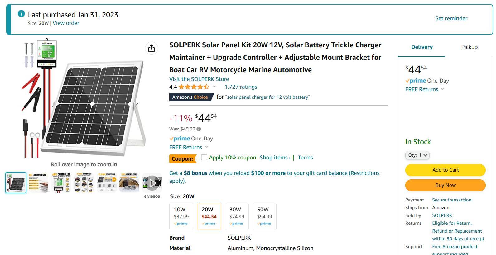

Ok here are the two things i got from Amazon:
[1] SOLPERK Solar panel kit, 20w, 12v.
[2] SOLPERK Solar panel mount, 13.8 inch, adjustable angle 0 to 60 degrees.
The adjustable angle only goes from 0 to 45 degrees though not 0 to 60 although they say it goes to 60.
The solar panel kit comes with some wire and a charge controller, but i ran my own wire, #16 AWG, one for positive and one for negative (did not use chassis ground, ran both battery leads direct to the charge controller, with fuses).
Oh yes i also bought inline fuse holders and put a 2 amp in near the charge controller and a 10 amp in the lead right next to the positive battery post. My panel puts out about 1 amp max, and it will actually blow out a 1 amp fuse after a few days as i found out.

Here are some pics that show the items i used.
One is the solar panel kit, and the other is the new bracket.
I bought the panel first, then realized i needed a better bracket. You may not need that though depending on how you want to mount it. If you bolt it down you may not need the better bracket, but it is hard to bolt down with just that one little bracket.
You can do the same as i did though, get the panel first, then see if you want the bracket later. They may make a version that comes with the better bracket i know they used to, but i dont see it anymore, maybe you can find it.
Maybe once you get it up and running you can come back and post some info about your experience with this. For me it has been great the only way i could deal with my battery situation. If you are parked where you can get a power line cord to the car you can use that, but i could not do that so i had to do something else to get power to the car. This panel worked well for that.

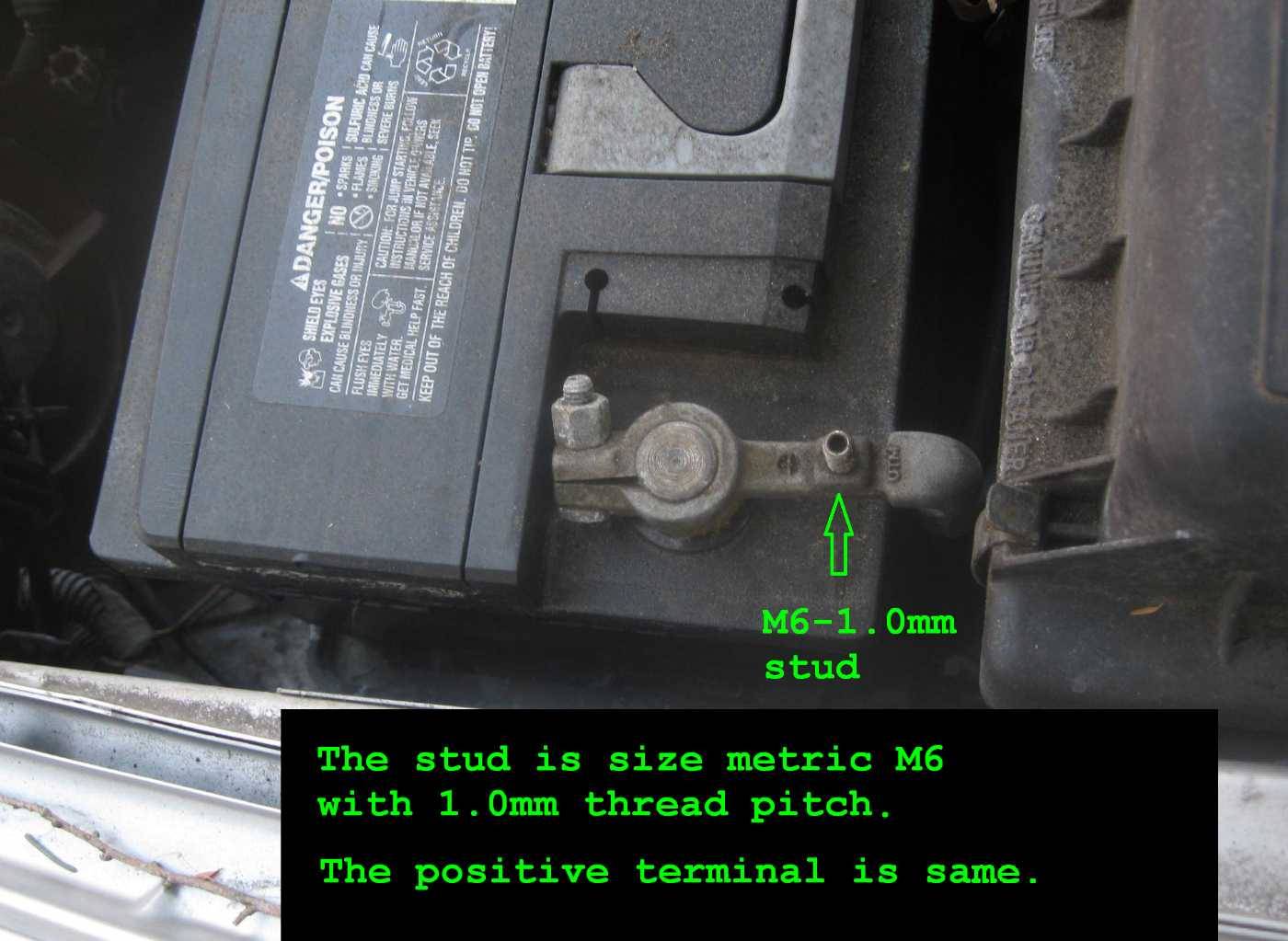

Just to note, i did not use those big alligator clips i used crimp terminals, the kind with the round hole, and bolted it to the M6 bolts that stick up from the battery connectors. I used two M6 nuts but i will be adding some washers and lock nuts in the future. I would never use the alligators except for testing with the car not ever moving.
