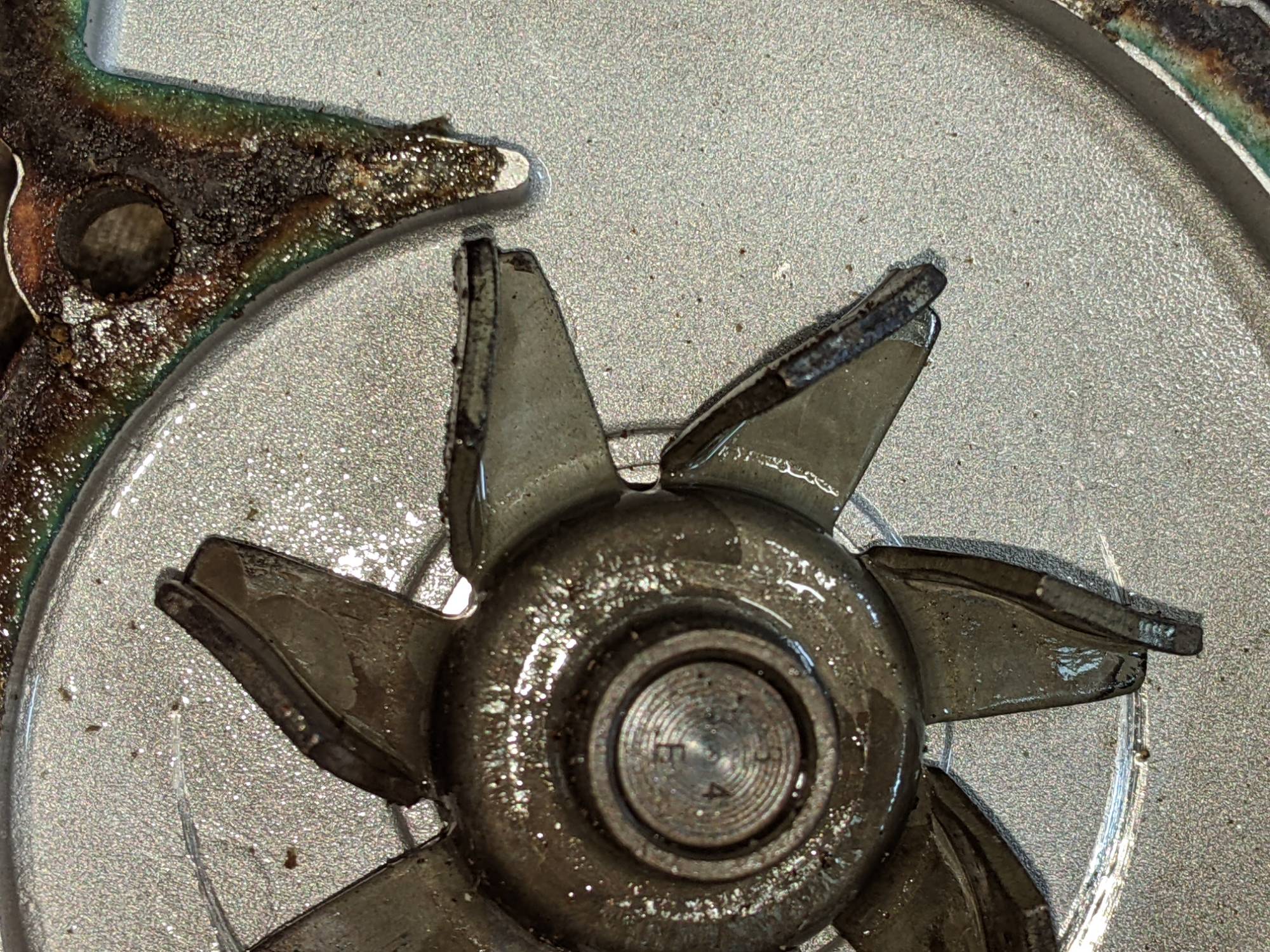

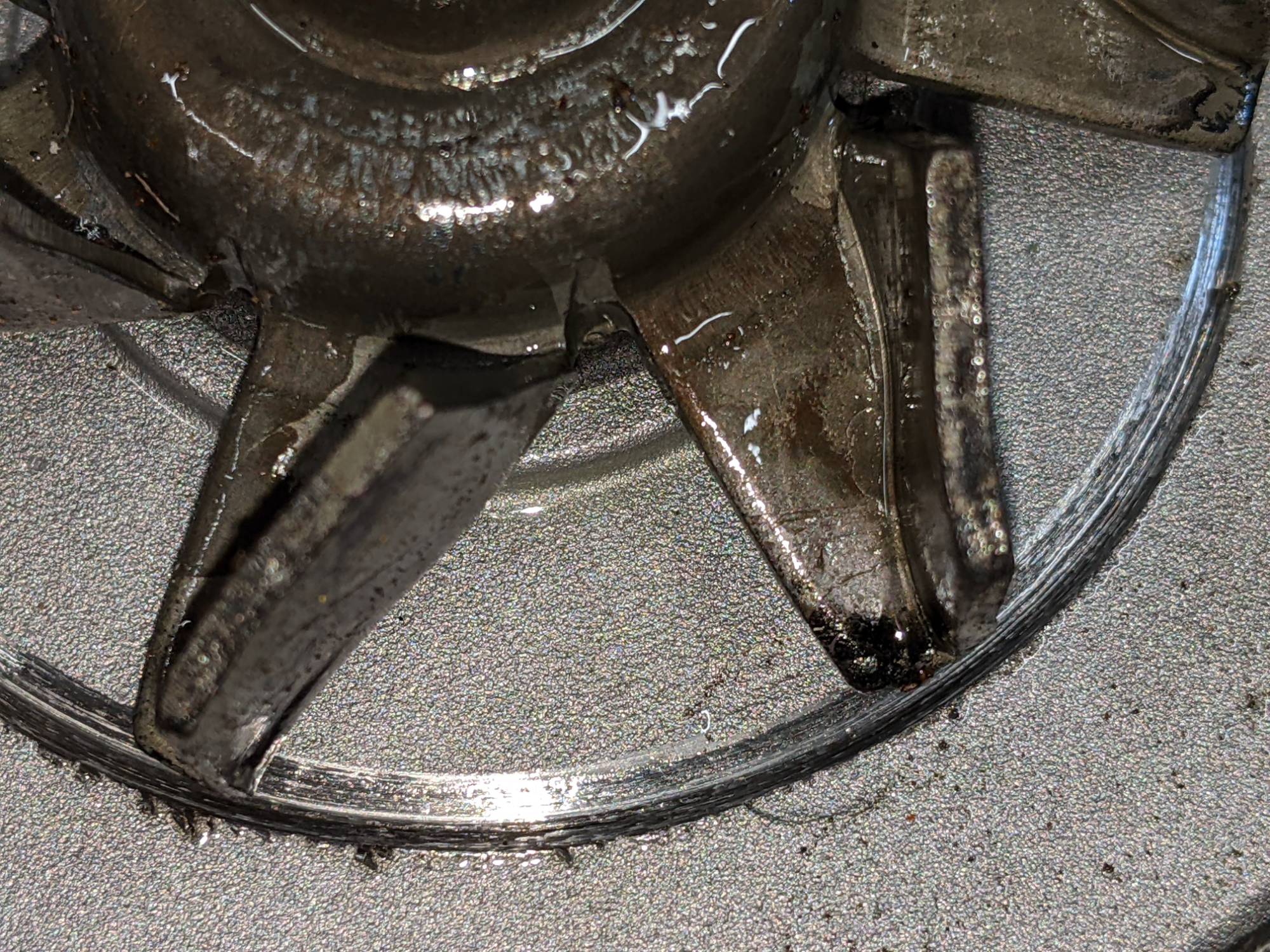

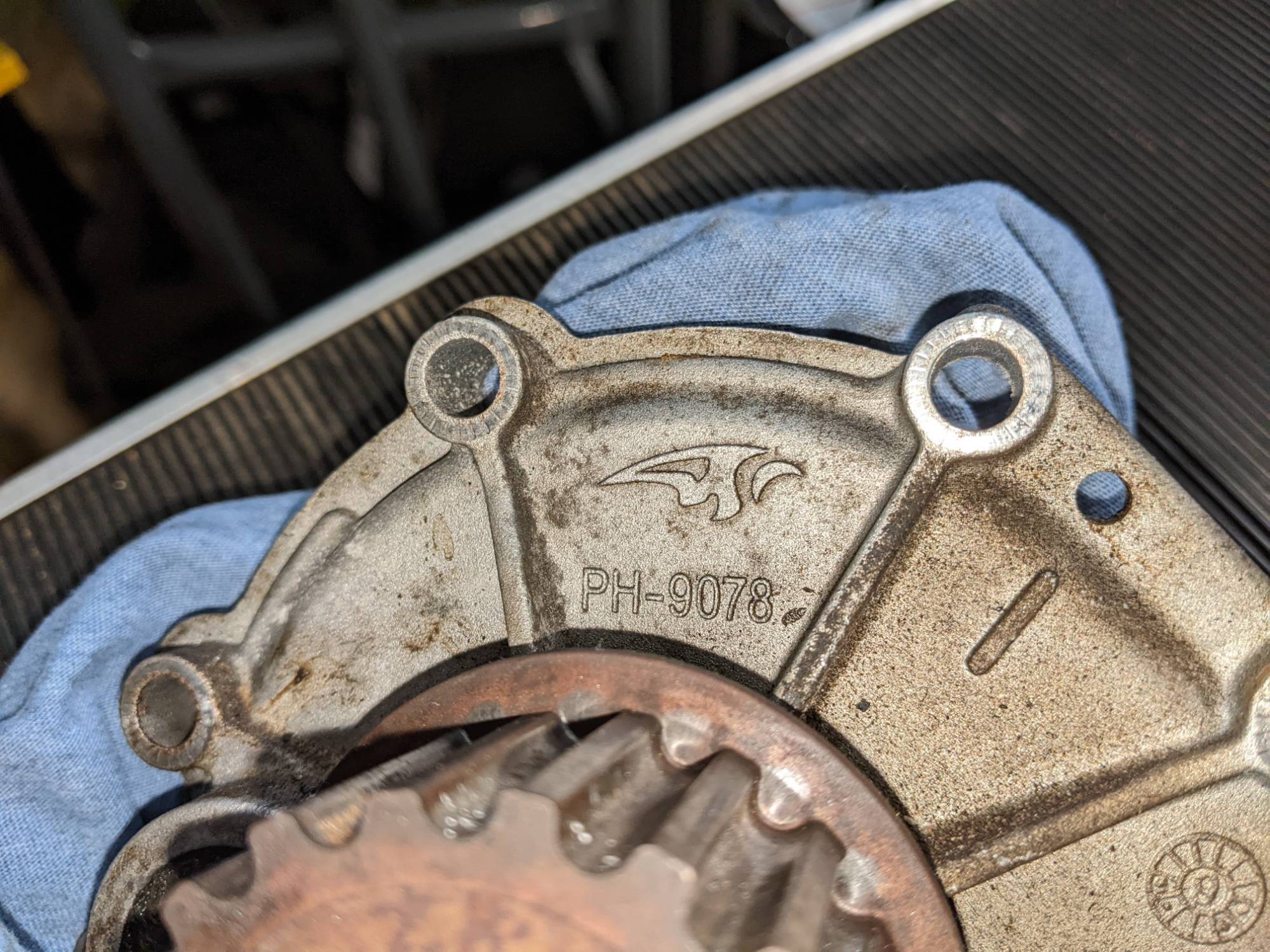

Well finally got the car to my garage and today got the pump removed. As requested, I have taken a picture of the pump. I don't recognize the brand (does anyone??). I asked the owner if he knew how old it was but he has no clue as his uncle had the timing belt changed before he inherited the car.
Removing the pump may have identified the cause of the knock in the engine. I am fairly confident this is the issue, but won't know until I can get the new pump on and the engine started.
Needless to say the pump bearing is totally shot and it flops around. The owner was smart not to have driven the car and ask as this was a time bomb!!
I hope to have the water pump back on tomorrow if the Permatex thread sealer gets here early enough. I then plan to re-install the timing belt just to see if the knock has gone. then if all is good we can plan the rest of the cars' repairs and probably a new timing belt and tensioner pulley with the idler puller.

Google images was no help with that logo. Parts geek had something like 16 vendors of pumps for these cars, crazy, ranging from $30-90

I'm guessing the pump was done, but with whatever the local big box store had for cheap. I always replace the pump when doing timing belts. It just seems like too cheap a step not to do compared to the unlikely damage and cost to fix it if you didn't.
I always use Volvo or Aisin for the pumps. I believe the Volvo pump kit comes with the bolts with the sealant on them. I'm going to send a picture of your pic to a friend that works at O'Reilly's down south to see if she knows what brand that is.

Yeh, bearings are completely shot. Not sure if it was swapped at the last TB change or not as it was back in about 2106. Car has done about 40-50,000km since then.

Is that date code on the pump a 6 or a 9 ?
