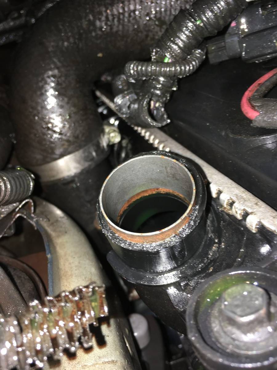

Something to watch for is getting the radiator clamp in the right place. The Volvo radiator top outlet neck isn't very long and there's a narrow gap near the metal tabs that hold the end tank to the core. I had a problem getting the clamp down far enough and behind the lip in the upper outlet that keeps the clamp and hose from coming off. My hose would pop off and the only solution that worked for me was a 45.5mm Oetiker stepless clamp. These clamps are narrower than the screw type clamp so I could push it in closer to the radiator and get it behind the lip of the outlet neck. The Oetiker clamps are also constant tension clamps that hold better over a wide temperature range. These clamps aren't as convenient and reusable as a screw type clamp but I couldn't keep the upper radiator hose reliably on any other way. I did have an aftermarket radiator, which may have added to the problem though. I do think constant tension type clamps work better for radiator hoses like the round or flat spring type or the Oetiker clamps.prwood wrote: 12 Jun 2023, 12:35 Hmm, ok. I had to wipe my VIDA VM off of my laptop a while back due to storage space and OS issues. I just tried setting it up again today using a VM from volvodiag.com, but this new VM is having some difficulty recognizing my DiCE via USB. That is probably an issue for a separate thread. I do know my cooling fan is coming on sometimes, although I'm not totally sure if it's coming on as often as it's supposed to.
I have ordered a replacement upper radiator hose to replace the one that just split a few weeks ago. Genuine Volvo this time so hopefully it will hold up.We'll see what happens once that is replaced.
This is a picture from one of the previous threads you listed, the narrow space between the outlet neck and those metal bend-over tabs is where I had a problem pushing the clamp in far enough.
