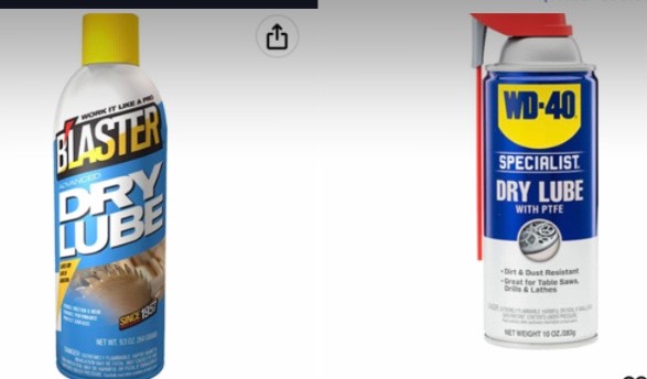

Krons wrote: 29 Jun 2023, 20:04Before you tear things apart clean and lubricate inside the key slot. I’ve had to do this on three 150k+ mile P2 Volvos.VolvoBrit wrote: 29 Jun 2023, 19:18 And that's it? I'm in the process of trying to remove the sheared screws that hold the ignition tumbler drum on. Because I read somewhere that if it's stuck on 0, it will need a new drum. Yes the S/w will turn side to side but obviously with no engine running not far.
Important to use a dry spray and not oil based as that’ll attract more dirt and gunk up the tumblers again.
On one car I do have to still repeat this a few times a year. You can replace the lock mechanism but can be delayed with some cleaning.
Well I went out to try, sprayed the contact cleaner in to clean up the innards, and the key barely turns from 0.

You forgot the dry lubricant part.

I bought some, but supposed that it should still turn without it being applied yet. No?
I just went out and puffed in the powdered graphite into the key slot. Tried coaxing the key, but no luck.

Sorry if it wasn’t clear…this type of dry lube may make it easier. If yet to have one not free up after a good clean and lube.

I bought a little tube from Home Depot. But I'll go and get one of the ones you recommended instead. I appreciate the help, just a bit dejected with it all.Krons wrote: 30 Jun 2023, 20:47 6BD85234-9FDB-4AA3-8B0A-FA6D71BDD280.jpeg
Just went out and bought some Blaster, cleaned it out again with the contact cleaner, gave it a good spray with the Blaster, and a big fat zero. I can get about 20 degrees rotation from 0.
Well, eventually I managed to undo one of the security screws. Getting too hot to continue on the second.

Hmm, yours may unfortunately be past a cleaning.
