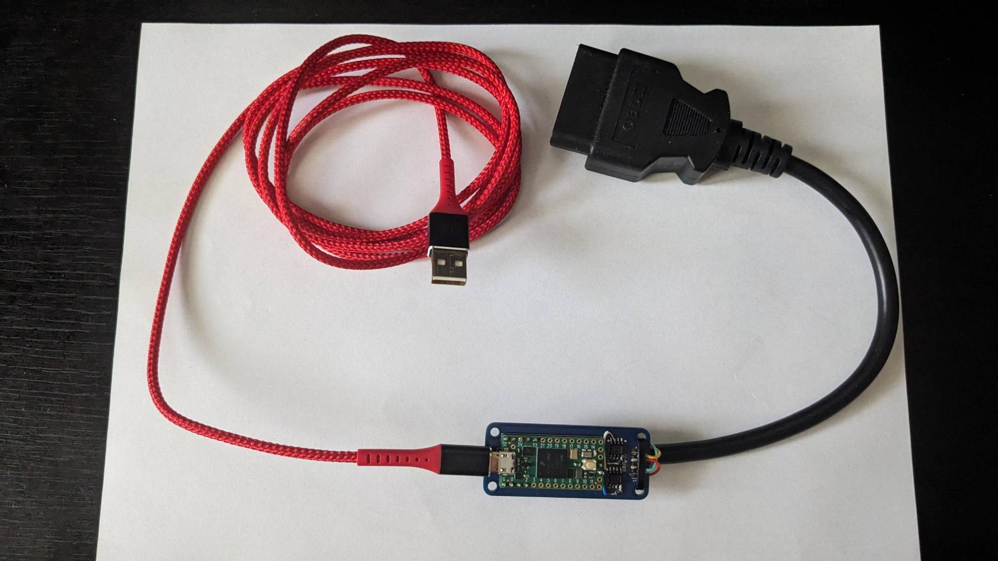

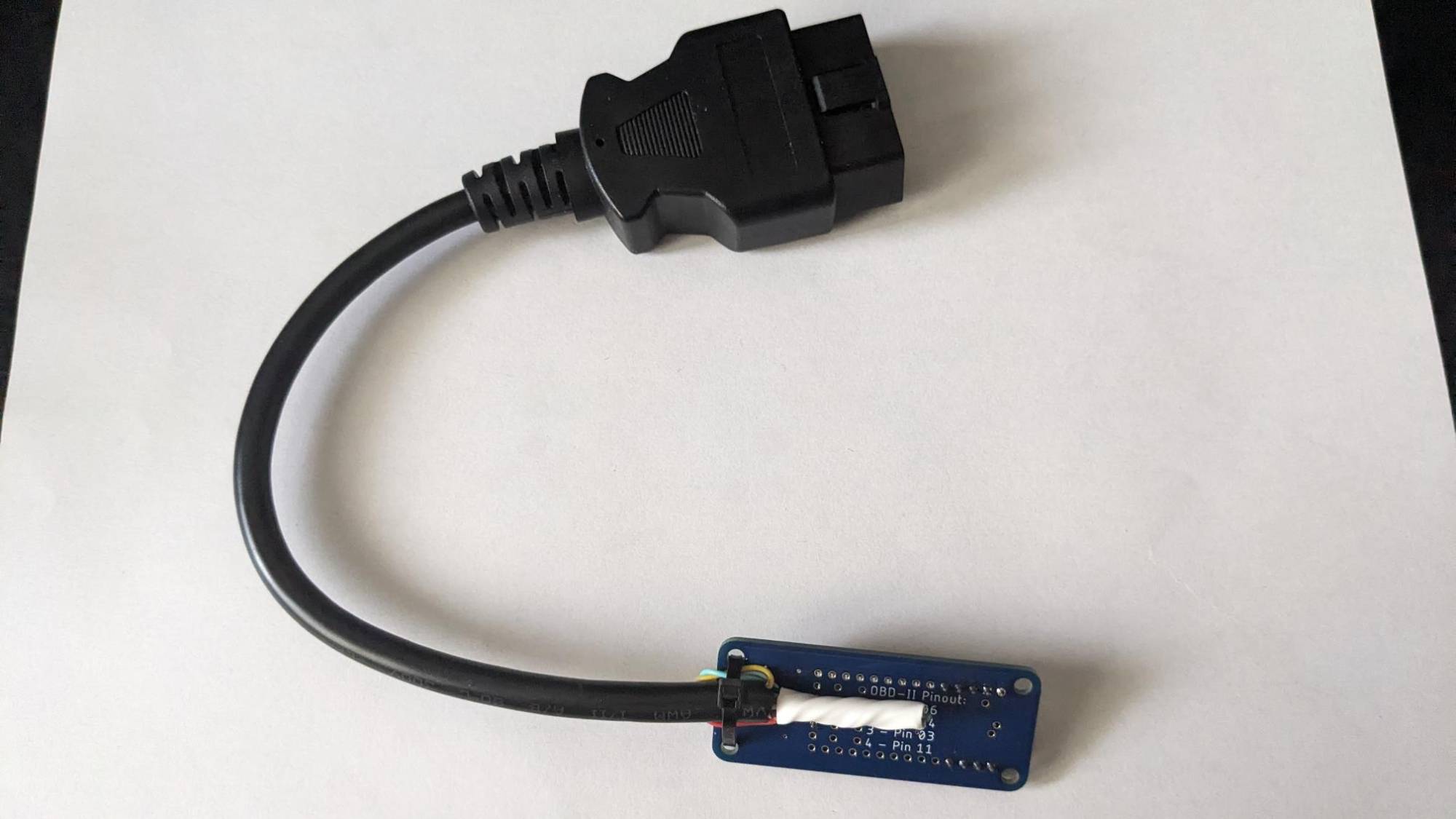

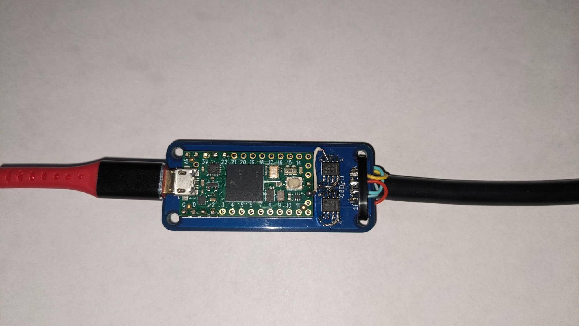

Hi All! I just want to post here a confirmation that the vtl's brute force cracking procedure works on even one of the latest P3 V40's from May 2019. The in-car cracking process for the P3 is a bit tedious since it is constantly jumping out of the programming mode every 5 seconds. At the end it took 11h and 40 minutes and voila the PIN was there!
For the P3 cracking you just have to switch to the p3 branch in the git repo and build the tool itself. For the tool I've used the PCB from PCBWay here: https://www.pcbway.com/project/sharepro ... 037d5.html
And because of my laziness I didn't even bother to modify it to be compatible with latest schematics (this is the old version that is using the Bosch CF160). I've used SN65HVD230 transceiver which is a 3.3V version. You just have to cut the trace that goes to the 5V rail and connect it manually to 3.3V that Teensy provides. I didn't bother to use any sort of "special" power cables, just a straight connection to the laptop via 2m USB/A to micro cable. Monitored the USB voltage a bit and no significant drops at the end.
Thanks to everyone who contributed to this!
I've got 4 more boards and some spare parts, so if anyone is interested (preferably from CZ) I guess I can provide some assistance.
Here are some photos of my setup:
