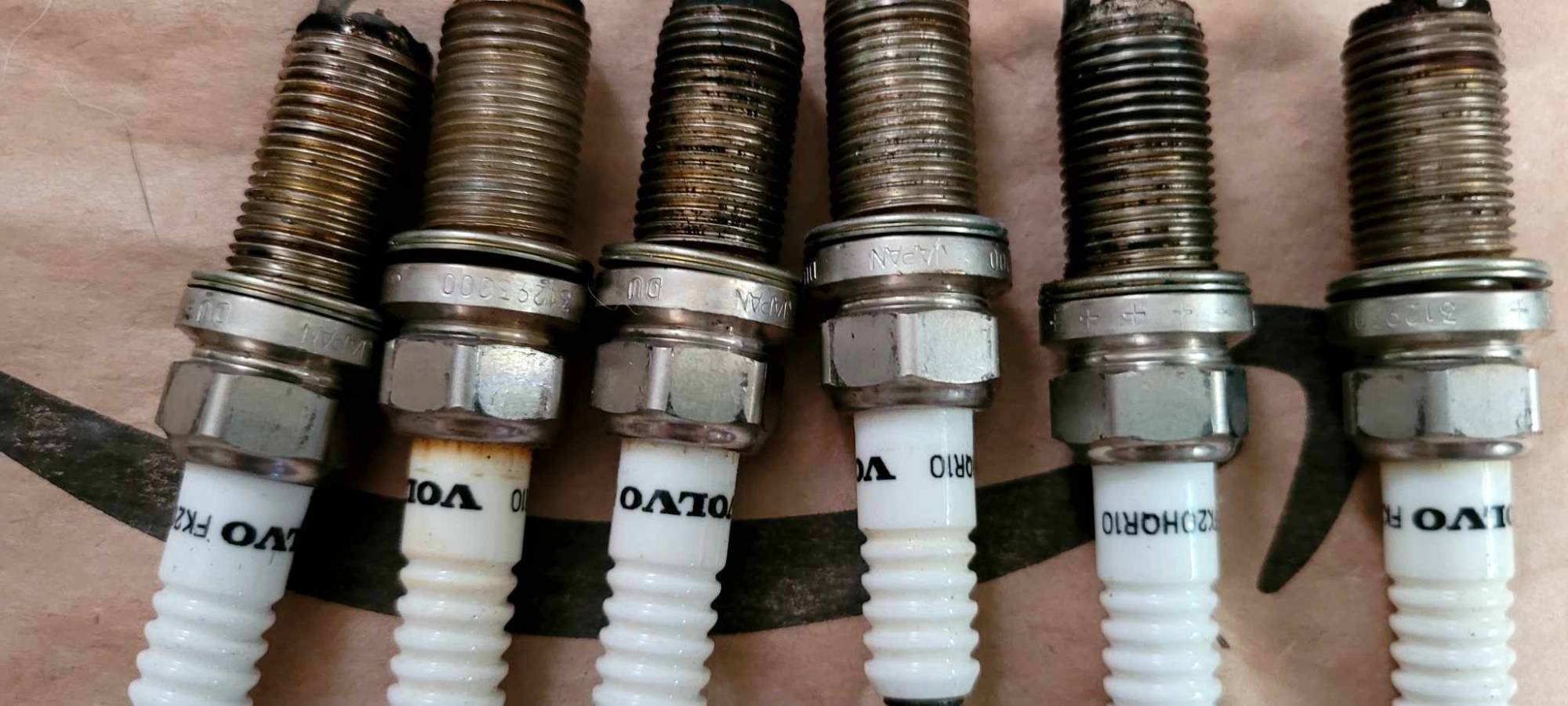

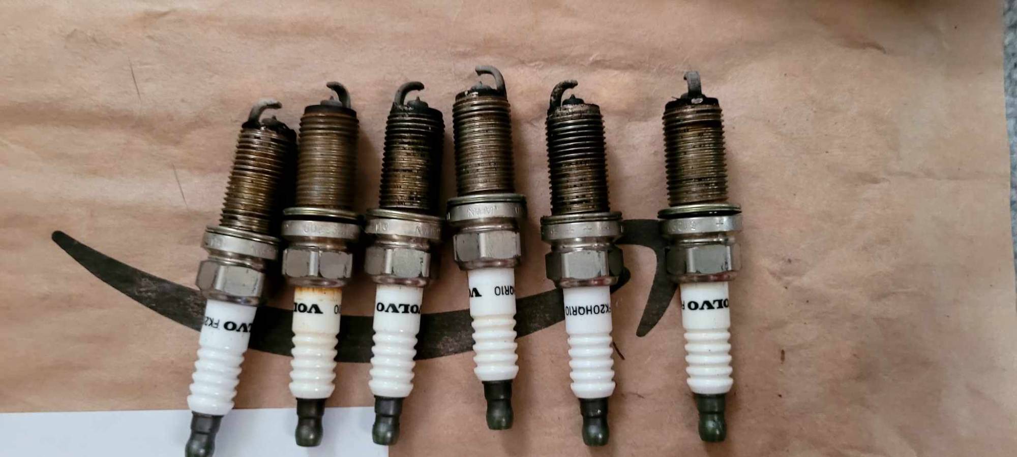

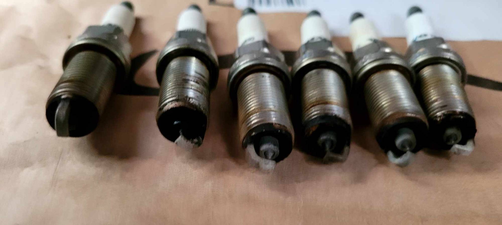

So, Check all the gaps on the original Spark plugs. Only two were gapped to .4. The others were .5 or more.
So, under the idea of that misfires could cause the gapping to expand. I pulled all the coils and spark plugs. The ones that were pre-gapped to .44 that I used.
Autolite Iridium XP5325.
Coils are Duralast C1677-6

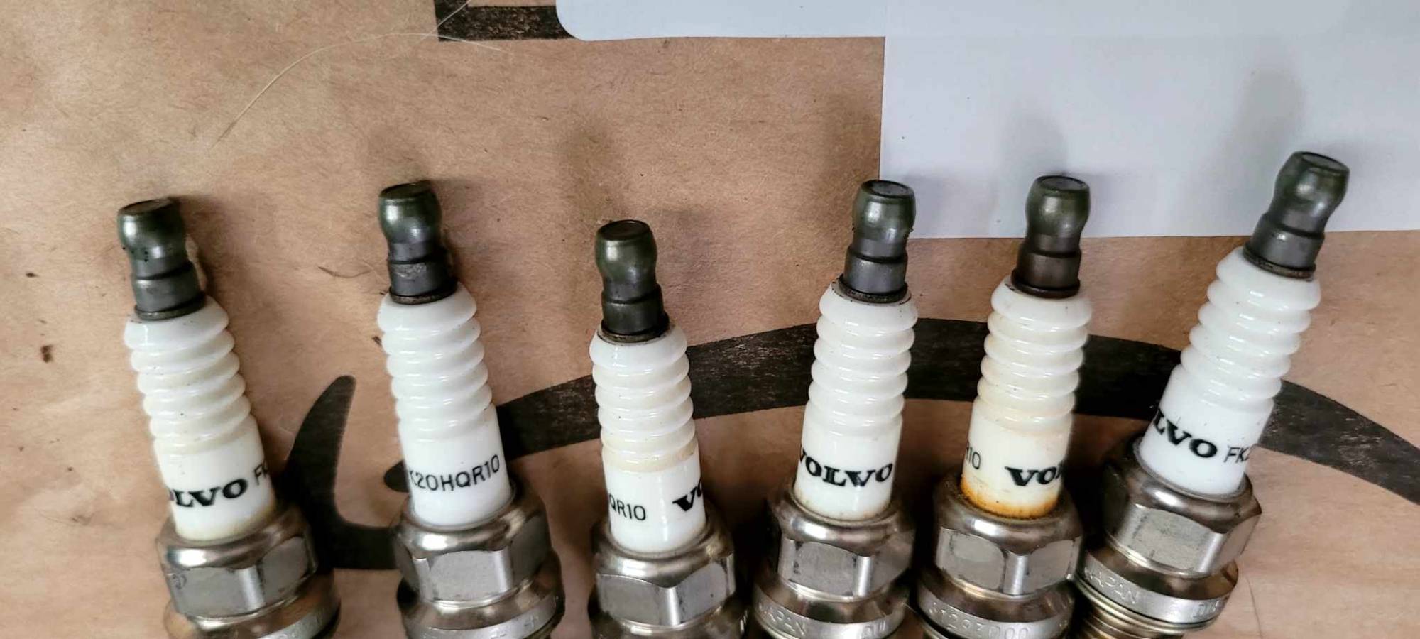

Check the new spark plugs. left to right order #2 and #4 smelled heavily of gas. #6 was dirty.
I regap the new spark plugs to .4
She seems fine for a few mins and same thing happen again.
