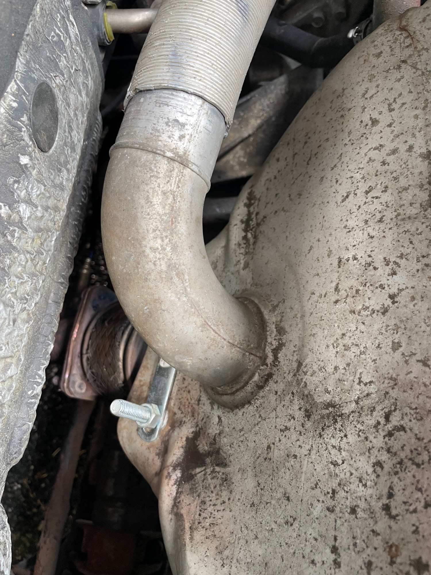

If the supports for your heat riser box have gone to entropic heaven here is a cute fix with a pretty cheap hardware store part
3.5 inch on center , 4.5 inch deep u bolt , slightly bent in to clear holes in tin
P80 NA heat riser manifold fix

What is a heat riser? It is not a term I am familiar with.

It’s this guy….
- IMG_5459.jpeg (664.76 KiB) Viewed 243 times
- IMG_5458.jpeg (711.76 KiB) Viewed 243 times
- IMG_5462.jpeg (740.28 KiB) Viewed 243 times

Remember way back in the day with V8's that had a corrugated tube that ran from the bottom of the air cleaner down to the exhaust manifold ? That is your " heat riser ". It was just to help warm up the fuel system in cold temps, by letting the heat rise up into the air cleaner, and get the choke off.

OK, pre-heat tube. That I know well, and only on NA's as per abscate's note. I still never understood why this was not added to the turbos which is what really needs it when it is cold up here as the intercoolers can freeze!
