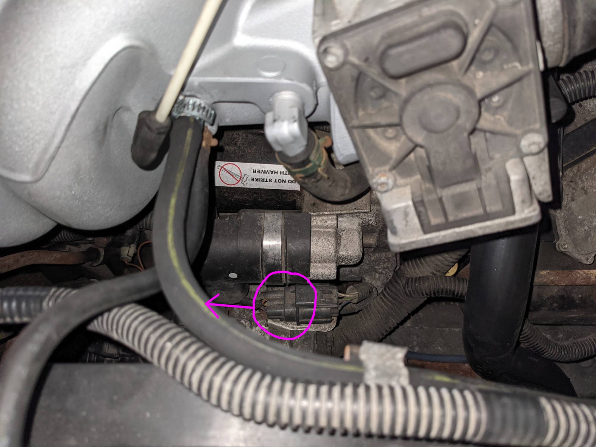

Picked up a throttle module off of a '99 V70 last week at the junkyard. Unfortunately it seem to be in worse condition than mine. Shame those cars go to the junkyard for that. However in swapping it out it seemed my plug was wrapped behind the starter. I never did get it out. I just put the new/used ETM on just to try it out.
Is there a way to get that plug around the starter. Hate to have to cut that thing or remove the starter for a plug.

The cable is routed around the back of the starter. You cannot remove it easily. A NA motor ETM is easier to remove than turbo an way more accessible. There are 2 ways to do this:
1) Remove the starter completely which is painful but really only 3 bolts. If you have the battery disconnected, you can leave the starter wires connected, undo the 2 bolts at the RH end of the starter (when standing in front of the car). and also the bolt at the LH end of the starter which has one bolt to the block. The motor has a dowel pin aligning it to the engine so you may have to persuade it off that.
You can then remove the wire from behind the starter. No need to put the next ETM wire behind the starter, but tie wrap it out of the way of the cooling fan. That is what my buddy did. If you know the ETM is bad and don't plan to have it rebuilt you could just cut the ETM plug off and lave the starter alone.
2) Maybe almost as hard, remove the rear support bracket from the LH end of the starter motor. 2? smally nuts on the back of the starter, and the one bolt to the block. You can then slide the wire behind it to get it out. This is hard to do with the coolant fan in place, but then that is a few connectors and remove the 2 x T25 or T30 upper mounting screws and loosen the 2 lower ones enough to allow the motor to be slide up and out the way.

I was able to disconnect the wiring harness for the ETM on a 2000 V70 without removing anything. Locate the connector (as shown in the attachment) below the starter's removable black plastic cover. Press the tab down on the right side (which I think is pinned to the bracket below) and pull the ETM's wire to the left. I had to do some careful maneuvering with my arms elbow-deep in the engine bay, but I removed the old wire and installed the new one. I'm pretty sure it's routed correctly.
Edit: The car on which I easily replaced the ETM had its starter replaced so they may have freed the ETM cable during that process. The car pictures is not the one I worked on, thus it might be illustrating a captive cable.
- ETM wire location
- ETM wiring.jpg (263 KiB) Viewed 601 times
