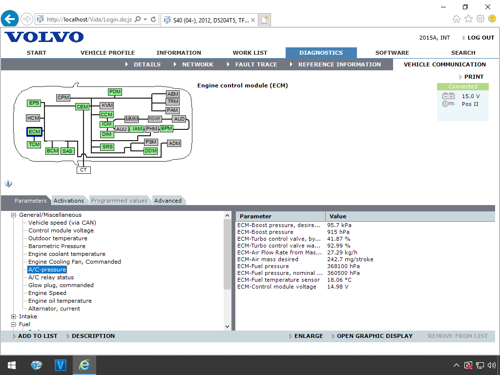

Got Vida connected and here are the results:
There were no other special errors.
Appreciate your kind assistance.
Eitan

Here is a new scan.
1. Cleaned EGR
2. Cleaned MAF with special spray . Plug/unplug does not make any change .
3. It sounds like turbo is moving a little - but not getting enough power.
4. Vacuum module on the back of the head got loosen completely probably cause of vibrations. Tighten it again - with no change .
1. Cleaned EGR
