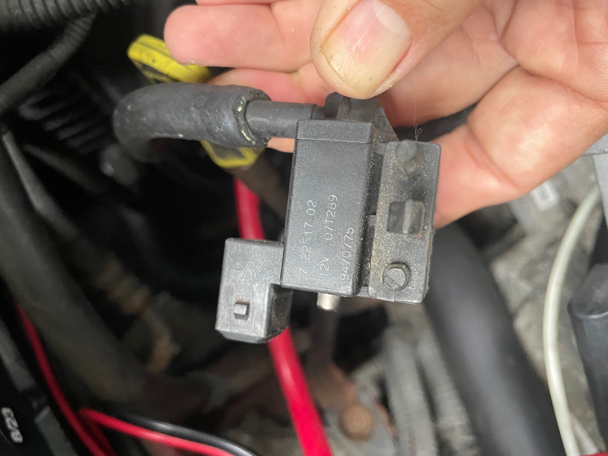

P80 late Return lacking fuel system RLFS 9470755 8627005 - fitment for 98 99 00 cars
- IMG_0994.png (747.07 KiB) Viewed 677 times
- IMG_0993.png (702.72 KiB) Viewed 677 times

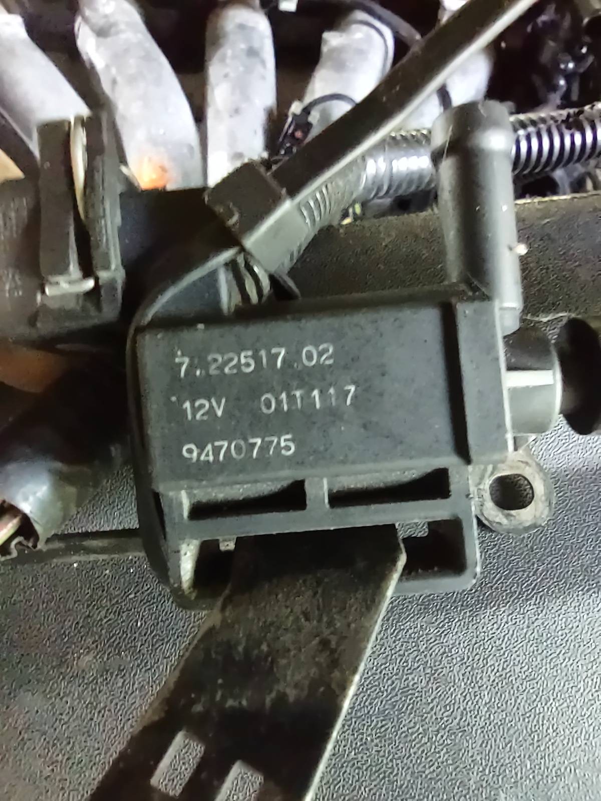

Evita 1999 S70 but has been swapped
- IMG_5765.jpeg (479.25 KiB) Viewed 649 times
- IMG_5764.jpeg (454.89 KiB) Viewed 649 times

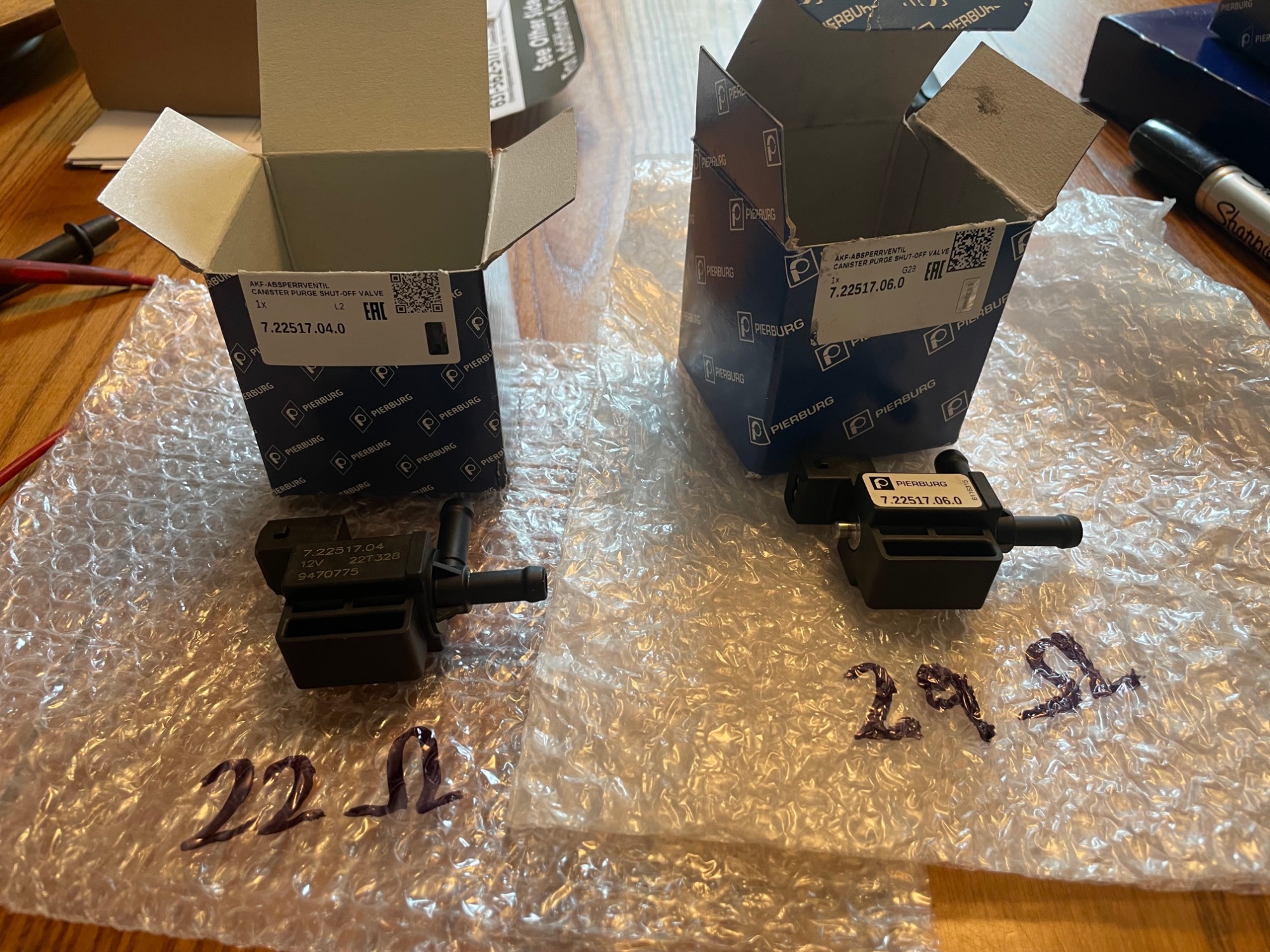

Resistance measurements new out of box parts on the two variants
04
06
04
06
- IMG_5780.jpeg (716.04 KiB) Viewed 532 times

Readings from
Shagg 22 Ohms pier burg 02
Evita 33 Ohms pier burg 02
Kat. 31 Ohms 9125243 pier burg 06
9470755 pier burg 04 and also labeled Pierburg 02 , measures 22 Ohms

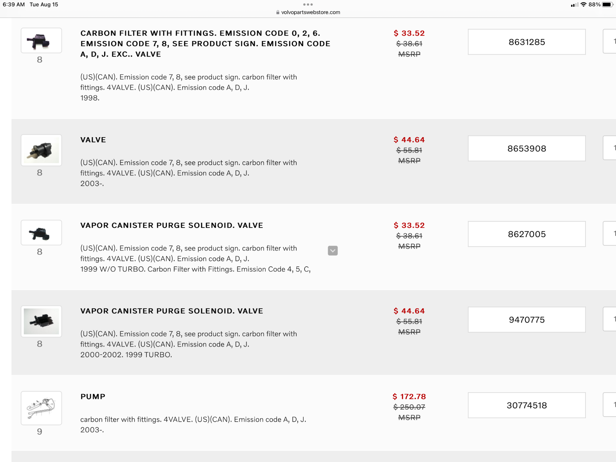

Finally figured out the emissions code. It’s the 8th digit in the VIN so
Kat is D
Evita
Shagg A
Elizabeth D
Of course, in the Volvo parts store there is ambiguous , confusing information as to which purge valve goes with which purge valve. The codes are shown in the title page of the part, then on;y a subset of codes are listed in fitment.
No idea where emissions codes 7, 8 are coming from , these are probably 850 emission codes
Grrrrrr..
It also shows another Pierburg part number suffix
02 04 06 03 00
To add to the fun
Kat is D
Evita
Shagg A
Elizabeth D
Grrrrrr..
02 04 06 03 00
To add to the fun
- IMG_1002.png (454.48 KiB) Viewed 350 times
