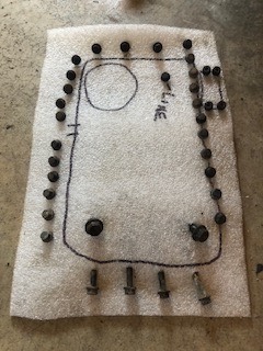

Removal of the pan is about 28 10mm and 2 14mm bolts of varying length. I used a piece of styrofoam to keep track of them and where they go:

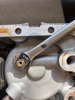

Below is the oil filter bypass valve, probably a good idea to take this out and make sure its clean and working. If you were ever wondering what your 11mm wrench is for, I think this is the only time I've ever used it!

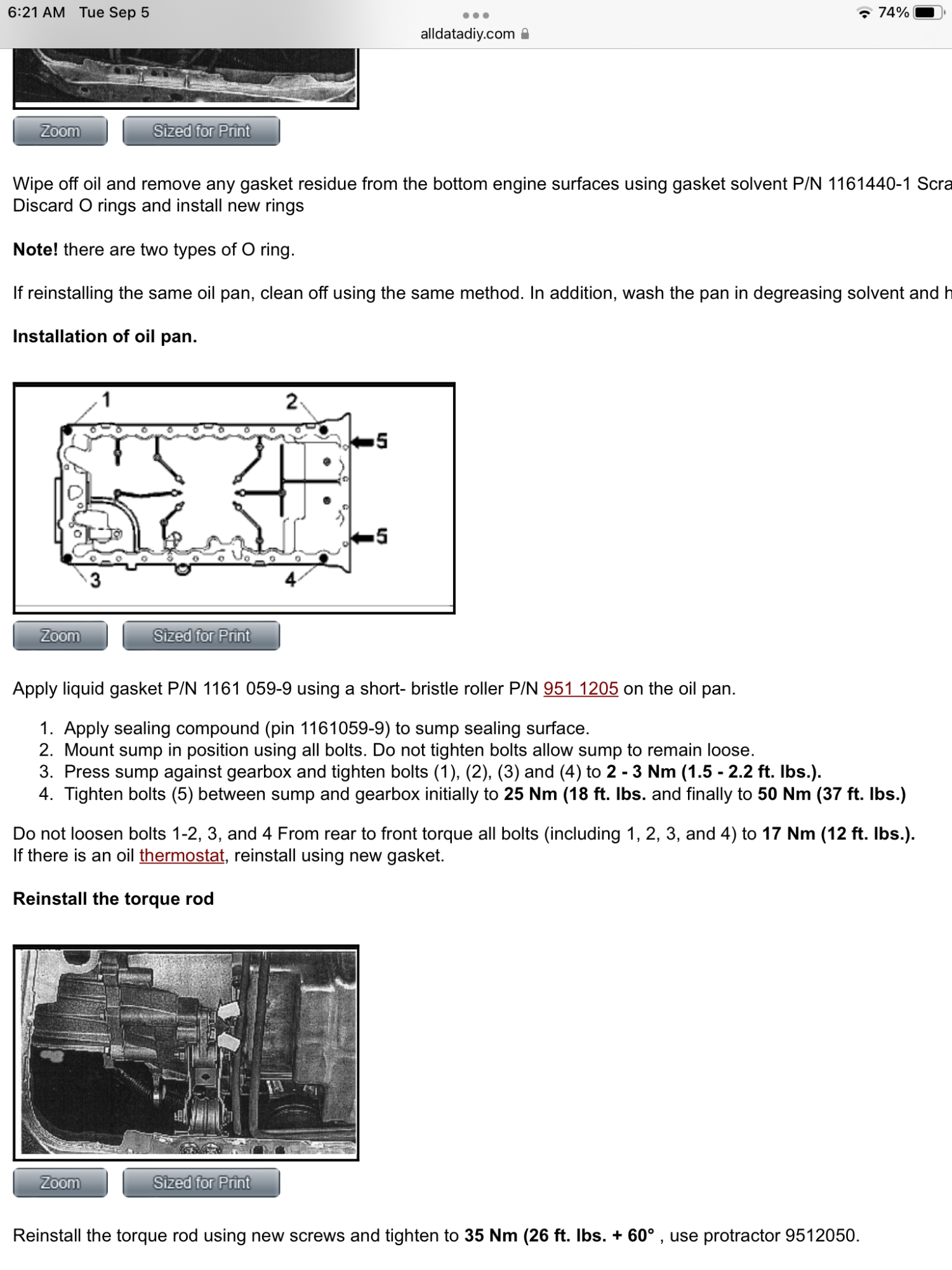

With the sealant applied thinly with a cheap paint roller, I offered up the pan and reinstalled and torqued the bolts. There is a very specific tightening sequence to be followed for these.

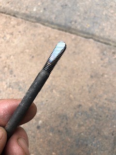

What happened here? Upon reinstallation the middle bolt on the transmission end didn't want to accept torque, my first thought was that it somehow got stripped. I left it in the hole and when I started the engine, there was a terrible shrieking for about 10 seconds prior to the bolt falling on the floor and looking like this:
There was no leaking and the noise stopped after the bolt fell out, I resolved to source out another bolt from the wreckers, thinking that I'd somehow mixed the bolts up and put the wrong length bolt in the hole. Today I got another bolt (same length from the same hole) and it screwed right in and accepted torque so all's well. I've seen a picture of a similar incident on this forum where that bolt gets shaved by the starter teeth on the flywheel, but why did the first bolt go all the way in if it wasn't threaded properly?

that bolt got slightly adrift and friction tightened against the flywheel.
I've seen before.

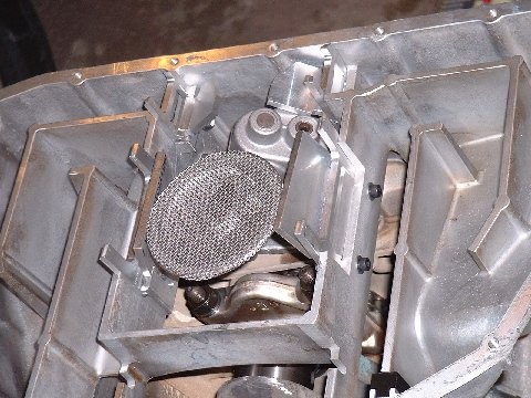

Alfa Romeo 1600. Pan fits over the crossmember, then has a deep wide "batwing" pan with complicated oil baffles inside. Also air-cooling fins that hang out of the bottom of the car, right where speed bumps live.
I'm replacing the rear main seal, which means rear crankshaft bearing cap which means pan.

There is an important part of the oil pan install where you put the four corners in loosely, the the horizontal bolts get torqued to spec. That pushes the pan into the right position so that the bolts don’t hang up. I do think you got the wrong bolt in somewhere , looking at that nicely machined bolt.

I think jonesg is right about the bolt being adrift, all four bolts on the transmission end are the same length and the longest bolts on the pan. I took these out at the wreckers and they were all exactly the same length. Its very strange. I followed the tightening sequence to the letter with the horizontal bolts, then in pairs to the starboard side. Anyways, all bolts are in and it doesn't leak. Thanks for you help jonesg and abscate.
