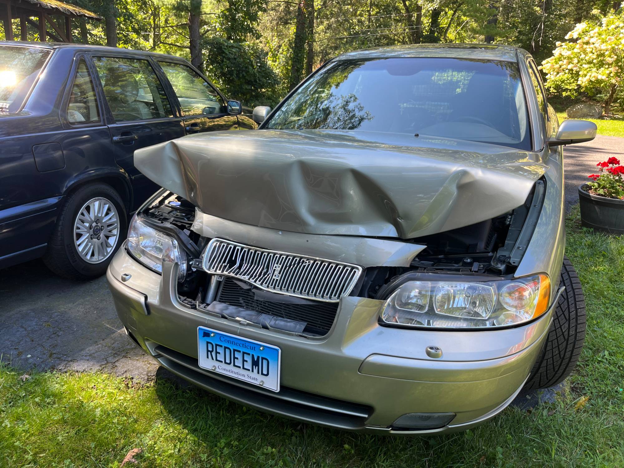

My daughter had a little Ooopsie last Thursday with my V70. She loaded it all up with her stuff and headed out to Boston to go back to college, then she crashed into a pick up truck a few miles from home. Luckily no one got harmed, but she was obviously pretty shaken by the whole thing. We had the car towed home, then transferred her stuff into the 240 and the 850 and went to Boston the next day.
My initial thought was to take off what I can and get rid of the car, because this is going to take some patience and time to fix, both of which I do not possess at this moment in time. But after things sunk in and calmed down a little, I thought maybe I should attempt to fix it, provided that I find the right donor. The alternatives just aren't really viable, and the car is in very nice shape overall. So the purpose of this thread would be to document things as I go along, which might help someone else in the future.
One of the first things I want to do before spending money is to make sure the engine did not get damaged. After the incident my daughter pulled off the road into a parking lot and ran the engine while loosing coolant for about 20 - 30 secs. Then the tow truck driver decided to back up the car and line it up with the tow truck and ran it for another 10 secs (at least that's what he told me). At this point probably without any coolant.
Hopefully next weekend I can spend some time and try to open the hood. The locks are totally jammed up, so this might require some force. After that I want to start it up with a garden hose feeding a constant supply of water into the cooling system and see what happens.

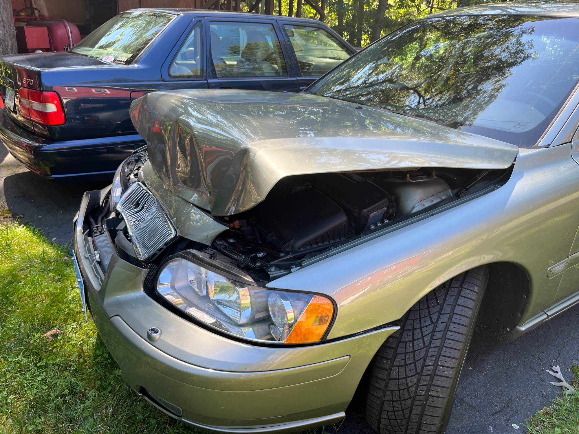

Just from peeking in I can see that the cross member with radiator support, radiator itself and fan are toast. Passenger headlight is cracked, but the driver side looks salvageable. Since the impact was just above the headlights, the bumper itself was not affected. I do not anticipate finding frame damage, but we will see.

Yeah, it went right over the bumper. So radiator and coolers are trashed, radiator support / upper crossmember....
Did it shove hard on the hood hinge area on the cowling? Did the upper crossmember pull in on the fenders as it folded?
You might take a crowbar or a cutting disk on a grinder and cut through the hood pins and open it. Crude tools are appropriate.

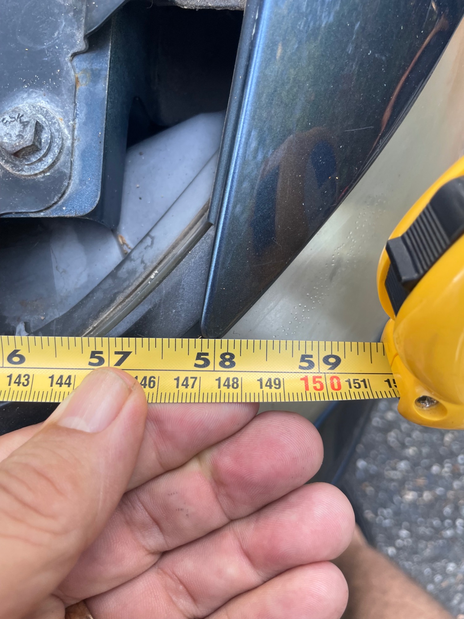

Hi Bart, thanks. It looks like the fenders did not get pulled in, but it's hard to tell. And it might be hard to figure that out until a new hood is fitted. Or perhaps if I can get the dimension between the front edges of the fenders from another car and then compare?
You are right, the hood hinge area got shoved really hard.

I see nothing indicating frame bending. Fender measurements coming
