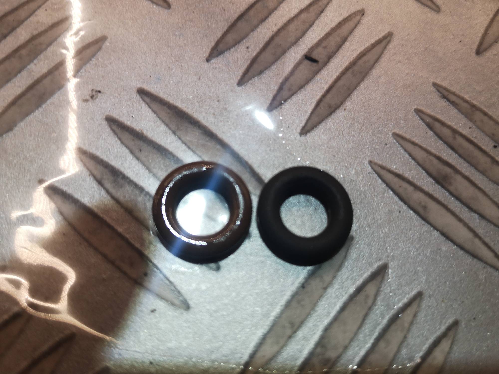

Hello again,
So i changed the o-rings with vaseline (PS on Vida it says to put vaseline on the big o ring of the fuel pump and fuel sender so...).
On the photo you can see the ebay one on the left, bosch one on the right.
Idle is now at 844rpm exactly (i think oem value is 840?), and there is no leak anymore as when I put brake cleaner on the intake manifold it has no effect anymore !
Thanks to everyone who replied here
There is just one thing that still upsets me: seconds after an acceleration, I sti smell a hot/oil odor.
