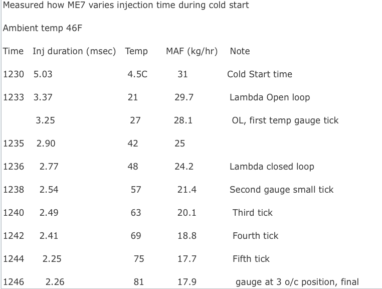

Measured how ME7 varies injection time during cold start
Ambient temp 46F
Time Inj duration (msec) Temp MAF (kg/hr) Note
1230 5.03 4.5C 31 Cold Start time
1233 3.37 21 29.7 Lambda Open loop
3.25 27 28.1 OL, first temp gauge tick
1235 2.90 42 25
1236 2.77 48 24.2 Lambda closed loop
1238 2.54 57 21.4 Second gauge small tick
1240 2.49 63 20.1 Third tick
1242 2.41 69 18.8 Fourth tick
1244 2.25 75 17.7 Fifth tick
1246 2.26 81 17.9 gauge at 3 o/c position, final

Note it took 14 minutes, sitting at idle , for coolant to reach operating temperature
In contrast, my NA S70 of same year took only 4 minutes to reach the same temperature in town driving at 21F

I really like the table of injector, MAF, temp vs time. I am going to save that as it could be useful some day. Thanks.
I don’t get the comparison of v70 idle vs s70 driving warm up time. Isn’t that apples oranges comparison?
