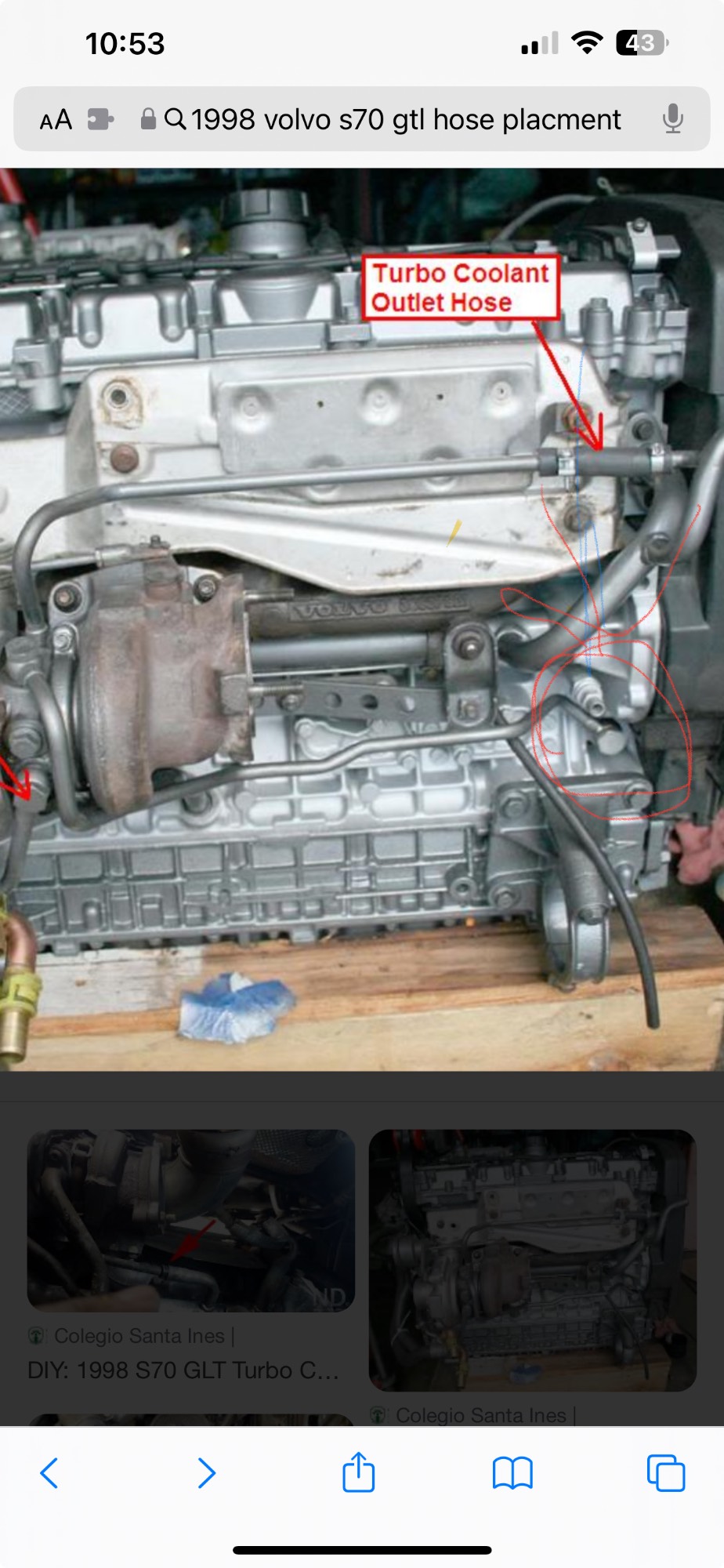

Hello new to this site. Currently putting together a 1998 s70 GLT. There is a nipple on the back side of the motor, passenger side I can’t seem to find what hooks up thier. Any help would be appreciated

Its the cooling system drain nipple and it doesn’t take a hose. With an engine out it’s a good idea to crack it , clean the threads, and no seize them

I also find a length of hose I can attach to it for when I do drain the coolant so it does not spray everywhere.
