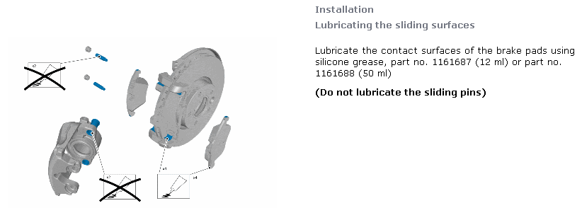

Brake caliper mounting…
When I did the rear axle drop on the cat I replaced every single mount bolt and cleaned and never seized the lot. This saved my life when my workmanship failed 200 miles from home, and an Indy dropped it for me 4 hours labor
No judging here. We have all cut corners on a job because of time money people pressure. But, understanding the job in its completion is important so we understand the consequences.Install:
the new brake disc. Tighten the locating pin (5). Tighten to 8 Nm
the caliper holder. Use new mounting screws (4). Tighten to 100 Nm .
