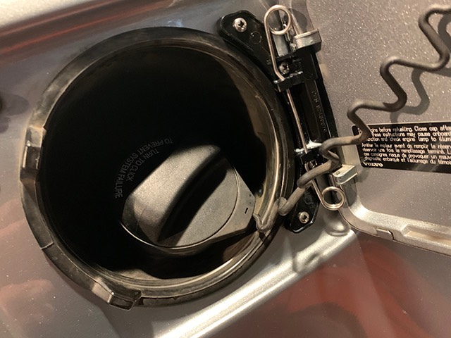

MoVolvos wrote: 13 Nov 2023, 18:16 Yes, after removing the retaining ring just push it back some without disconnecting the filler neck.
Thank you; it worked! The 1/2" #6-32 stainless steel machine screw was a better fit for the shorter double-walled space.

xHeart wrote: 19 Nov 2023, 10:10
The 1/2" is cleaner looking also though no one will ever see it :lol:. I noticed I did cut one due to the distance of the double wall. Will see if I can go back and make a change to my post to reflect this. Thanks.

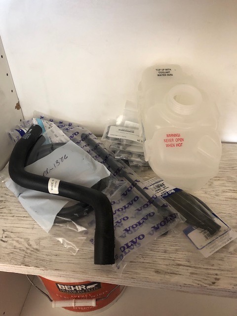

Installed some new parts today, after having the hood come down on my head 3 times I decided it was time for some new hood struts. Also got a good assortment of Oeticker clamps from BelMetric, does anyone know if our cars use anything other than "167" series stainless 7mm wide clamps anywhere besides the CV boots? BelMetric is great! You can buy lots of 1, 10, 100, any amount you like and the price is good and fast shipping. I also found a NOS rear cargo mat in Oak on Marketplace for $50 that I will install in the spring when I do the annual shampooing the carpets.
