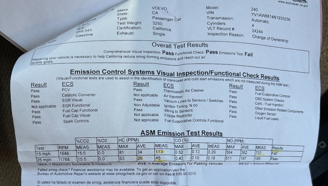

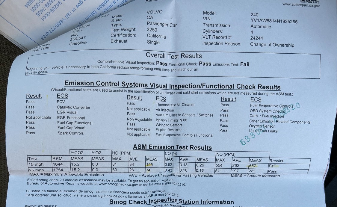

Anyways, none of them will pass smog. Here is the information I have on the burgundy 92 Volvo. I don’t understand. It runs so smooth. Like a champ! It failed twice! Would come one please tell me why? I hope it doesn’t need a new cat
Here is a photo of the test results

Just doing a quick internet search, I came across this thread on high NO reading. Timing and EGR function are mentioned. https://community.cartalk.com/t/ca-emis ... d/32210/15

I am no expert, but it looks like the tester highlighted high HC and NO. I think this means Hydrocarbons and Nitrous Oxide. High hydrocarbons may indicate a rich fuel condition and high NO is often caused by high combustion temperatures.
Suggestions are check fuel pressure - low pressure may make poor spray pattern at the fuel injectors. Dirty and worn injectors can also cause rich mixture. IPD Volvo has injectors for $37. Also try Tectron fuel system cleaner.
Also clean and replace spark plugs for better combustion. I failed a Colorado emission test years ago and new plugs made it pass.
