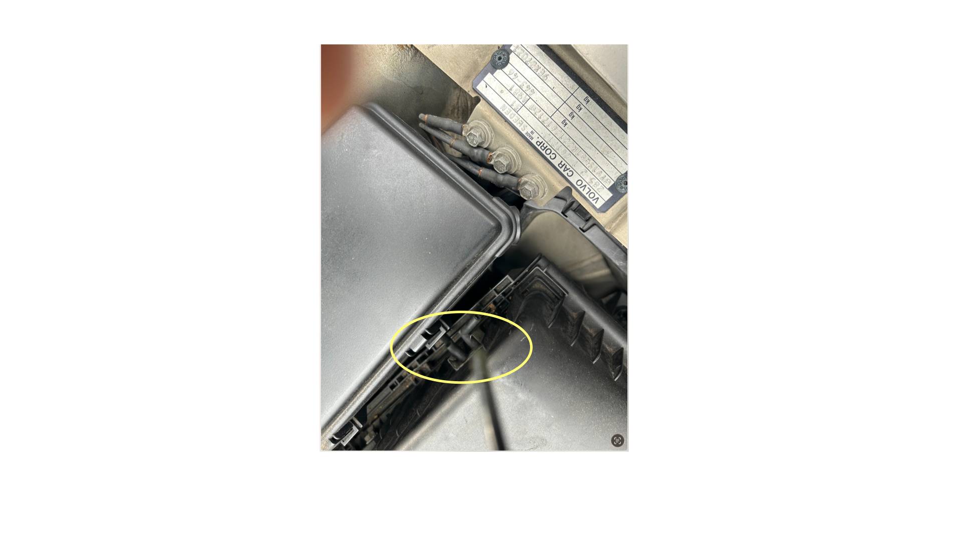

Hello,
Have a 2002 V70 (203k miles). Was running great when the 'check engine' light came on with a message for urgent service required.
I opened the hood and saw the wire at the right in the yellow circle had popped out (the left one was intact). This unit is just in front of the fuse box.
Any idea if this could be the problem, or any other suggestion?
Would also appreciate any thoughts on keeping this car. Ran dependently for ~19 years, but in the last year have had twice to replace ignition coils, fuel pump (started leaking), and now this new problem (just put in a new battery).
Thanks!

That’s a small vacuum hose, and it might cause the service engine message, but you need to read codes to learn what’s triggering it for sure.
