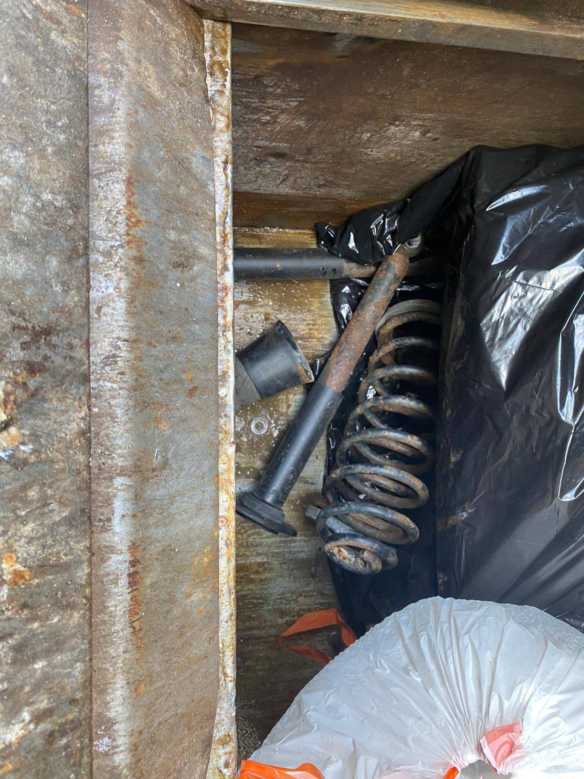

3. The work so far- Anyways. I purchased the car. It was lovely, but had some age to it. So I have been fixing things. The list so far:
-New reman'd calipers
-Replaced the non existent dust shields

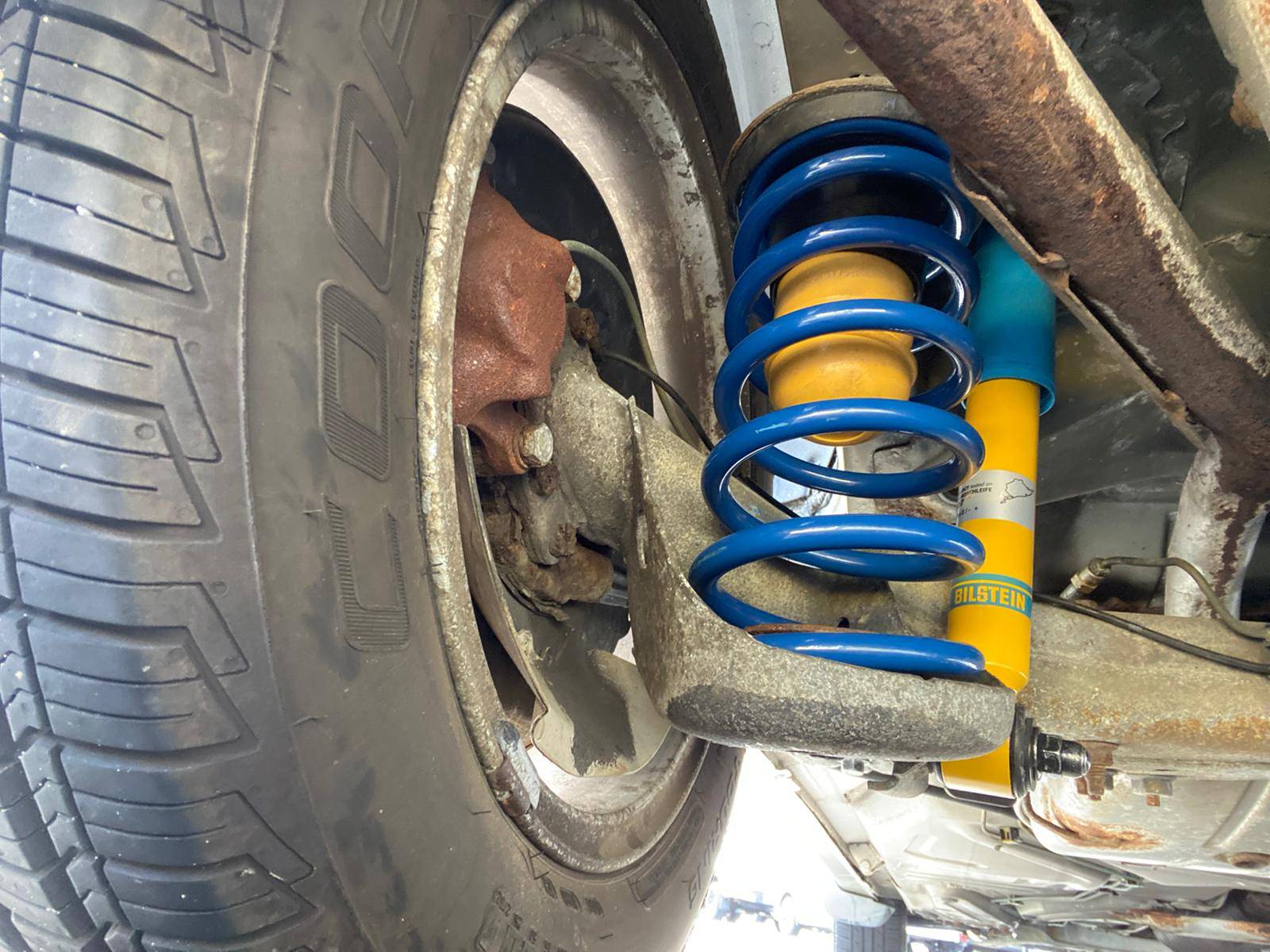

-Rear shocks with bilstein HDs, and the rear springs with the IPD HD springs, new bump stops, the works for the rear.
-Front struts with Bilstein Touring, IPD HD mounts, and all new hardware. I kept the front springs, as I couldn't find any replacement that wasn't lowering, just stock.
-IPD HD swaybar endlinks
-Brake hoses with the IPD stainless braided hoses,
-All the motor mounts: front, rear, side, torque mount, transmission mount.

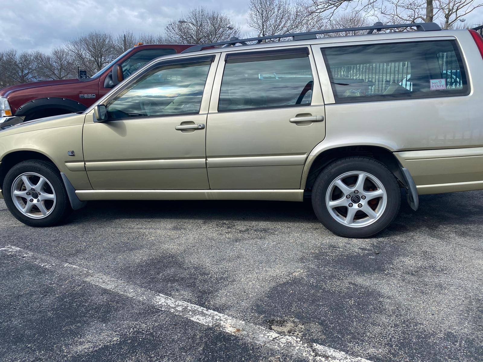

What a beautiful cream puff! I wouldn’t do anything but factory paint on that moving forward.
You might need to do the rear delta links in the suspension after so many years, but they could be ok too. You are probably 40-50k away from needing a new electronic throttle body, so watch eBay for the $150 late 2012 Volvo replacement part xxxyyyzzz to keep in stock, and a gasket too.

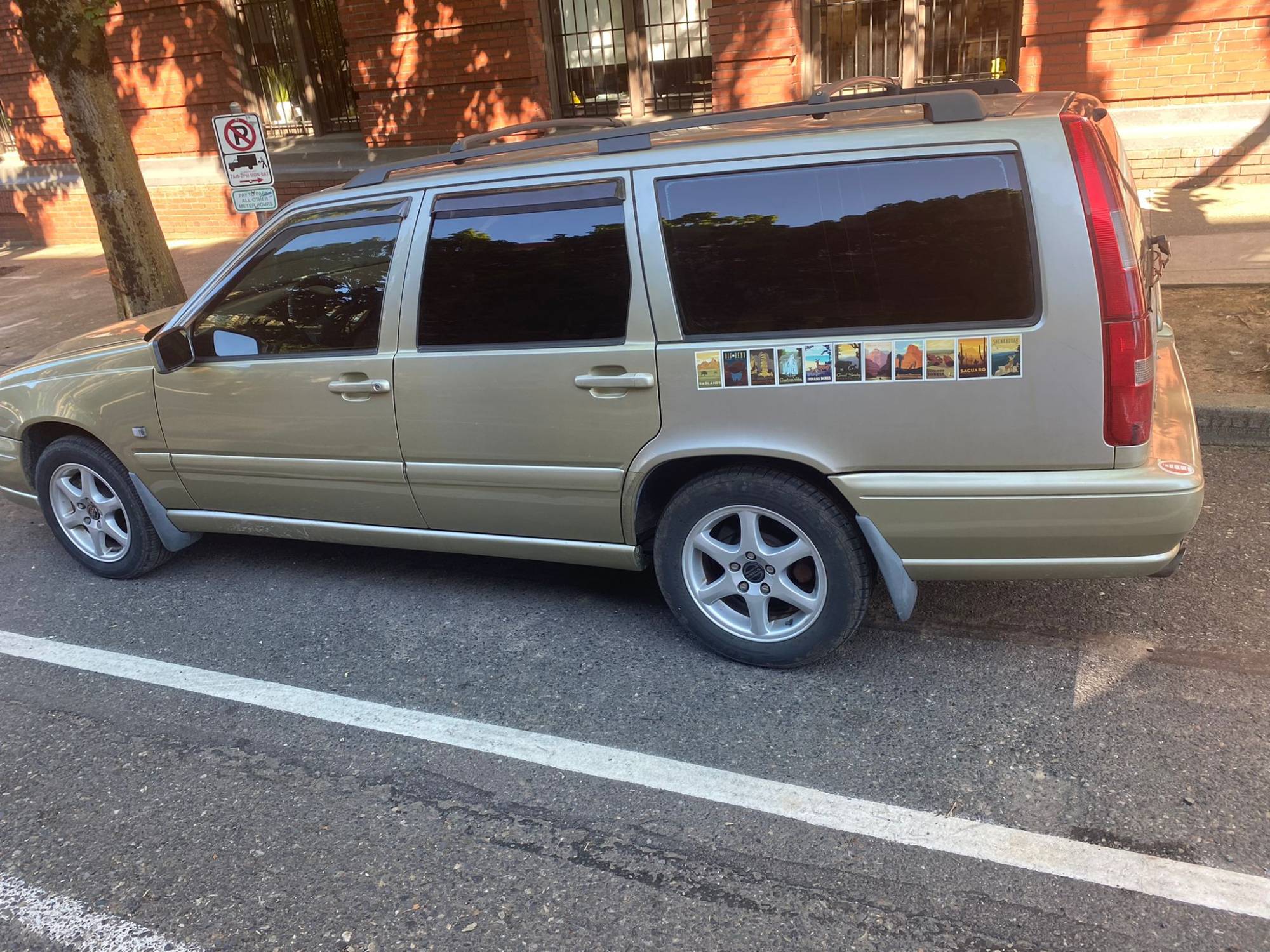

Thanks for the reply. I have purchased the replacement delta links. I haven’t installed them yet, as I have heard it is a PITA. Waiting for warmer weather. I am a bit bummed the blue tool is out of service. It seemed the be a great idea. I think I will build my own. I did see a post somewhere where a person attached a cable to the link, and the other end to a sledgehammer and swung it like a golf club. Seems terrifying.
I appreciate what you have said about keeping the paint. One of my thoughts was to keep the paint, fix the clear coat and scratches and put a wrap on it as a protectant.

I'm +1 with Dr. Abscate on leaving the exterior finish as is for the moment at least. Doing a full colo(u)r change on a car the right way will likely double the price of the job. Address reliability/driveability to Stage 0, then see where things stand.
In case you haven't noticed, nobody here puts anything URO on our cars. Ever.

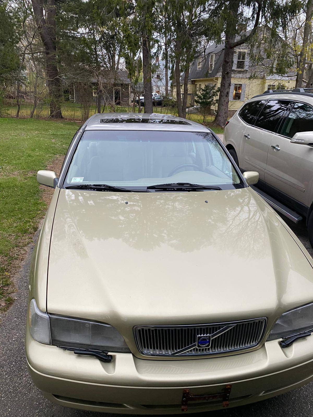

The paint work depends on how far you go. I have wanted to do that on my car, but everytime I had the funds to at least get some done, something else broke. So 12 years later it has still not been done.
Is is an optical illusion that the car from the rear door back is a different color (lighter). It is weird as I have seen several Volvos for sale up here claiming no accidents yet the cars are clearly showing a different color from the rear door back?
I am not usually a 'green' car person, but I really like the color!!
As the guys have suggested, tackle the mechanical stuff first and protect the underside and rocker panels, before tackling paint.

This car looks great. I would not do paint for a long time. Thanks for posting photos.

Thanks for the input on the paint. Given the consensus, I will just repair the clear coat, and buff everything. See if I can get it a bit more even. I have so many people ask me if my car is gold or silver or green or tan. It wears on me, so I will just buff and remove the scratches. Luckily I don't have any real problems with orange peel. They did a great job at the factory.
