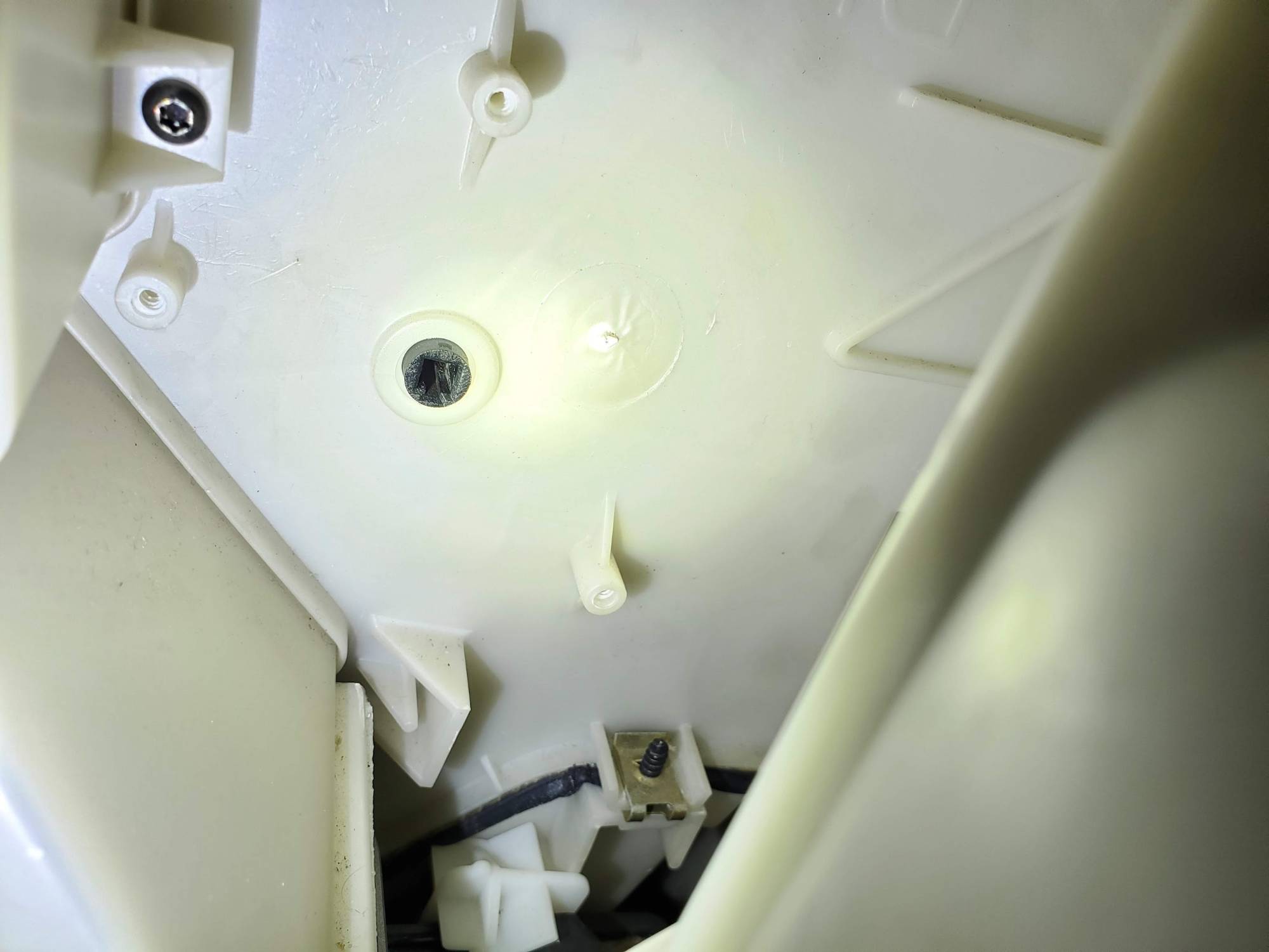

Finally got around to pulling the damper motor behind the glovebox to find that 1) the motor seems to be functioning normally (it moves in response to the passenger side temperature knob with good force) and 2) that the spindle it plugs into feels intact. I can twist the spindle a little with my fingers and it feels the way I expect (I can twist it one way but not the other since it lays against a stop, and when I release it pulls back to that stop by gravity I guess). I took a photo and see no cracks in the spindle.
So at this point I'm stumped because I feel like I've ruled out an electronic issue by the first observation and a mechanical issue by the second observation. My gut still says there must be something wrong with this motor-spindle connection that I'm just not seeing. What do you think?

Odd. It's possible that it's cracked internally. Also, verify your motor and spindle are clocked correctly in relation to one another. If it's not, it will try to force the door past its stops and blow the spindle apart.

V50M66 wrote: 13 Dec 2023, 22:54 Odd. It's possible that it's cracked internally. Also, verify your motor and spindle are clocked correctly in relation to one another. If it's not, it will try to force the door past its stops and blow the spindle apart and/or just refuse to work because it's encountering too much force at the wrong end of the travel

The flaps can degrade and become sticky and actually stick to the casing. Try to move the spindle yourself. Careful use of a small flat blade screw driver on a diagonal may work to try to turn it unless you have a small square bar to fit the hole. If using a screwdriver to not force it or you could crack the spindle end.
