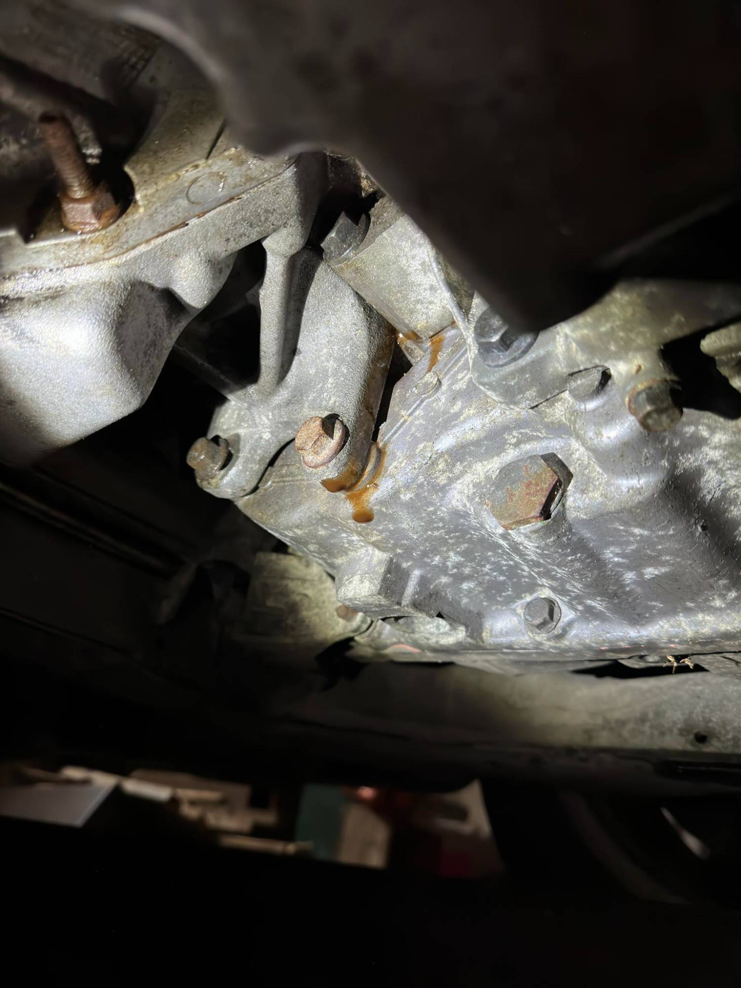

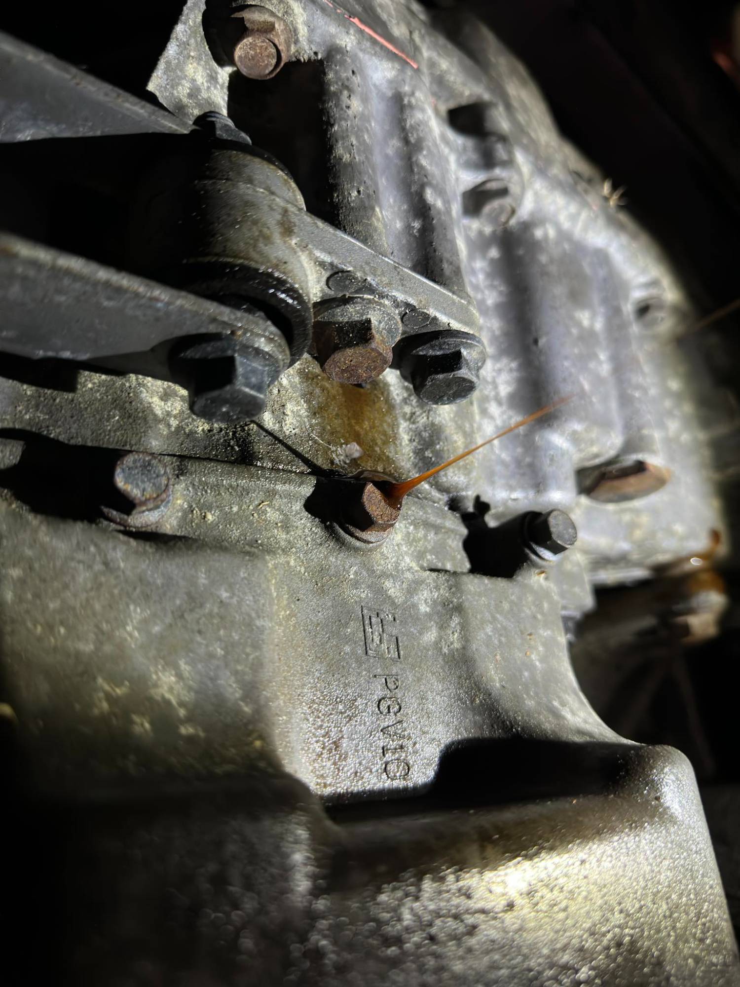

Hey, i have a problem with my transmission, it is leaking from the weep hole and from one other place aswell, i don't know what it is called.
It happened right after i drifted a little bit on the snow, a lot of transmission oil just leaked out on the ground, i checked the dipstick right after it happened and it was bone dry. Pulled it to a garage, checked the dipstick 2 days later (with a cold engine and transmission) it was even over the HOT line. How is this possible? What could be the explanation?

Post by wheelsup »
If it is where the transmission and engine mate, there is most likely a pump seal that is going bad.

Should i just take off the transmission and check it out visually, change seals that need to be changed? This is my only idea what to do, Is it the best option?

Post by jonesg »
before dropping trans I'd have a mechanic put it on a lift and inspect it, they're good at finding leaks.
