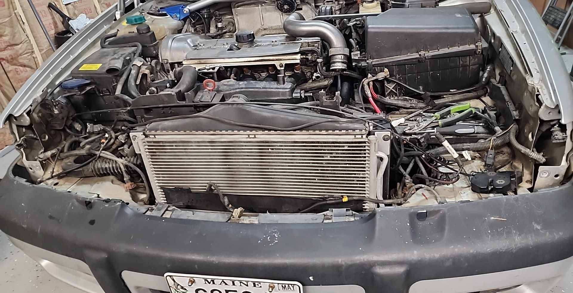

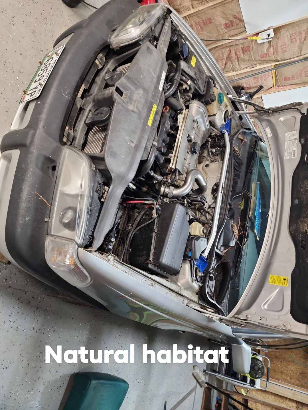

Would an immobilizer problem cause the car to not crank? My 2000 V70 XC wouldn't turn on the other day. I go and put the key in and when I turn it it doesn't crank it just goes click.
The car ran two days before it was parked where sat. The only thing that had changed between then and now was I plugged in the passenger seat.
previously The car was driving around fine with no seats in it, so I don't know why it would be acting up all of a sudden. I thought it might have been the starter, but I pulled that and bench tested it and it's perfectly fine.
But anyways, aren't what I did for the day.

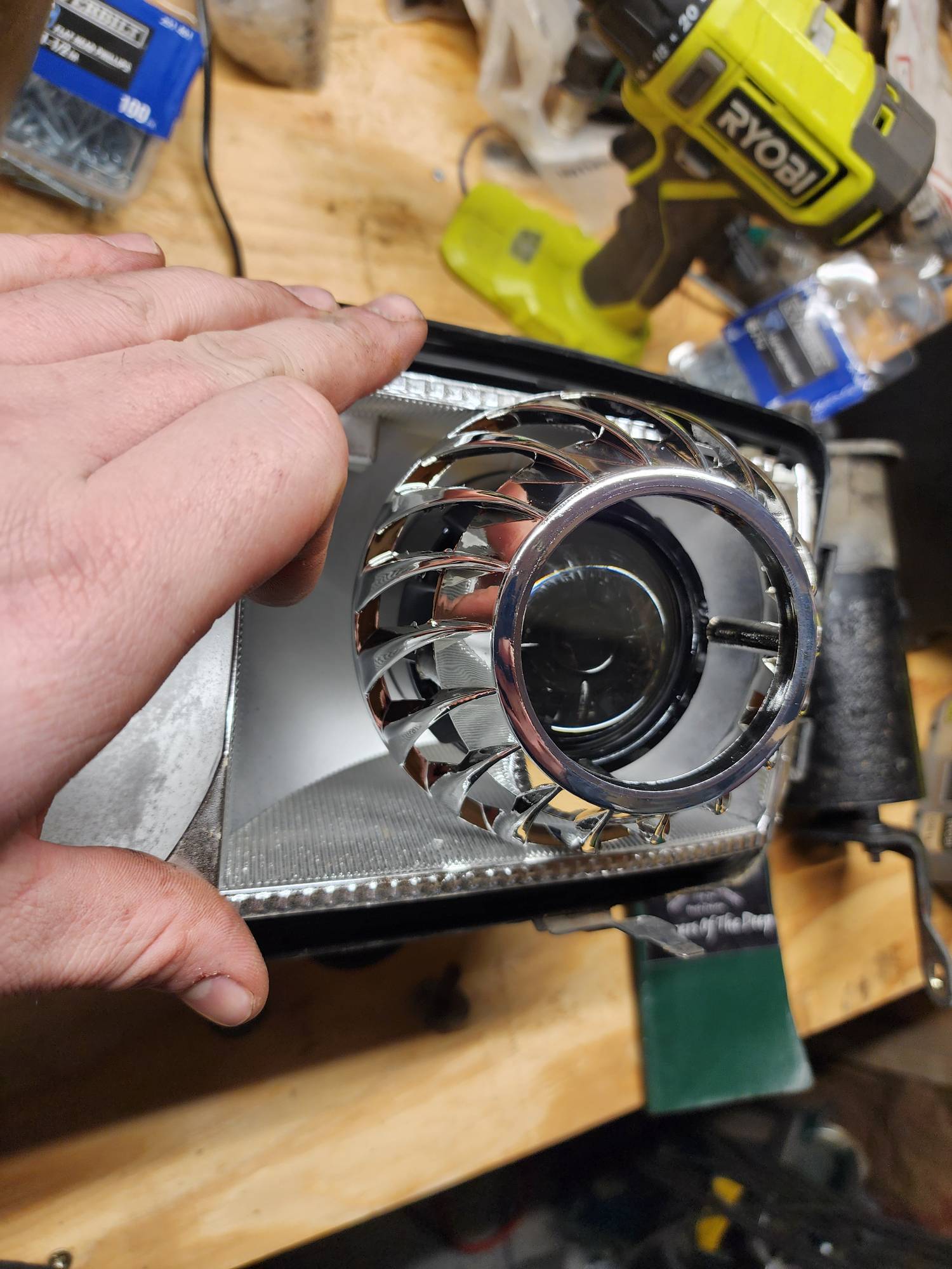

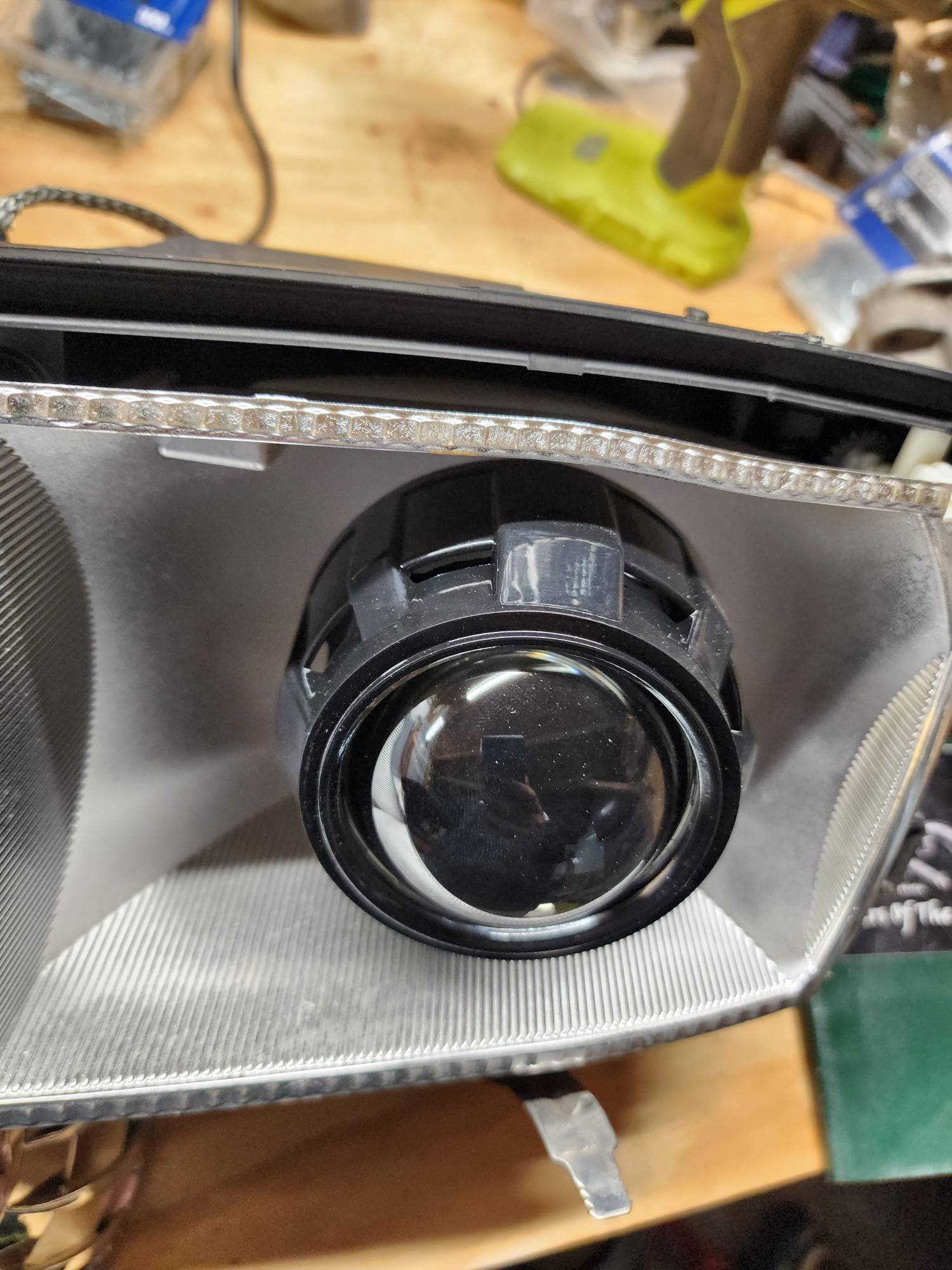

I pulled the bumper off to get the two screws for my fog lights I broke off months ago. Had to put a little bead on there and extract them with a pair of vise grips. And I got the header panel on from the car I scrapped this summer, because mine was broken.
Tomorrow I'm going to put the bumper back on get fog lights mounted up and possibly swap out my headlights.
My projector retrofits need the housing swapped. The nutsert on one of the headlights broke and I had to cut it off. So I'm swapping the projectors over to my C70 headlights, and I'm going to swap the shrouds so they match the chrome. I'm going to have to cut these shrouds a smidge, but it's not a big deal.
And hook up the high beams so that way I have stupid bright high beams.
Any help with the no start issue would definitely be appreciated. There is fuel there is no crank.

Are you getting enough power? An immobilizer issue with cut fuel and spark, but not the starter crank signal.
