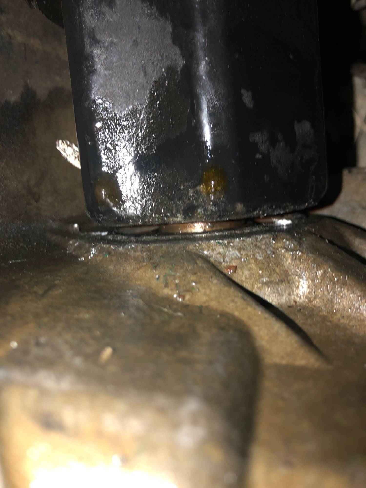

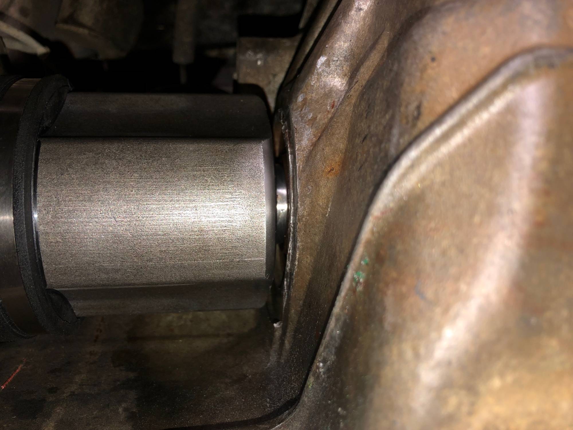

I installed the new axle which is aftermarket from TRQ. I noticed the gap is a little wider than it was before. Is this normal? I can not pull the axle out or push it in more.
Old axle
New one
2002 v70 X/C 288k miles

The locking ring should hold it in place, but yes it is suppose to look like the old one. If you couldn't yank off the axle then it should be good. It might be that they got lazy with the proper dimensions.
Ok so you cheapened out on the axle. I did as well, and it lasted me under 2 years. I understand it's an old and hard to sell Volvo, but it's gonna bite you in the wallet if you don't get either the Volvo parts, the manufacturers that makes the parts for Volvo , or parts recommended from a dedicated website such as FCPeuro.
GKN makes the axles for Volvo which will save you a lot of money. The part number is GKN 8252033.
I advise you check on the axle regularly after a year as cracks started showing on my axle boots I'd say after 2 winters.

02V70 wrote: 02 Jan 2024, 17:21 I installed the new axle which is aftermarket from TRQ. I noticed the gap is a little wider than it was before. Is this normal? I can not pull the axle out or push it in more.
Old axle
New one
Because the axle is likely an axle manufactured in China the gap could be different from OE and in my opinion a larger gap is better for axle fork tools to work but, the quality of aftermarket axles from China is all over the place from complete garbage to marginally acceptable. If you can't pull the axle out easily, I'd say the circlip is seated in the groove and the gap is whatever it is.
