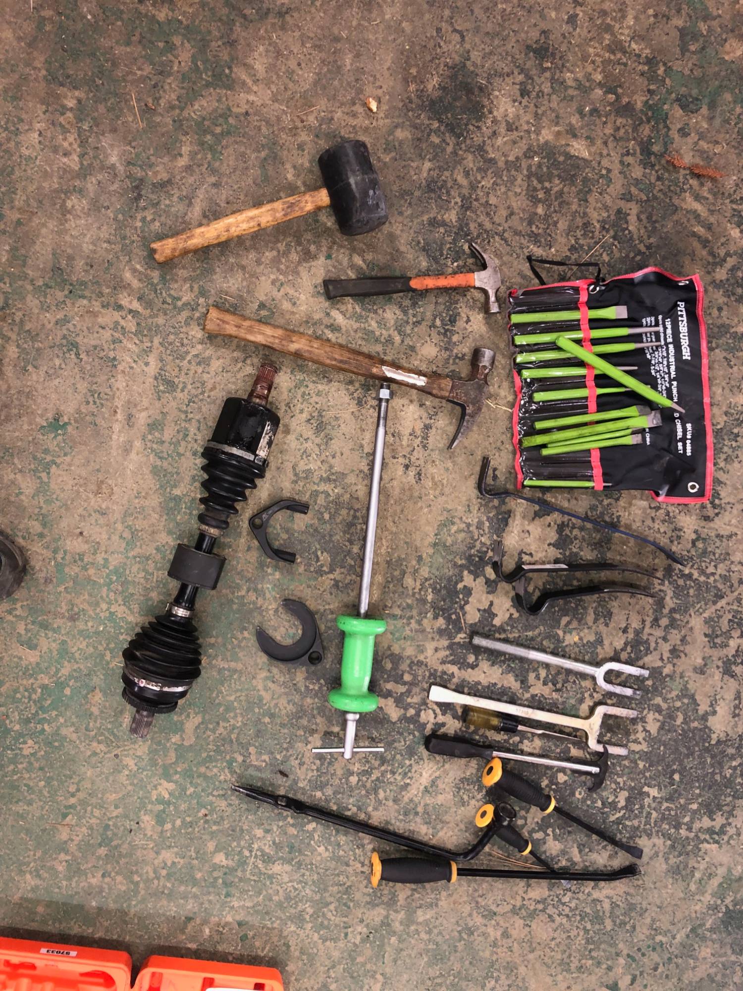

Success! I got a bunch of crow-bars and chisels at harbor freight, and I tried to use them for about an hour. I decided to give the axle popper another chance, and in my anger fueled swing the axle popped out! I don't know if using the chisels loosened it somehow, but I spend a long time trying to use the popper before with no luck. It also helps to raise your car as much as possible so you get a long swing.
Here are all the tools I used

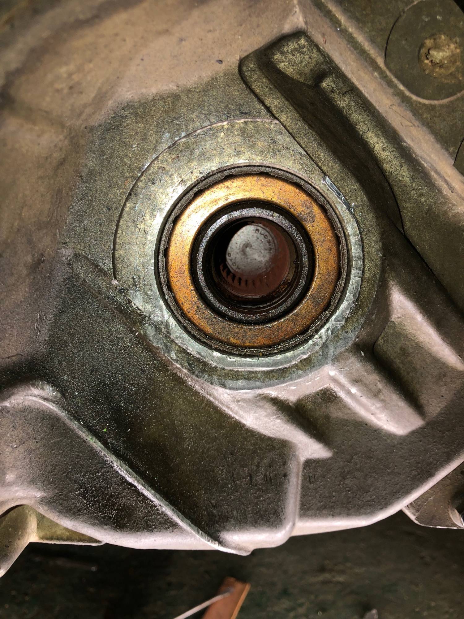

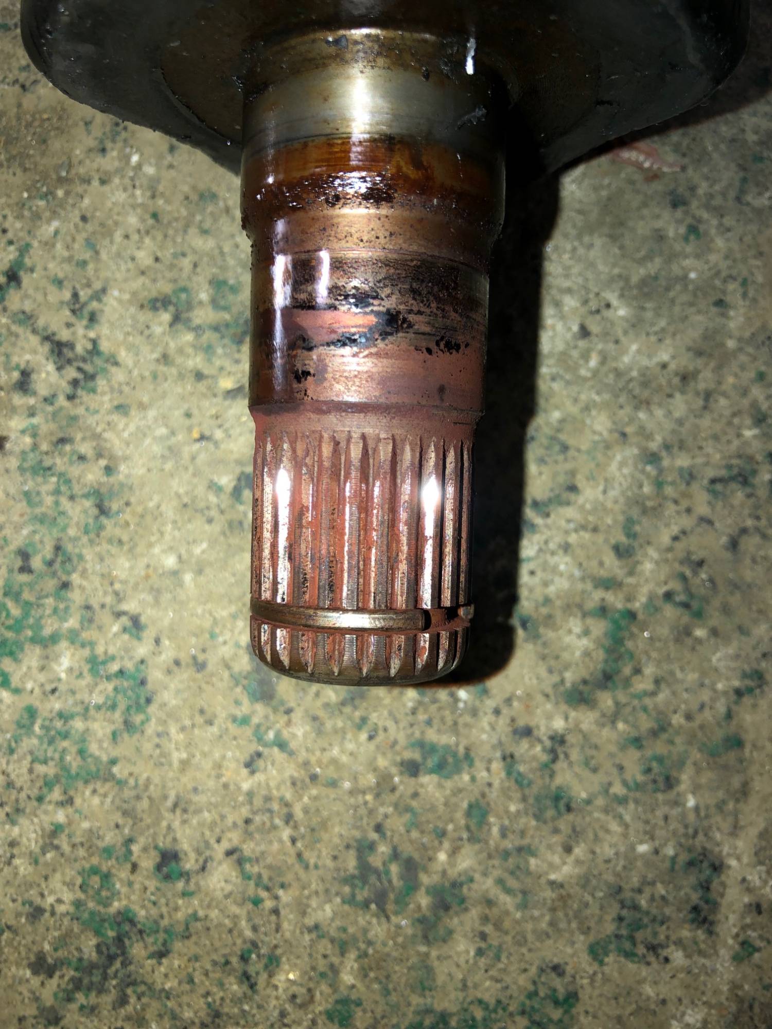

The axle didn't seem that rusty, however inside the transmission did. Can I put a bunch of grease on the new axle before I put it in? Also, what is the best way to clean all of the rust out of the transmission?

Good job! My first one went that way also. Don't worry too much about the rust in the axle bore and yes, put some grease on the new axle before installation to make it easy to get out if you have to. Additionally, keep your old parts, that driver's side is an original GKN and is likely still ok. Do clean up that seal and be careful not to damage it.
