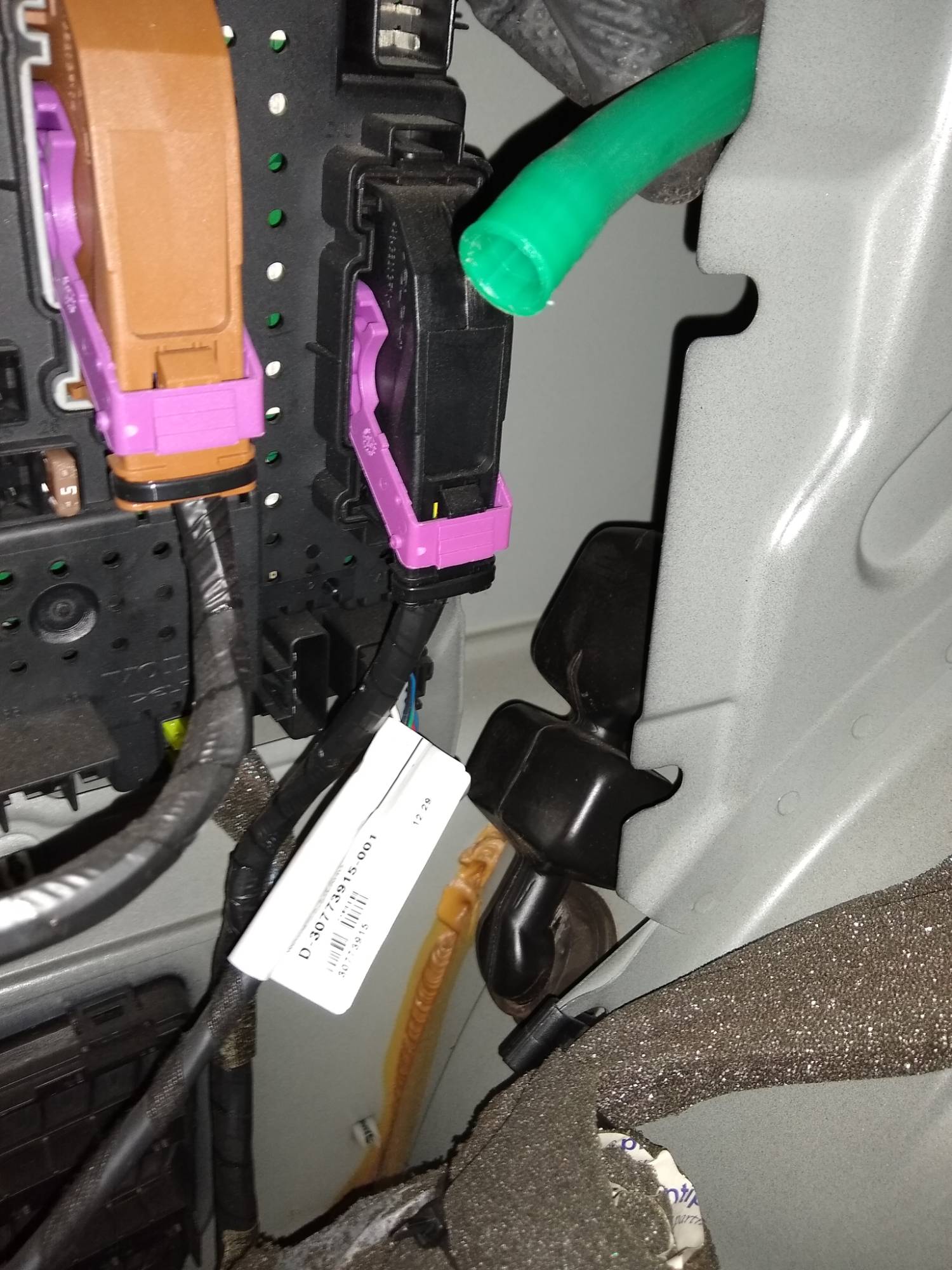

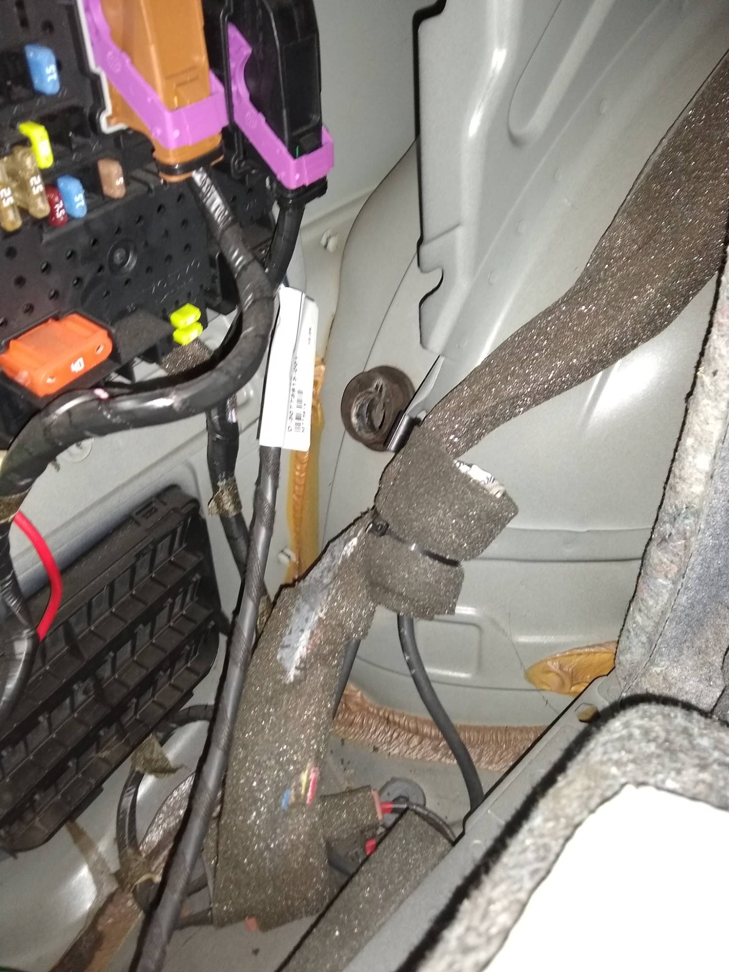

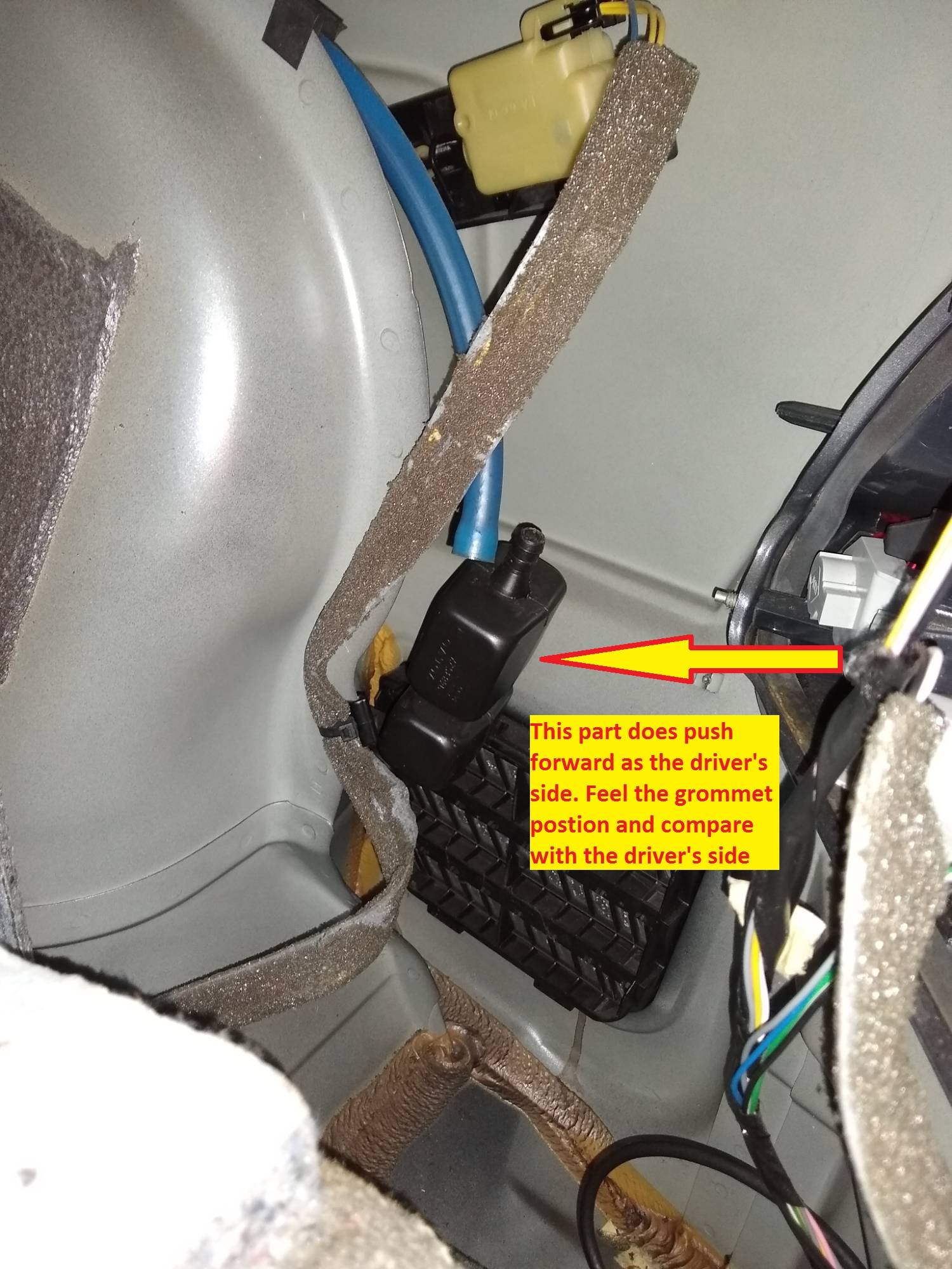

Found the rear sunroof drain lines. Was looking under the car while replacing the rear Toe Adjustment Panhard Rod. Couldn't see anything so decided to look elsewhere.
Used compressed air to clean every part and direction then tested. Had cleaned two fronts with a weed wacker line previously and the driver's side rear drained test okay at the time also. Used a large amount of water resulted in water overflowing the passenger side into the vehicle.
Everything tested fine today after the compressed air cleaning, Front carpets to return into the car and rear area will be reinstalled after a heavy rain, just in case. Driver's side drain is easier to get to whereas you can't see the large grommet on the passenger side.

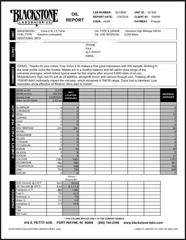

Got oil report back from Blackstone Labs. Overall great for an engine with 164k miles, first sample I’ve pulled on this car. Yet to do coils, fuel level would seem to indicate they may help fuel economy.
