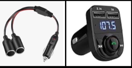

I have a 12V splitter and Bluetooth FM Modulator. Other socket of the splitter is open, will occasionally run a Uniden radar detector on that to increase time efficiency on some longer road-trips. Nothing on the rear seat socket.
I have removed the splitter when the power has went off, and other devices don’t work either. Little fuse in splitter looks good, so think it is ok. I also run the splitter as the FM modulator gets static running straight into the socket.
One other interesting symptom noticed last night. The led on the splitter has a faint bit of color when the power went off again—as if it was getting just a little power for the led, but not enough to power up devices. Like usual power came back on in about 2 minutes.
