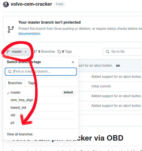

ricked wrote: 11 Feb 2024, 04:22 sorry to dig up this old post but i have indeed the p3 cem like in picture and scrip cant find the part number and stops
the question is what is "Teensy loaded with VTL's P3 branch. Do not use the Main branch" there is no P3 in the script or on github

ricked wrote: 11 Feb 2024, 07:21 thanks vtl but this script extracts pin code is 6 bites instead of 5, i did not try it yet but does it work you think, also i did edit the above post just before your reply
Use the p3 branch: https://raw.githubusercontent.com/vtl/v ... racker.ino

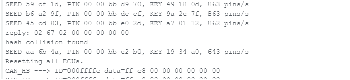

well i did try but after 2x 5 hours i get "hash collision found" both times
any suggestions?

ricked wrote: 12 Feb 2024, 15:55 well i did try but after 2x 5 hours i get "hash collision found" both times
any suggestions?
00 00 bb e2 b0 is your PIN code. If your software can't accept HEX numbers you can feed it any DEC pin generated by utils/seed-gen. To give you a few:

"00 00 bb e2 b0" is pincode after that sorry to say i have realy no clue what your talking about..
and indeed i need a 10 digit pin to give in the software
also feed to what, is there a other calc/ script to use to decrypt "00 00 bb e2 b0" ?
i did think that there was a real pincode like in the P1/P2 script not a HEX feedback that also needs to be decrypted
please point me in the right direction to decode this HEX "00 00 bb e2 b0"
thanks

P3 doesn't use a visible PIN code sent over CAN bus like the older ones.
First the controller sends a random seed number to you
Then your software uses a pin code and a calculation algorithm to calculate a key for that specific seed number.
Next your software sends that key back to the controller.
The controller will then do the same with its built in pin code and algorithm, and check that your key matches.
There are 65536 different pin codes that will give the correct key. The cracker is using the first one that starts with 00 00.
One of them is stored in your controller, but the cracker doesn't know which one, and it doesn't really matter.
If your software can send pin codes in HEX numbers, then you can used the pin found by the cracker.
But if your software require a pin code with only numbers 0-9, then you need to find a pin code with just numbers.
VTL points you to a tool that can take a matching pair of seed and key, and calculate different working pin codes with just numbers.
He has also already calculated 24 different working pin codes for you with that tool, based on your matching pair of seed and key.
