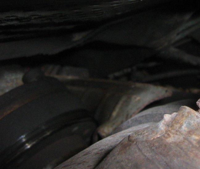

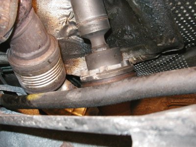

I had a problem with the front to rear driveshaft CV joint a few years ago on my 98 V70 AWD, and I always thought it was because of the heat from the exhaust too. I'm attaching a couple of pictures. Neither of them shows the heat shields very well, but it does show the grease thrown from the joint after the boot failed. I got a kit to replace the CV joint, and it has worked fine for more than 50K miles.

Thanks for the photos. It is hard to tell what is there on the exhaust pipe itself, but I assume there is something there as there are the mounting bolts on the pipe to attach it. The shield we fabricated follows the pipe around at a 90 degree bend. It just seems like it would have done the job. I winder if there could be an issue with the reman. drive shaft whether the cv and boots are inferior.

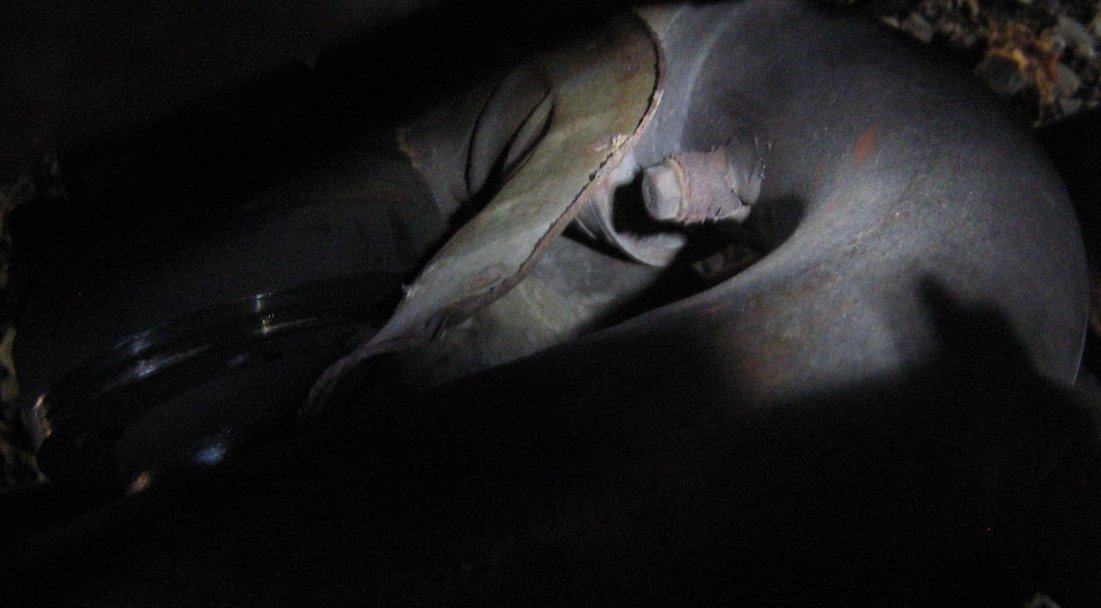

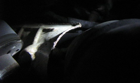

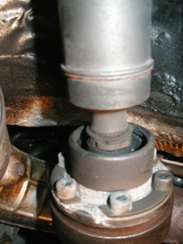

Here are a few more pictures from the top. Hard to get the camera in that area. I was surprised how close the shield is to the drive coming out o the angle gear. By the way, I think these shields are aluminum. Hope this helps.

Update- This morning I found that my exhaust heat shield is loose. The earlier pictures I posted were of a partially loose heat shield. The area around the two bolts that hold it on apparently corroded away.
