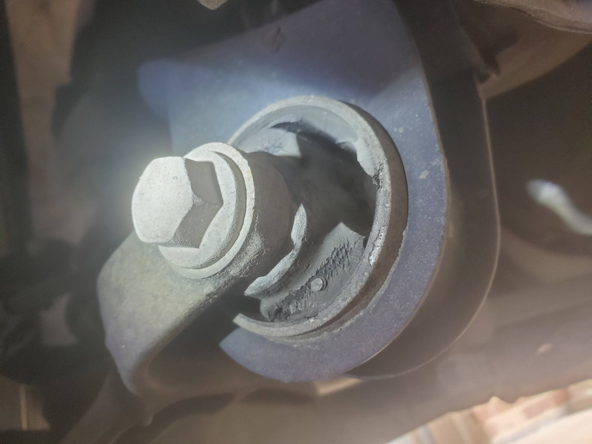

Ok, I just ordered some new trailing arm bushings. Those will get replaced first and then we will see how the ride changes.

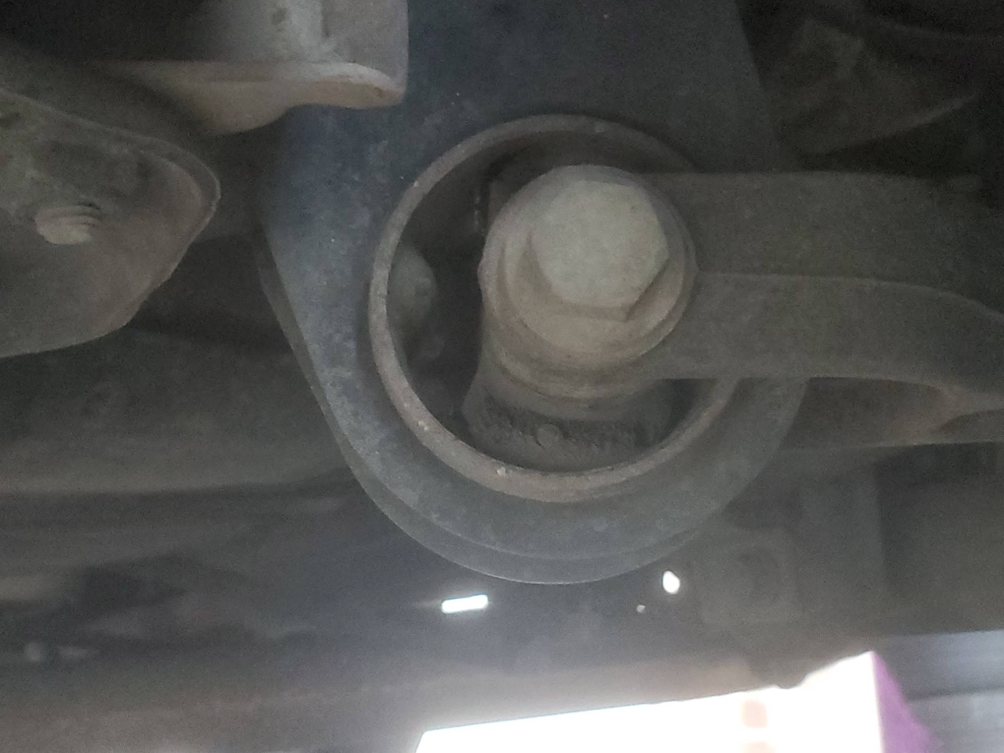

I do believe you guys are right about the trailing arm bushings. I just recieved the solid ones today. Will install sometime soon.

Nice pics. That looks worn out and tearing.
Just don't ignore the front control arm bushings. If you used Lemforder, they are known to have soft rubber nowadays. It's not just Volvo as car owners from all the German car companies are complaining too. People are also complaining about new Volvo rubber bushings. I have them on my rearward control arm bushings and they are already worn out, causing hard braking pull, intermittent wheel vibration, and a clunk going over some bumps. I'll replace those with poly.
You can change the front struts without changing the rear Nivomats. That's how I have mine using Bilstein B4 Touring struts. Works very well and I've installed them in a 2006 2.5t with 3rd row and Nivomats with great results. Helps reduce the front tuck and nose dive on turns so the rear doesn't raise up. Doesn't bring harshness as the ride is more controlled with compliance. Unlike worn-out struts which have more oscillations, more nose dive, more weight transfer rear to front, and harsher on bumps due to reduced damping.
