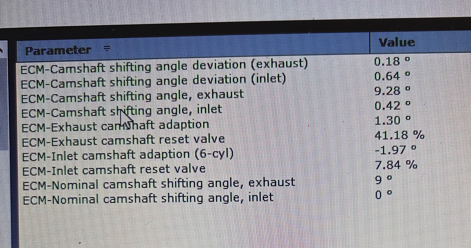

There’s no parameter called cam flank angle unless I’m not looking in the right place. Here is what I can read, this is at idle:

It's "camshaft adaptation". 0-4 is good, 4-8 - acceptable, 8 and more - possible interference. One tooth skipped is about 8 degrees.
