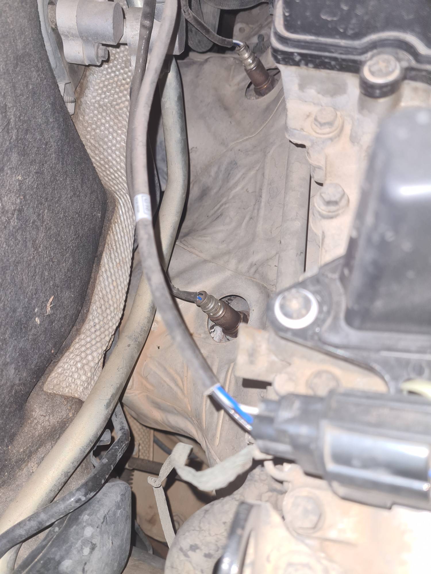

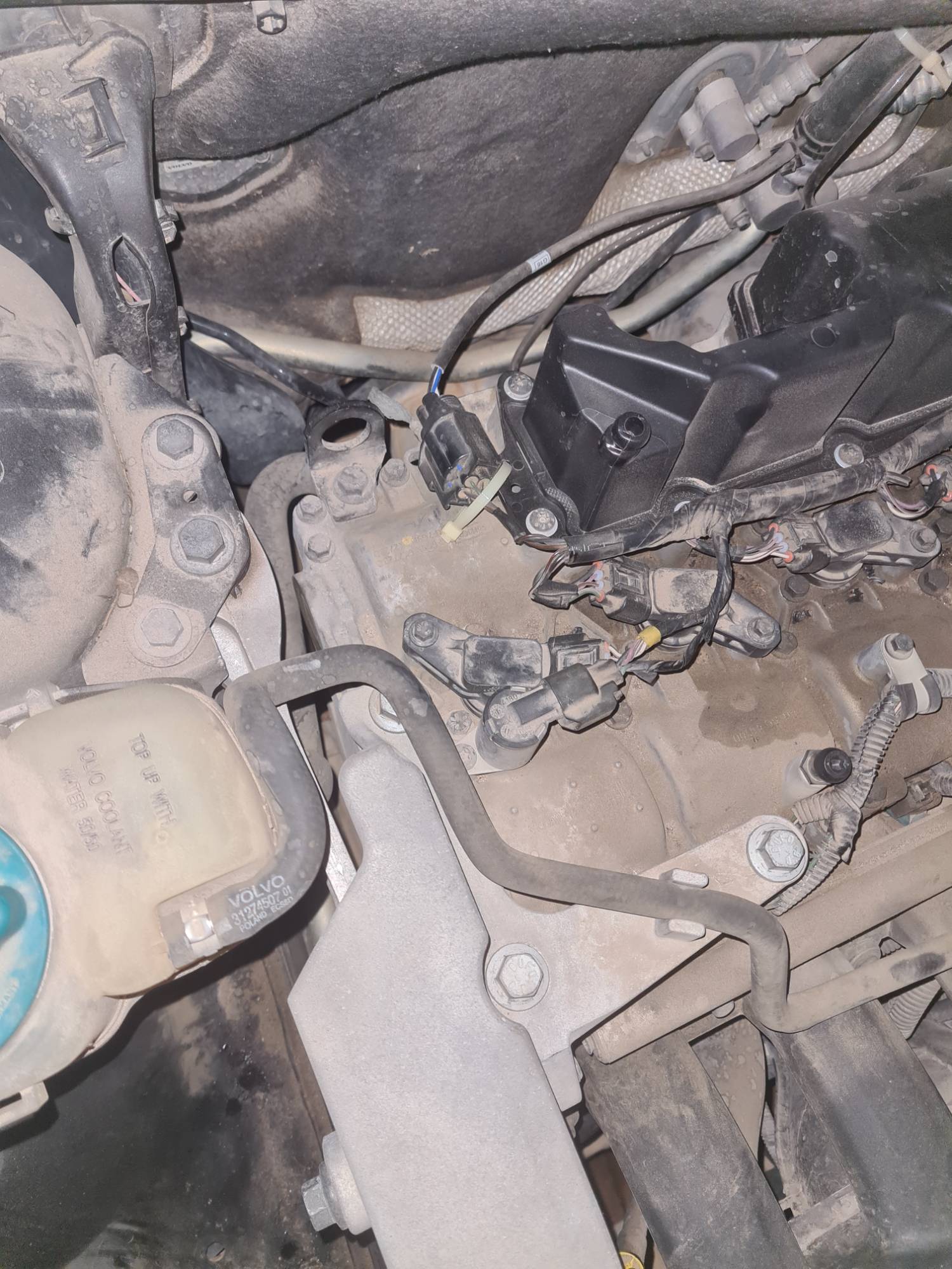

I smelled the oilchitownV wrote: 10 Apr 2024, 00:57 It’s your XC90 and you have to figure some things out yourself. Take pics of the New cats, down pipes, since these are where the O2 sensors are.
Taking pictures, simply smelling the oil, and sharing what you personally have done since a mechanic can tell you anything. These were requested months ago since you are personally there seeing, hearing, and smelling your XC90.
Also, list detailed parts changed, when, and other relevant work done. If the cats were changed, were the gaskets changed too? Don’t assume here. Or was an exhaust paste used, or did they reuse the old gaskets?.
If you have an oil leak, you want to take care of that before increasing the oil viscosity that would suit an older 5cyl better. I have a tuned turbo BMW with ~400hp & 425 ft/lbs and I get it about the oil. Still contemplating a larger turbo. Rotella T6 did change its oil formula since 2012. It has less zinc and is thinner IIRC. I’ve also helped/worked on numerous P2 & P3 2.5t engines.
I’ve directly helped over two dozen 3.2 owners sort through their P0420/P0430 codes. I don’t help everyone because it takes work on your part to communicate and get your hands dirty. Patience is required.
This is internet diagnosing and you have to do your own work. You have to verify, not assume, each part is good, verify the common high mileage maintenance parts are good and changed with trusted brands, and verify each “repair or fix” is correctly done.
The #1 cause of issues are related to lack of or poor maintenance. Poor maintenance includes repairs and fixes not being done correctly or using subpar parts that continue to cause issues.
I think it does have a little bit smell of fuel - like a little bit volatile. Maybe a little bit sweat.
About parts that were changed - i have no idea what was done before i owned it. After i bought the car - i wrote in opening.
I don't know if they replaced the gaskets while fixing the converters - my guess is that they didn't. I will try and ask tomorrow.

Now, take it slow before jumping into something else. You finally posted pictures. Evaluate, reassess, then verify.
The catalytic converters from the heat shield holes for the O2 sensors don’t look like they were changed. They appear dirty and there is some corrosion on one.
Re-read the things posted for you three times slowly. It was also mentioned about the serpentine, decoupler area, and downpipes. What if they replaced the downpipes/secondary catalytic converters? I was trying to help you on the other forum about getting to this. You should probably also post back to that forum since it has the history.
Take pictures closer to the decoupler area, closer to the serpentine, stick your phone under the drivers seat area and take pictures of the catalytic converters. Verify…..
Also, it looks like you are leaking oil from the PCV seal and leaking from the PCV diaphragm cap. These are issues. Maybe leaking oil from a sensor o-ring which isn’t an issue, just needs to be changed when you can.
If you are smelling something in the oil, then it’s an issue. Even if it’s smelling burnt at low miles/kilometers, you could be running both lean and rich.
Also, I see your engine is very dirty. Double check the air filter as that should be changed more often.
There’s so much more…..
