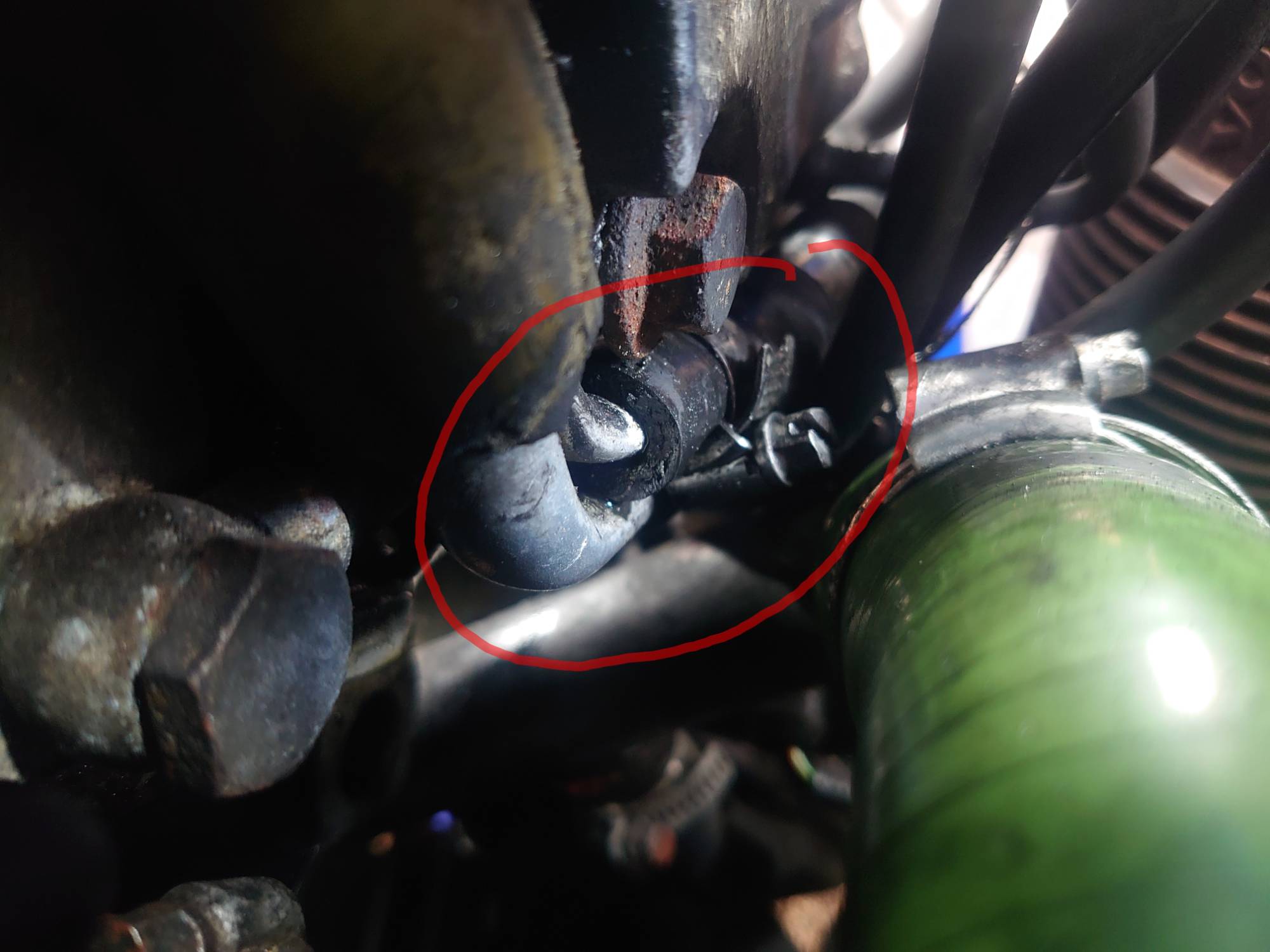

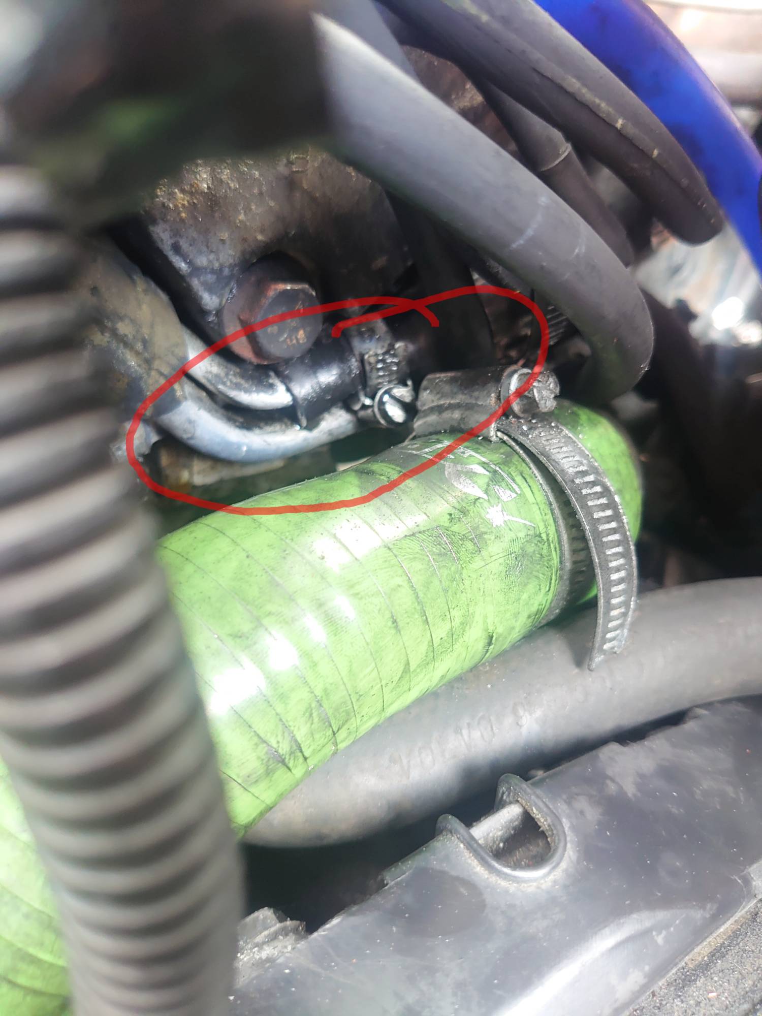

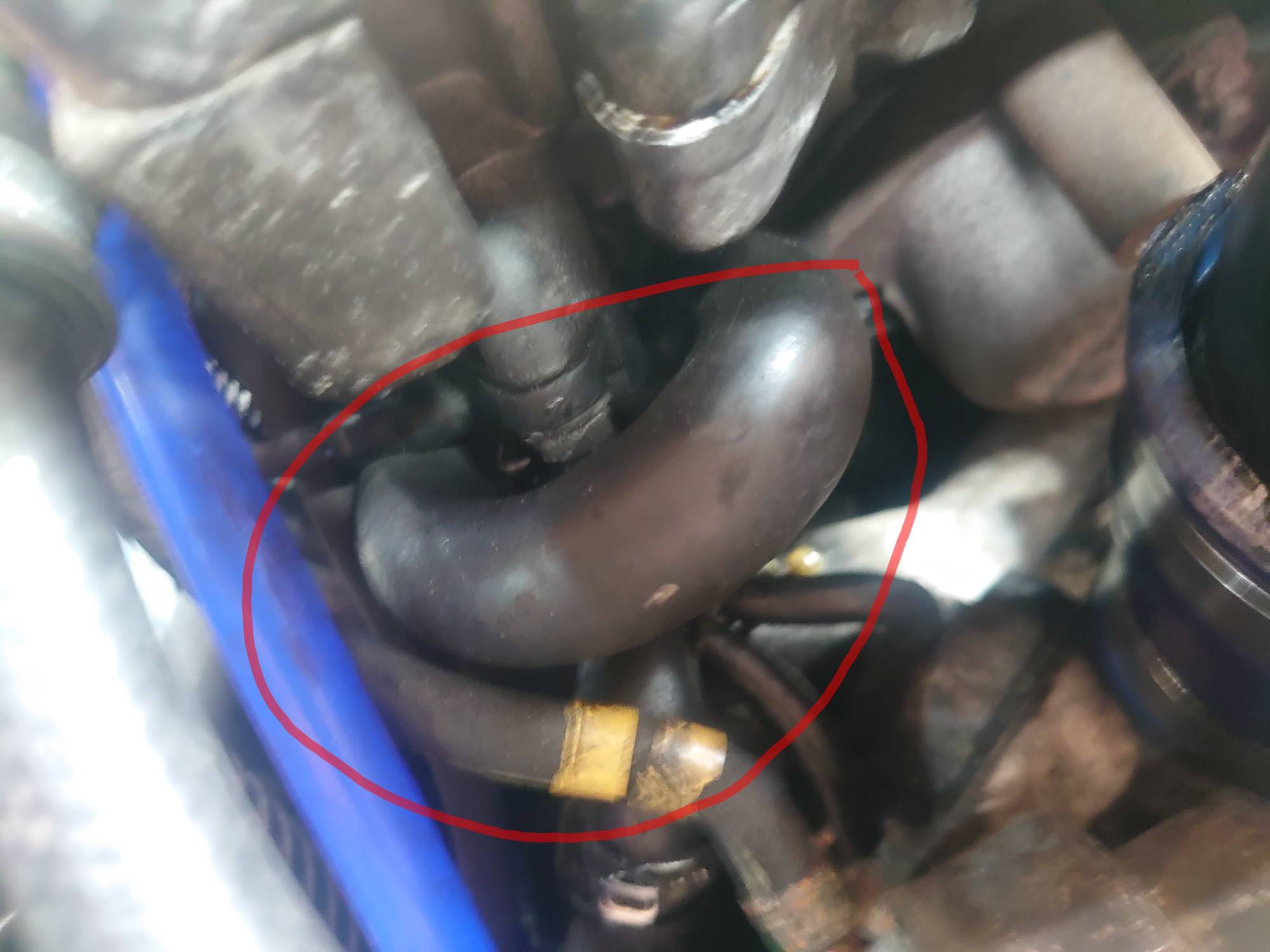

Hi guys I'm currently on another coolant hose replacement mission with my 99 C70 Coupe and have only two more hoses to complete the task.
My only issue is I can't find these two particular hoses anywhere on diagrams or in the forum. The main one that has split is a u shaped hose that connects to the back of the engine and connects to a hard metal line at the side of the engine.
I have attached a few photos, does anyone know the part numbers for the hoses

That’s part of the PCV system and someone has modified that , so you won’t be looking for exact replacement parts in- kind

Yeah, you'll either have to buy the whole pipe with the rubber hoses already attached or find a similarly shaped coolant hose. I had a leak there too. My local (chain) auto parts store allowed me to go into their behind-the-counter coolant hose inventory rack to find a hose with a similar bend. I found one and had to just trim it to size.
It's blowby

Thanks for your replies guys, I've had to buy the whole crankcase assembly which includes all the hard pipes and hoses. Might as well replace them all whilst I've got the time!
