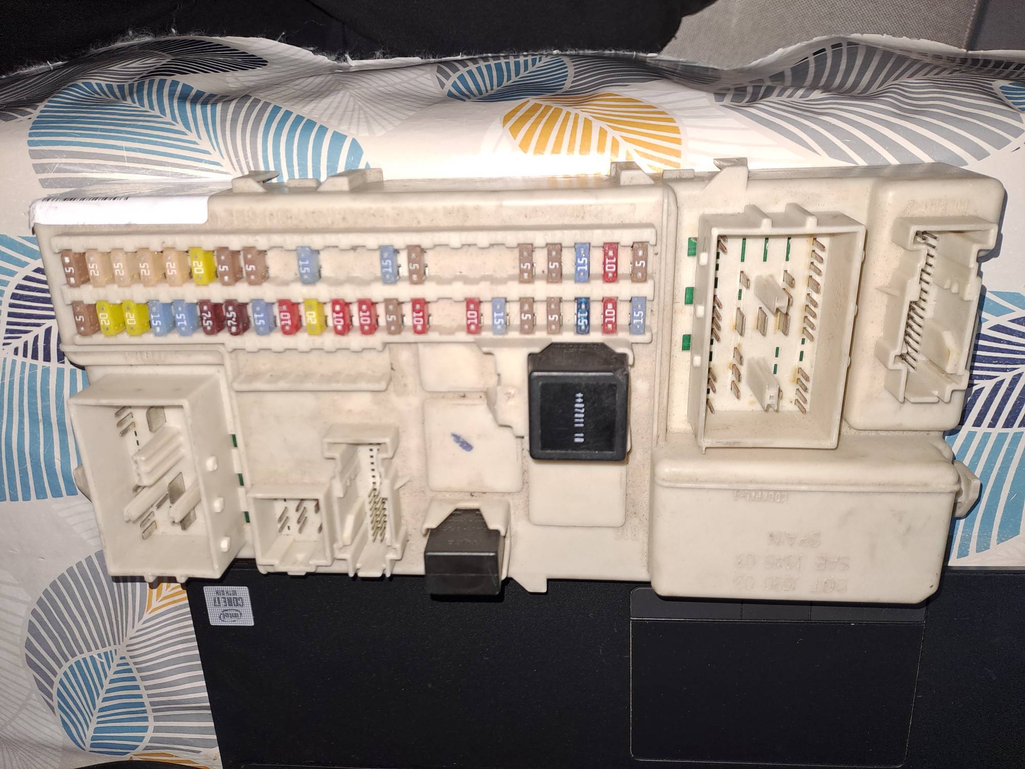

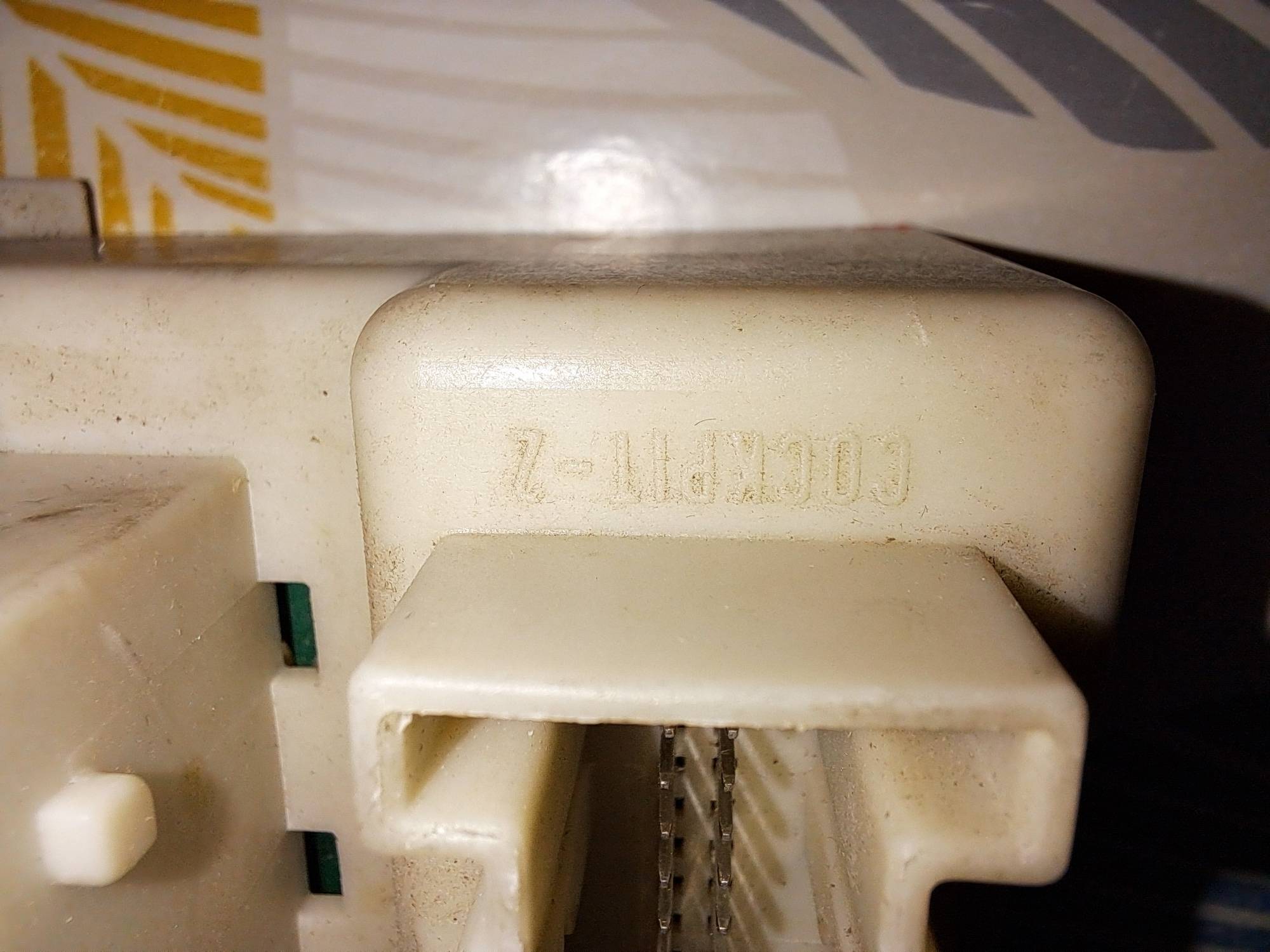

Sorry for the delay, I wasn't at home.oscilloscope wrote: 03 Jun 2024, 16:31I'm not sure I follow fully here so is that the green connector your referring too for cockpit-2? And its pin 17 for that connector?al1Volvo wrote: 03 Jun 2024, 16:03 On the reader :
Pin | Function | CEM connector | PIN
1 | GND | Any ground pin |
2 | LIN BUS | Cockpit-2 | 17
3 | POWER | Any Power In on the bench (Normally powered from the key barrel 6
Do you need also the pinout for the 7 Pin connector form the barrel ?
And Yes please the pinout for the barrel would be extremely handy.
Do you have the P1 CEM ? If yes, everything is written on the box (Connector name, Pin numbering).

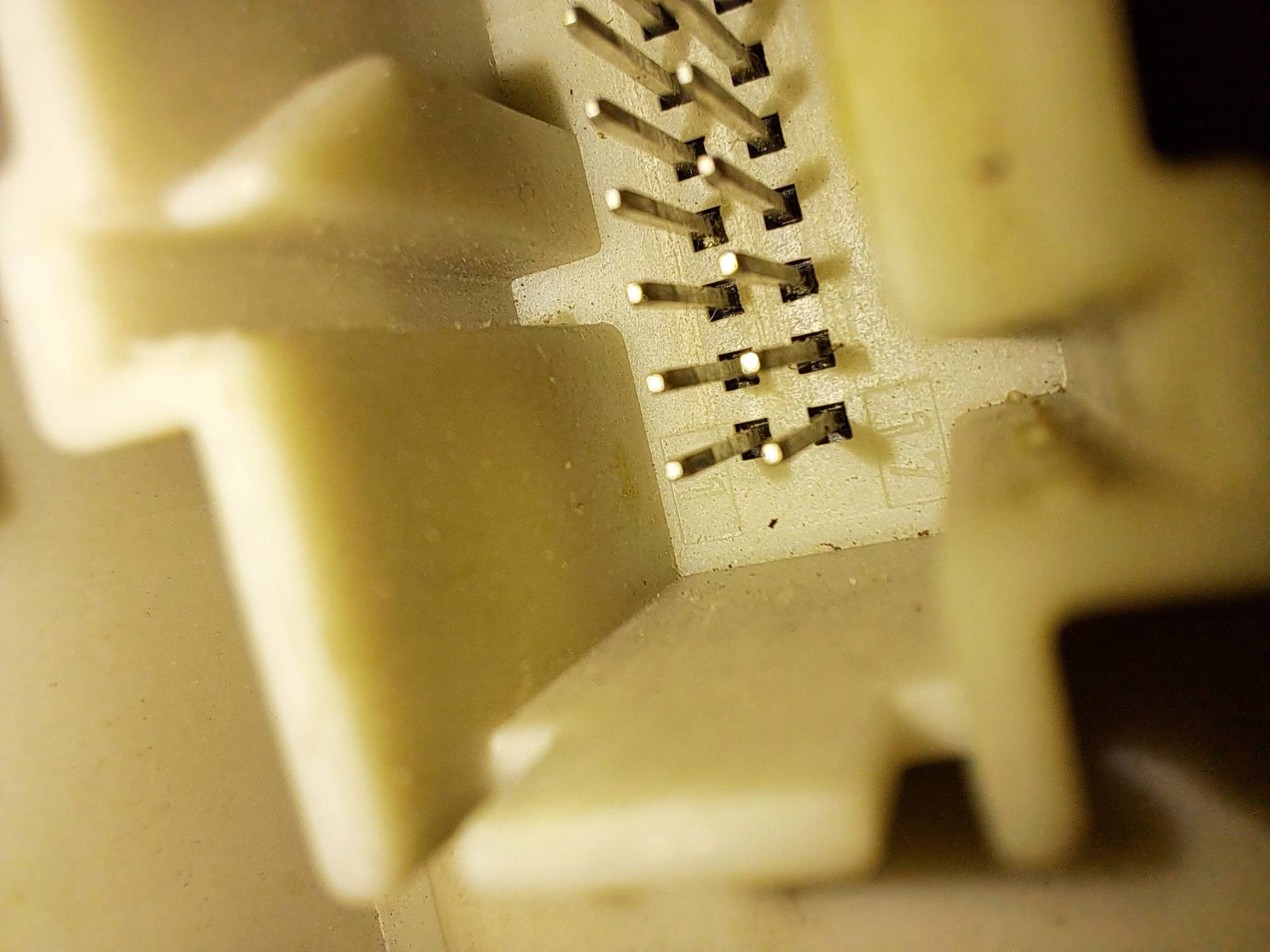

O my goodness, I have never noticed that the connectors have connector ID's I have 5 of these in my workshop currently !!al1Volvo wrote: 07 Jun 2024, 15:44Sorry for the delay, I wasn't at home.oscilloscope wrote: 03 Jun 2024, 16:31I'm not sure I follow fully here so is that the green connector your referring too for cockpit-2? And its pin 17 for that connector?al1Volvo wrote: 03 Jun 2024, 16:03 On the reader :

And a last point, if you are looking for the original connector, you can easily pick them up on crashed Ford Focus (CMAX, fiesta and so) who are sharing the same CEM but with some differences in connector pinout (internal board) and software, just rearrange the pinout on the connector and go.oscilloscope wrote: 09 Jun 2024, 02:40O my goodness, I have never noticed that the connectors have connector ID's I have 5 of these in my workshop currently !!al1Volvo wrote: 07 Jun 2024, 15:44Sorry for the delay, I wasn't at home.oscilloscope wrote: 03 Jun 2024, 16:31

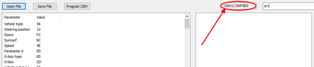

It's because the TCM has 7 different driving style programs.
If you already found the correct PIN for your CEM, you can simply copy/paste it in this field and push the Program CEM button.
- aa.png (24.56 KiB) Viewed 1412 times
