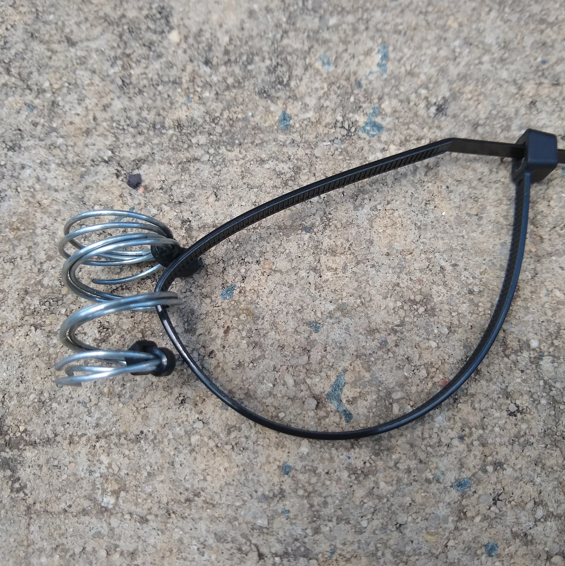

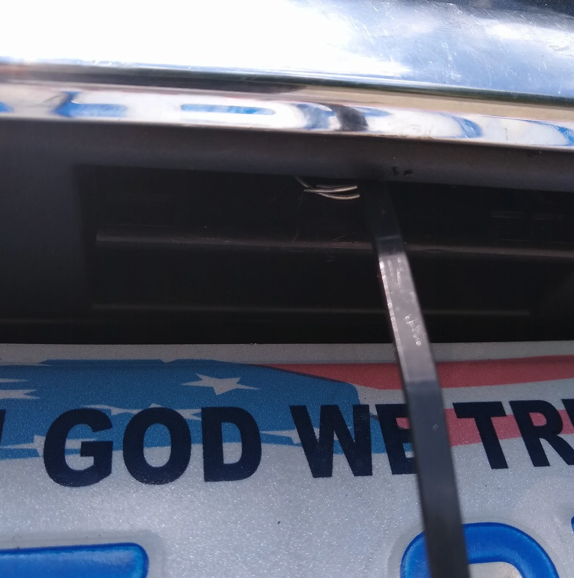

Depending on the condition of the rear hatch lever you either unstick it, repair it or replace it. I suppose this could apply to many rear hatch or trunk levers. Since this 2012 XC90 is on probation, meaning not sure if it's a keeper, things will need to be address in order to have the minimal functions before full Stage O.
One of these items is the rear hatch handle. When you pull to open, it stays in the forward position unless you use a screw driver to push it back. Not wanting to incur the time and cost to replace the handle here is what I did to make it function normally. Yours may require repair or complete replacement per FCP.
1) PBlaster'd and worked in the fluid. It helped the handle to return 4/5 of the way.
2) Using a small screw driver spread and pushed PTFE grease into the pivot points on the lever shaft.
3) Cut spring from Lowe's into 3 and zip tie together.
4) Insert spring with a zip tie pulling it back and secured to the lever spindle and trim zip tie.
Hillman 2-Pack 3-1/2-in Zinc Gate Spring

Mine was rusty and flaky but it returned on its own 4/5 of the way with just a spray of the PBlaster. May have been okay to leave it as such but thought it would be best to have it fully return in case it might bump loose.
I didn't want to disassemble it to clean, repair or replace either so came up with the return spring instead. With the zip tie around the spindle pulling the spring into the back it should hold for quite sometime. I was thinking of using that spring for the hood of the 2000 S70 but never got around to purchasing it. Do have an extra spring now in case I ever get to replacing the rear trailing arms of the S70.

2) There were 2 small zip ties to hold the 3 low tension coils together which was cut from the one long spring. (Photo)
3) Then as in the 3 pictures just 1 zip tie to loop to the pivoting pin. Not sure why you have to write it's 3 or 4 zip ties around the pivot pin? (Photo) I hope it's not to make it look like it requires that many because it's so dangerous?
4) Since the handle area is not wedged / beveled outward my experience says it's fine.
