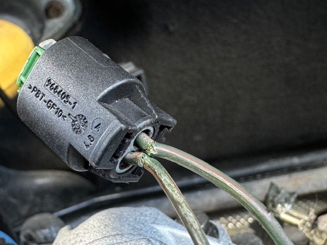

Same code, similar issue for my 2007 xc70.
Slightly rough idle and ECM-6140 after doing a timing and PCV job. Spent hours triple checking timing (and confirmed via cam adaption angle in vida), replaced both VVT Solenoids, only to discover an old cracked and corroded pigtail by the connector.

Volvo Dealership informed me they no longer sell their VVT solenoid wiring connector (exhaust 9441561/ intake 9441560) or wire repair kit (either 30656680 for 0.6-0.75 mm2 or 30656635 for 0-1mm2). You may be able to find a dead stock one somewhere.
Otherwise you’re going to have to scrapyard it. Note that there are a few variations of these connectors, make sure you take photos and match exactly.
Would suggest splicing in your new pigtail as far back (as far away from the hot engine block) as you can.
Check your wires!
