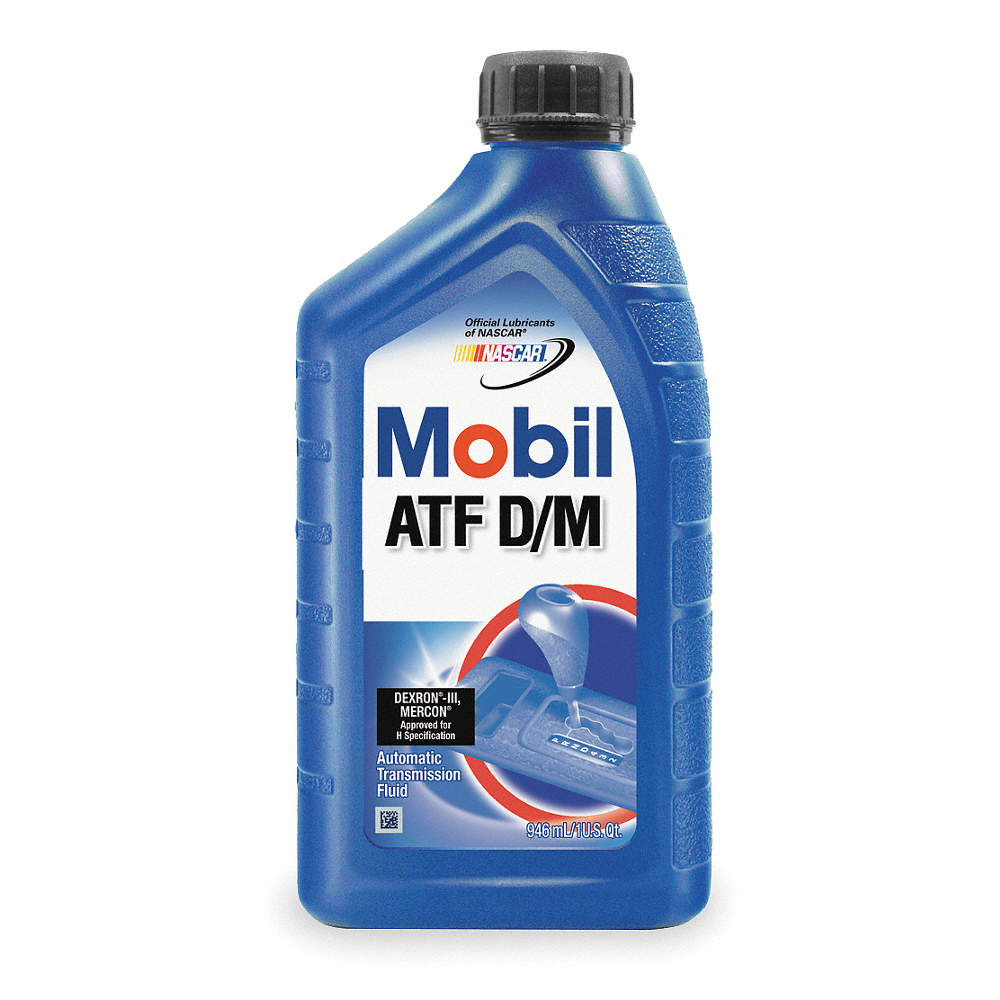

Post by Oro »
MoVolvos wrote: 10 Jul 2024, 22:42
There are no DEXIII fluids made and anything after the 2011 license ending period were unlicensed products. DEXIII can't be found so it can't be cheaper.
This is doublespeak nonsense.
Dex III products can be found from almost all reputable blenders. They have not paid for licensing as in the past, true. But that does NOT make them suddenly un-Dexron III. Because the fee is no longer collected does not turn them into something else. The specifications exist, and are met by each blender.
You can go out and buy this today. Do you think Mobil is lying when they state it is the Dexron III-H specification?

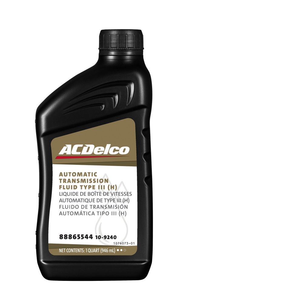

Lastly, this is GM’s DexIII product, which you can go buy at any GM dealer.

Oro wrote: 10 Jul 2024, 23:39
This is doublespeak nonsense. Nonsense is taking a portion out of context in order to call it nonsense. It make sense to everyone else as I was referring to the OE GM DEXIII which was in the Volvo manual but no longer available. Anyone reading the sentences before and after can make sense of the context.

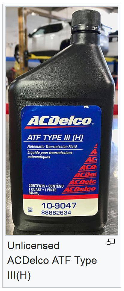

https://en.wikipedia.org/wiki/DEXRON
Dex III products can be found from almost all reputable blenders. They have not paid for licensing as in the past, true. But that does NOT make them suddenly un-Dexron III. Because the fee is no longer collected does not turn them into something else. The specifications exist, and are met by each blender. "Aftermarket fluids asserted by their manufacturers to meet DEXRON-III(H) and earlier standards continue to be sold under names such as DEX/Merc. These fluids are not regulated or endorsed by GM.[23]"
Unless you know the spec and blend asserted by the not regulated or endorsed D/M DEX/MERC per your Mobil pictured, it adds no value to the topic as again, I started the discussion with GM OE DEXIII. Any product with D/M DEX/Merc is unlicensed, unregulated and not endorsed by GM as the OE DEXIII, which again is no longer available.
You can go out and buy this today. Do you think Mobil is lying when they state it is the Dexron III-H specification? Yes, you can buy the not regulated nor endorsed by GM D/M DEX/ MERC. Do I think Volvo was lying when they spec's lifetime transfluid. Do I think VW was lying about their Emission Submission to the EPA. Do I think Boeing... Unnecessary tangent and adds no value in the context of the conversation.
Lastly, this is GM’s DexIII product, which you can go buy at any GM dealer. "ACDelco is an American automotive parts brand owned by General Motors (GM). Factory parts for vehicles manufactured by GM are consolidated under the ACDelco brand, which also offers aftermarket parts for non-GM vehicles."
AC Delco branded parts consist of aftermarket parts not only for other makes but also the unlicensed, unregulated and not endorsed by GM aftermarket AC Delco DEXIII(H)
https://en.wikipedia.org/wiki/ACDelco
ACDelco DEXIII(H).png (576.19 KiB) Viewed 169 times
Please contribute with info to clarify and not take the obvious out of context so others aren't confused or taken on pointless tangents of the subject in the post. Would appreciate your effort in not distorting what I'm posting and in doing so turning it into nonsense for yourself and potentially others. Thanks!

MoVolvos wrote: 11 Jul 2024, 10:55
GM never tested DEX III licensees. They just collected a license fee, and relied on blenders to meet it. Keep in mind, GM is not a petrochemical company - even their product was outsourced. THUS: there is NO difference in the system now than in the past, other than the fact a licensing fee is not paid to GM, and their TM “Dexron” used in labeling. “DexIII” is the same as it always was, and it’s on the market everywhere, and cheaply. Adding confusing semantic lexicological debates about a few letters in the label is not helpful to anyone and betrays an ignorance of the process and what’s actually in the bottle.
It is apparent you do not have any formal chemistry training or understanding of this issue: for reference the assertion only SWEPCO fluids make tribofilms. Utter nonsense: you read some whiz-bang marketing stuff, thoroughly misunderstood it, and the regurgitated it incorrectly. Your advice is consistently nonsense wrt chemistry and oil formulating. I’d refrain from giving bad advice.
